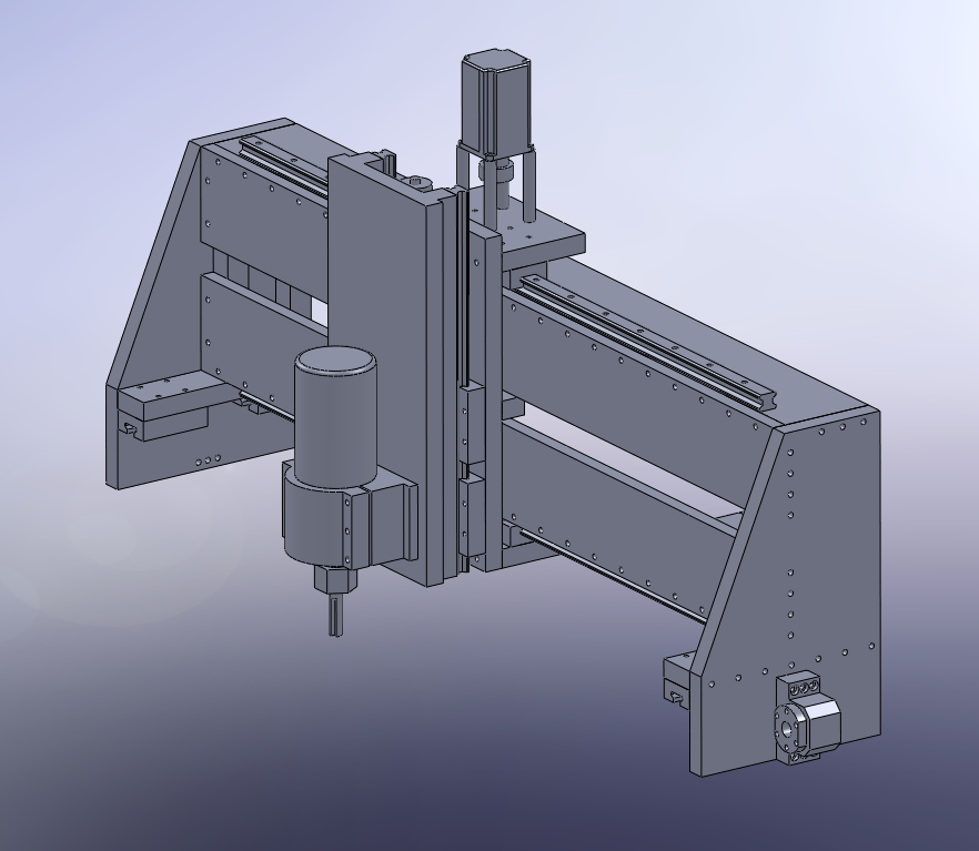

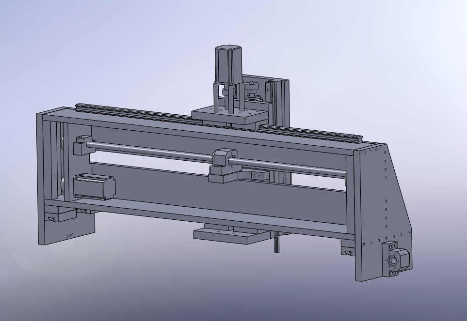

    Ok So after re drawing this gantry for what seems like forever to make it work the way I want I have nearly got it where I want it I think.
    As said before this machine is heavily influenced by the red machine Jazz put up, so its all aluminium plate bolted together using ecocast plate where needed running on 20mm profile rails.
ID:	7918   Click image for larger version.
