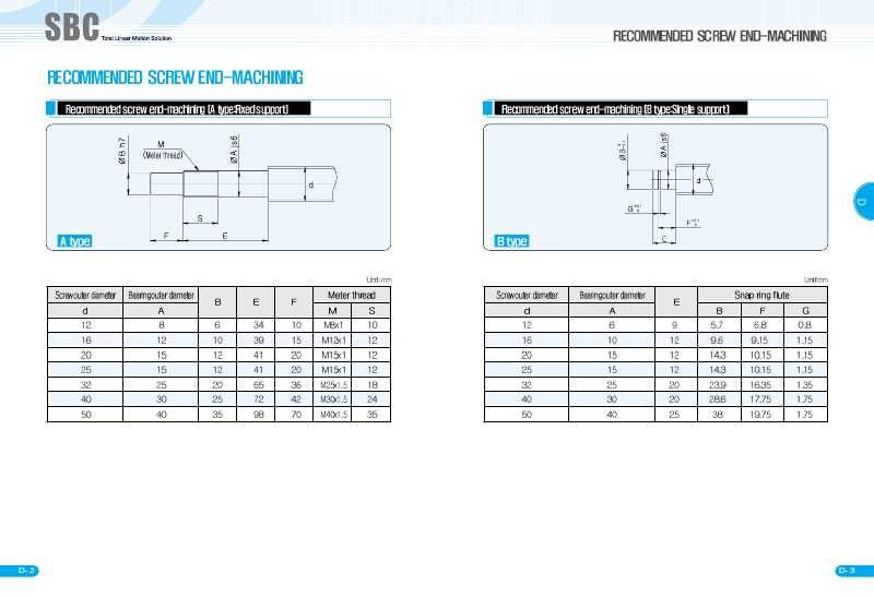

    Quick question Kingcreaky regarding the machining of the leadscrews I was considering doing the same think about having both ends machined but using the fk bearing supports the only problem I have is that I cannot work out from chais drawings when assembled does the leadscrew actually make contact with the face of the bearing within the housing or does it butt up against the seal outside? or is the seal wide enough to accomodate the machined portion of the screw through it ?
    I figure a drawing may help here to explain what I mean if I get a load of ?????? coming back :)

    Sounds like the very same question I spent best part of a day trying to work out, then Jonathon helped me :D
    this is what you are looking for (I think)
    So, for me I wanted both ends machined to fit the BK style block. I wanted 1500mm of actual screw. First off, I required type A machining at both ends and I also wanted to drive the screw via a pulley so required dimension F to be slightly longer. so I order 2 of these for the X
    ** (1603mm Total length) I need (1500mm) of screw, so 1500mm PLUS one end machined to type A (except dimension F to be 25mm instead of 15, and the other end machined again to type A, but without any F

    So am I right in thinking that where the screw ends and the machining begins is where it butts up against the bearing inside the housing?
    Or put simpler if I ordered 1200mm of screwthread (plus the machining) with the bk attached at both ends I would have 1200mm of screw between the faces of the bk blocks?
    I have just redesigned how I am mounting these as to start with I had fixed plates to hold the FK version bearings but was a little concerened that if I order this screw and find its even 3mm oversize length on the machining it wont fit so by going back to the bk style I have a bit more flexibility.
  10. #49
    right ignore the last bit I think I have figured it out, is there a small spacer that goes in the bearing block?
  11. #50
    Sorry, gonna have to pass on this question in the hope somebody else can reply. Until I get home and have a look atleast. I havent really inspected them. However, I think the bearing buts up against where the screw starts... no spacer.
