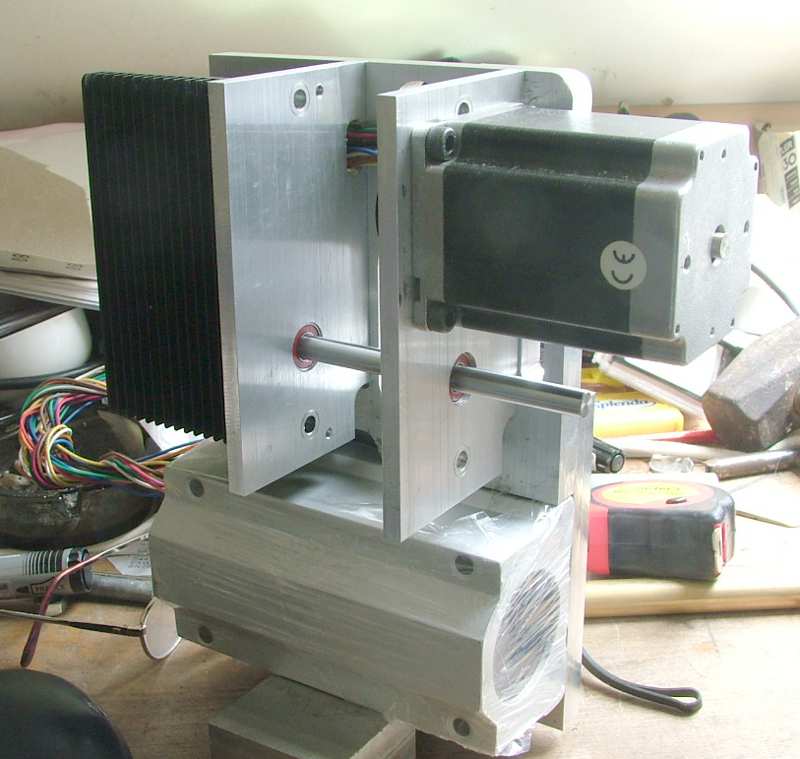

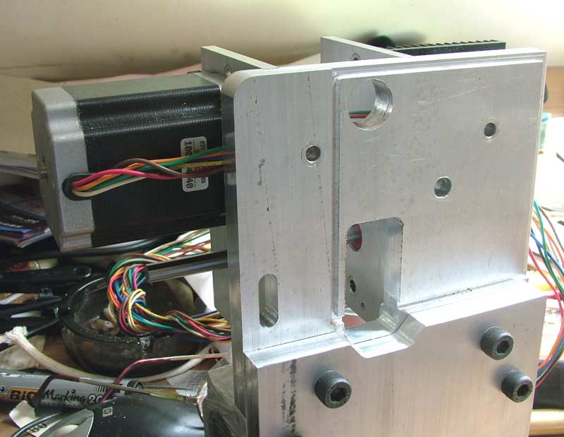

    This is the assembly that connects one end of the 4" box section X axis gantry to the 30mm linear rail Y axis. There is a 2mm deep cut out on the front that is a good fit on the box section.
    There is a plate welded half an inch up inside the box section with a big iron nut in the middle so I can pull the box section firmly into the groove on this plate and hold everything nice and square with one M8 bolt.
    This assembly drives the 15mm tooth belt for the X. To be clever I put the top of the belt inside the box section and the bottom about 1.5mm below it.
    Have I made a plasma dust conveyor belt that will pump crut in to the box section?

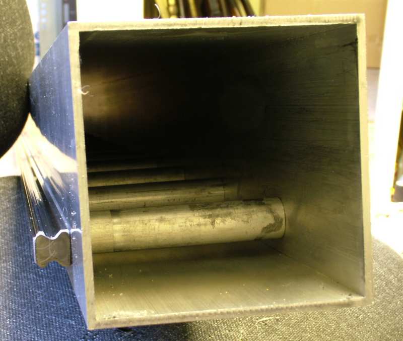

    Bolting the HiWin rail from behind on to box section meant running spacers inside. I used 3/4" aluminium bar
    I suggest we make a tool to place them, my son thinks he can push them into position using the file with a 1.5m handle we used to deburr the hole internals. The 23 bolts only took him a couple of hours, I cut the spacers for a good fit, after about an hour of hammering and cussing I remembered I had some copper-slip
    Thought I'd get a pic before he welds in the end plates and the spacers are never seen again.
    The rail mounting holes are drilled oversize so I can put the rail level even if the box section sags a bit.

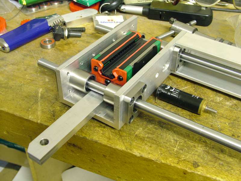

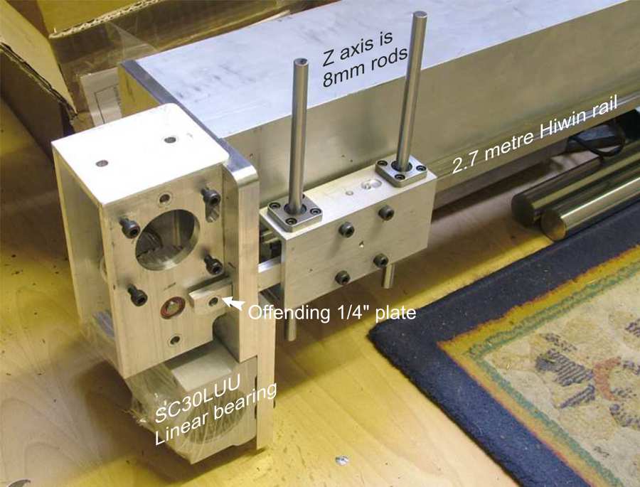

    Here's the bit I made today.
    I have to keep the cutter holder light because it's a dead weight that needs accelerating. I got it down to one piece of aluminium channel, the Hiwin bearing is the X axis, the 8mm linear bushings are the Z. The sticky out arm flips a roller microswitch so I have time to brake before the head slams into it's home stop. A sort of early warning device.
    A little Maxon rare earth motor with an epicyclic box raises and lowers the head (God bless ebay) with optical stops to set the cut and pierce heights.
    Bill, I think the key to long gantry plasma is to make everything adjustable so you can pull it straight and level when it's all together. I let you know if that is a good idea or a crap idea later
