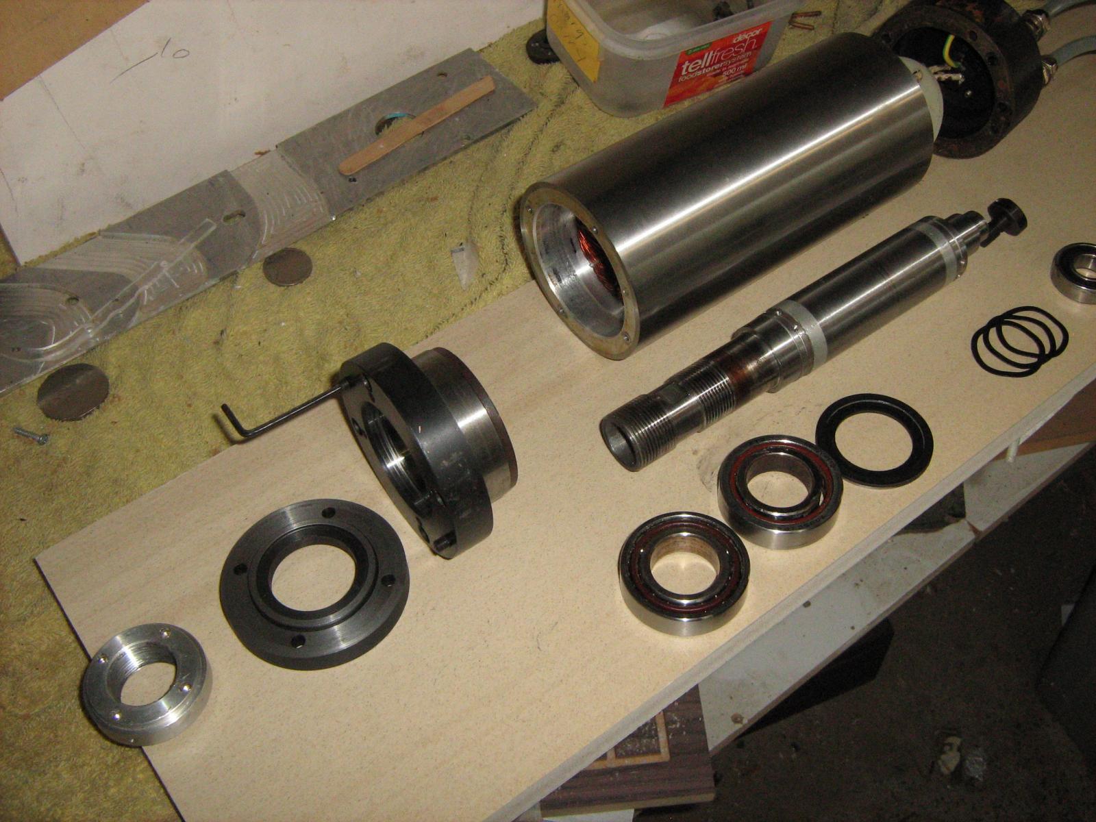

    Hi All Sorry ive not been around for so long work commitments hav had me by the throat!!!, anyhow ive seen a couple of these chinese spindles in action and for the most part im impressed, so when i got the chance to see one in bits i jumped at it. This made me ask if it was possible to drill through the spindle itself to fit a drawbar, any thoughts?? the 3hp er20 one looks like it would be worth doing. they may even be hollow in the first place, i didnt get a close enough look...

    some of the ER spindle shafts iv bought come with a through hole already present... its hit and miss though when you buy as iv had blind and through hole ER shafts from the same supplier :(

  3. Here is a link I found some time ago where someone took apart one of the 1.5KW Chinese Spindles: http://3d.kadatka.ru/articles/shpindel/index_eng.php
    I've got a dead 2.2KW spindle which I striped and the shafts not hollow but wouldn't imgine it being too difficult to bore.?

    For what it is worth I think that drilling a hole down the centre may be a very bad idea. Think about it, the Chinese are very good at making things down to a price so their design is not going to be conservative, that's for sure. Therefore, the diameter of the shaft will have been minimised in diameter and material specification to do the job and no more. Removing some of this material will weaken the structure I am sure.

    Drilling the hole all depends on how the shaft is hardened. If you're lucky only the surface will be hardened (like with ballscrews which are induction hardened), so you could drill it with a standard drill. However the spindle is what, 200mm long(?) which is a rather deep hole to drill in any material. It's important to maintain concentricity otherwise the spindle will no longer be balanced. If you need to keep the 24,000rpm limit you may well need to rebalance the spindle after drilling - it's possible to do dynamic balancing at home and not too expensive to set up, but that's a big project in itself especially just for one item although I guess you should additionally balance the toolholders.
    Drilling the shaft will weaken it and also lower the critical speed - but no point commenting on if that's an issue until we know the dimensions. What diameter drawbar will be required for instance? Will need to know the required force to hold the toolholder/collet to work that out, so need to know what toolholders (custom or otherwise) you'll be making first.... there's a lot to work out. Ideally you want to use the existing ER20 taper for the toolholders/collets so need to machine something to fit that and attach to the drawbar - again easier said than done.

    The shaft is very strong on the 2.2KW spindle and would easily bore without weakening too much. Obviously it will but to be honest these spindles don't produce enough torque to get anywhere near being able to snap a shaft of this diameter.
    I don't think it would be too hard to design some way to draw the ER collet but it would have to be a single large collet permantly installed.
