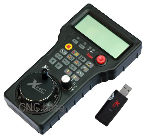

    Unrelated i Know but look at what ive got... another toy (this was the picture from the auction) Click image for larger version.

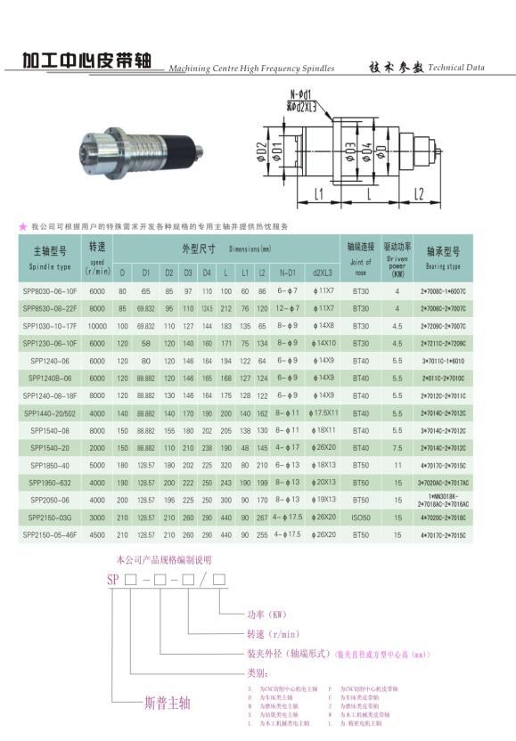

    Ok Just had an update and i think we are getting a little closer...
    " Hi Rick Pls check the attached, my quotation as below,
    SPP1030-10-17F: FOB Dongguan US$1,142.00 in each.
    Its max revolution is 10,000rpm, but if you insist 12,000rpm, price will be US$1,586.00, as we need to adopt Germany ceramics bearings, its cost is much higher than our standard bearings (NSK brand, made in Japan)
    Any question, pls let me know.
    Regards Sam
    Ive Now asked for shipping and unit discount for 5..
    so fingers crossed ...
