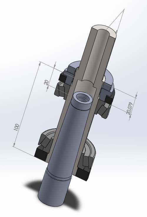

    The shaft is very strong on the 2.2KW spindle and would easily bore without weakening too much. Obviously it will but to be honest these spindles don't produce enough torque to get anywhere near being able to snap a shaft of this diameter.
    I don't think it would be too hard to design some way to draw the ER collet but it would have to be a single large collet permantly installed.
    Then separate tool holders machined to actually hold the cutting tools. Similiar to the Tormach system.

    Problem with this approach, with this spindle, is both the relatively small diameter of the largest ER20 collet @ 13mm and the fact they will need to be balanced to handle the high spindle speeds..
    ahh yes my 260 only managed 3500rpm
    The tormach system works by using the largest R8 collet @20mm and the tool holders shank match's . . BUT . . the main difference and the area I think will be hardest to over come is the balancing. Also because of the relatively small 13mm shank the tool holders will also need to be machined from high quality steel and hardened appropriatly.

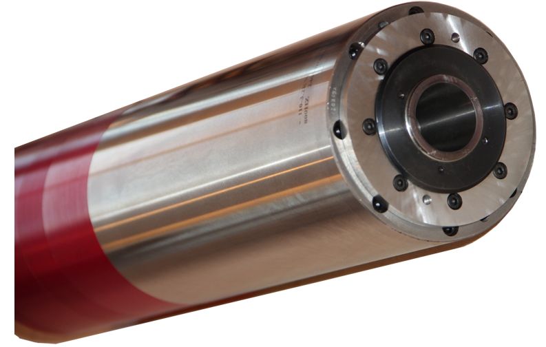

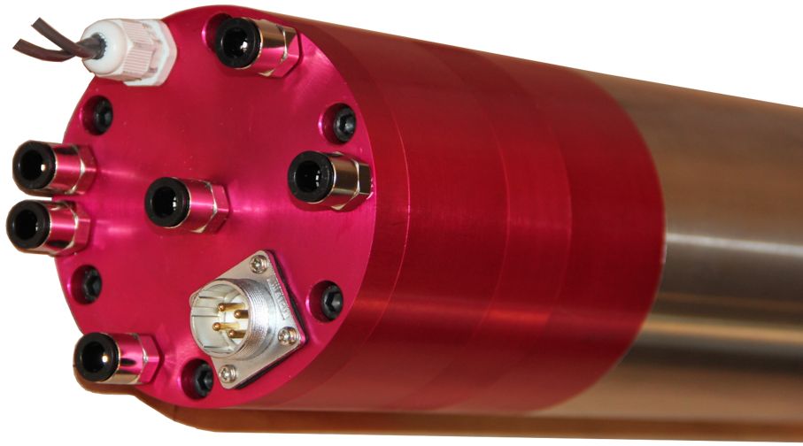

    I think they have....
Name:	air mech fitted 2.jpg
Name:	air mech fitted.jpg
    Yes I know they make them but don't think they will be cheap and that was my point.!! They will be 2K plus I think.?

    What size machine is this going on.?
    I have thought for a long time that the BT30 spindle Cartridge that tormach sell as an accessory could easily be made into good ATC.? Again not overly cheap but doo-able.!! Though needs a large strong machine.!
    I'm going to enquire with a company I deal with who make,repair, high quality spindles. The stupidly expensive multi KW spindles with ceramic bearings alone costing 1000's but I did wounce mention could they make a cheap ATC cartridge and they said possibly and draw something up and they'd have a look.? . . Never did maybe when I have more time i'll look into it more.?
