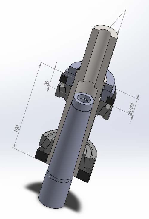

  9. Quote Originally Posted by John S View Post
    Build one.
    Absolutely
    There is one which I build. It takes MT3 ER20 collet chuck or anything with MT3. It's not final design, but gives idea how it will looks like. There will be MT3-like taper on the top to install set of reduction pulleys. I rather needs to go down with the speed than up so taper roller bearing will be perfect for this.
    So far hollow shaft including M30/1 thread for preload nu,t internal and external MT3 tapers is turned. I'll try to make some pic of it.
