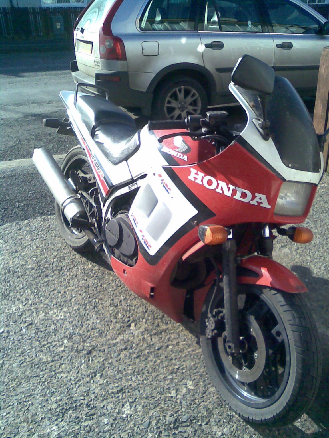

    wow you truly have had such an interesting career. the reason i asked about the vf500's is because i have one. 84 500f2e the earliest year if my memory serves me correct, 36k miles and no infamous chocolate cam syndrome (no service history) love the bike but its an absolute pox to work on

    Yep they were right camels to work on.!! . . To be honest the first early bikes had big problems they where snapping cranks but this was quickly sorted and changed so only a few hundred (In UK) I believe had the trouble and those engines were changed for the updated engine. But they still had issue's with snapping rocker arms and wearing cam lobes away but this was largely caused by user error and not letting the engine warm up enough before wringing it's neck.!! . . . . Thou to be honest it's such a nice fun bike it made you want to wring it's neck. . Lol
    Edit: Eh eh funny how things come back to you when you sit and think back.!!
    The reason they were eating the cams was that the gearbox and topend shared the same oil thru pressurised oil ways but what was happening was the oil was draining back out the galleys and oil pools when stood back into bottom end. So when starting there wasn't enough initial pressure to push the oil up to the cams before damage was done.!
    Also the cams where much more finiky about clean oil than the gearbox so after a few 1000 miles contamination was creating pickup on the journals.!! . . . . So change the oil often and spin engine over a couple of times before starting to pressurerise oil system.
