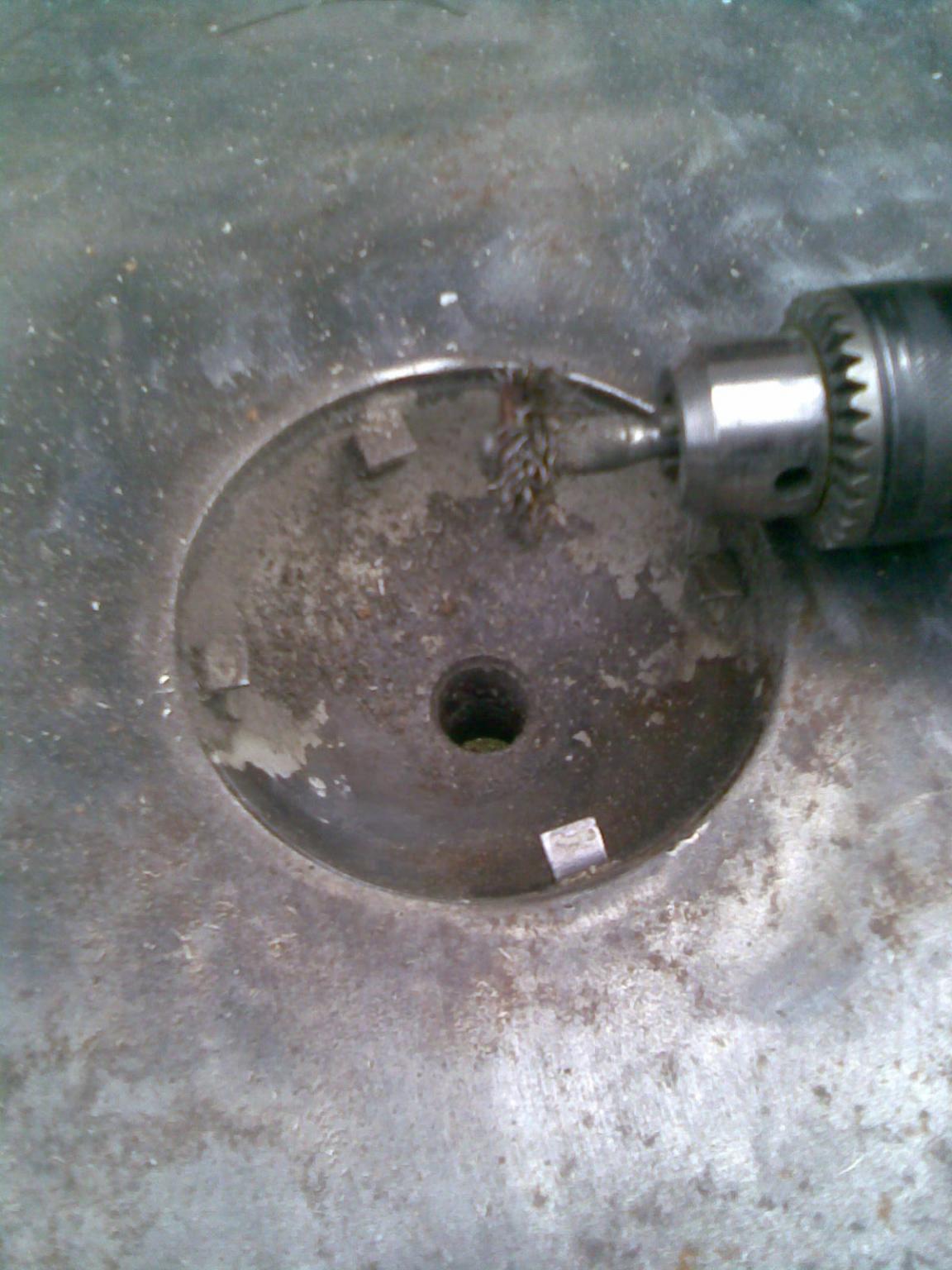

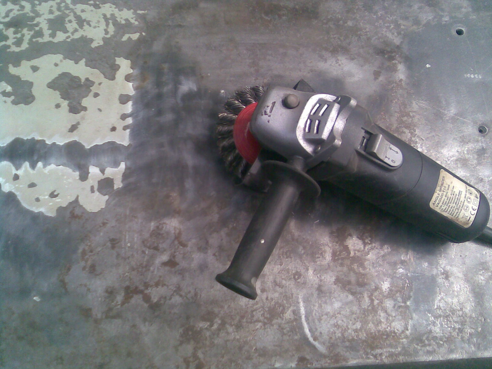

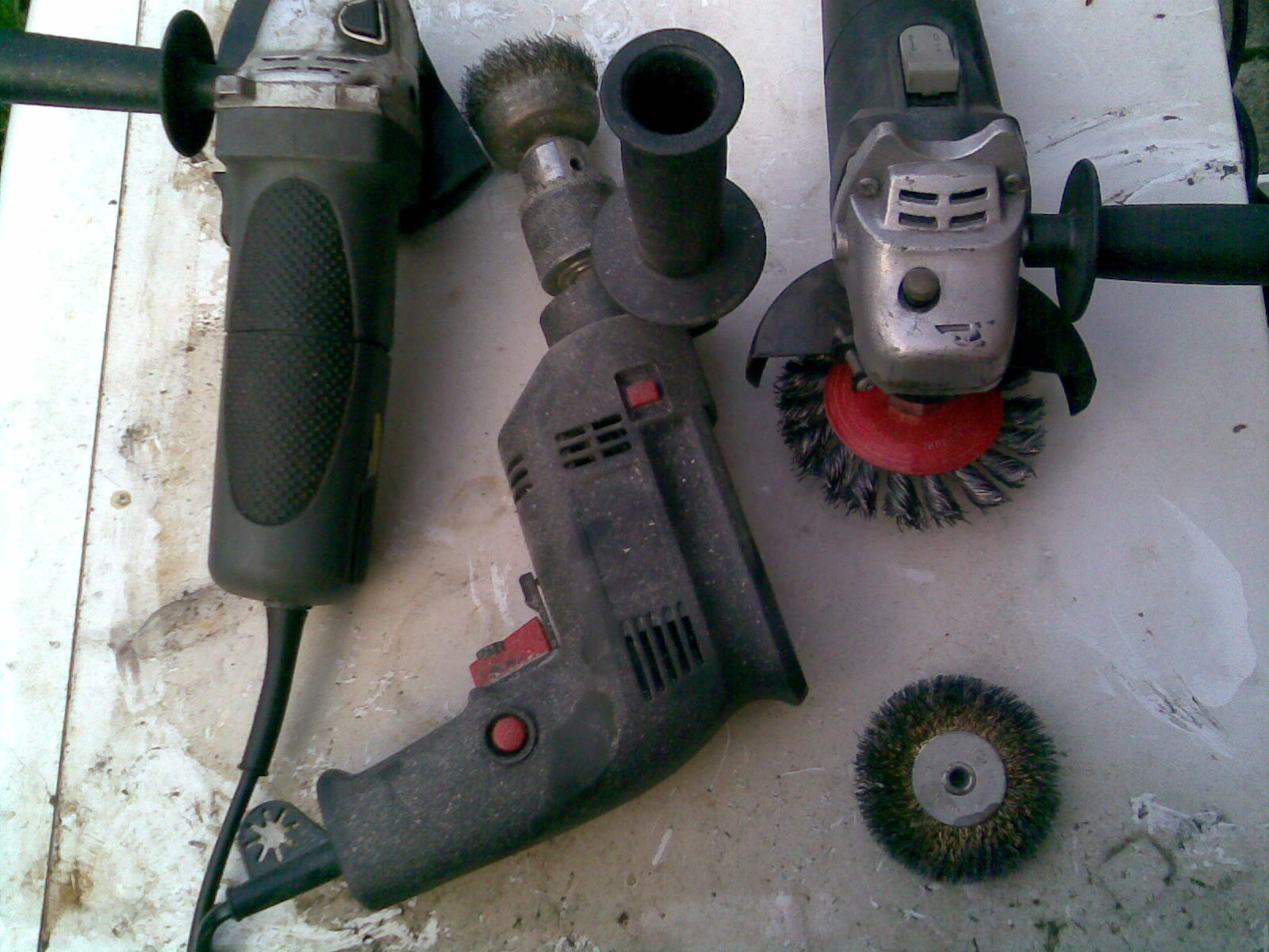

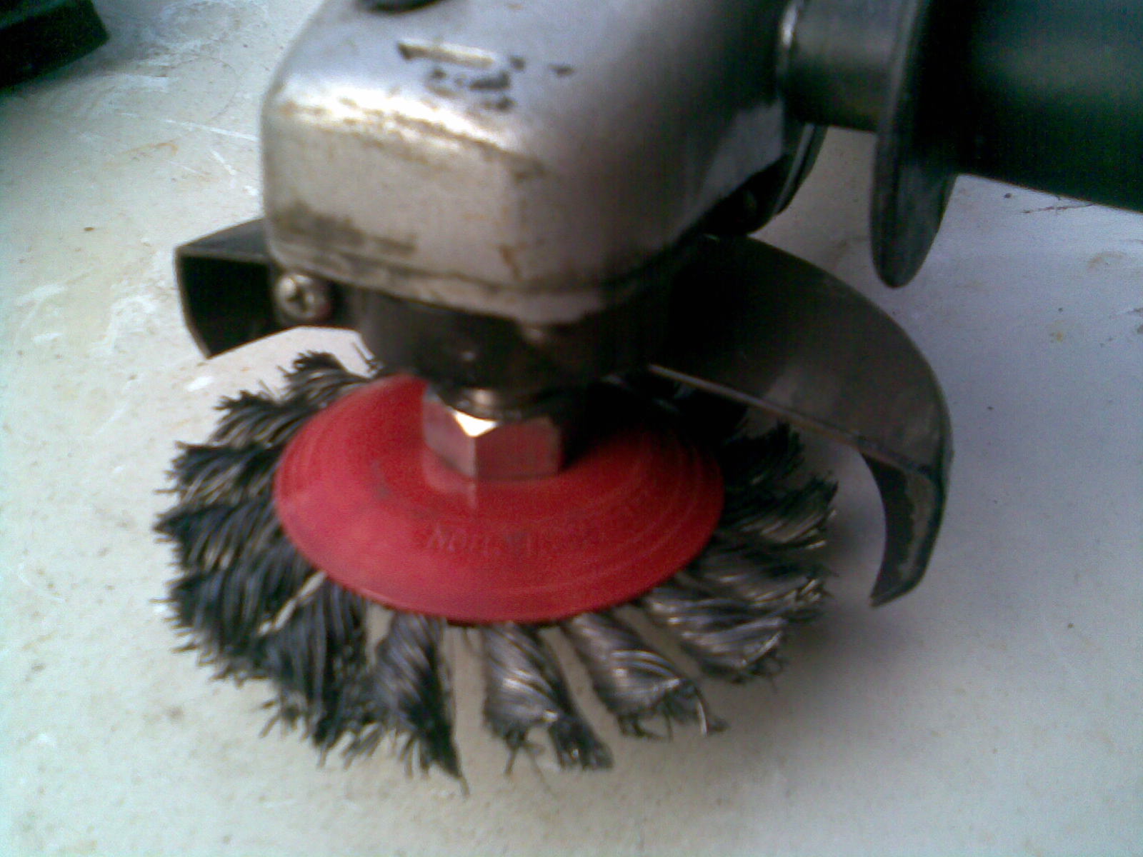

    i dedicate two cheap 115mm grinders to the unforgiving job of paint removal and with the addition of one 'weapon' of a wire wheel i have one formidable setup.
    the reason for using 2 grinders is simple, they have a tendency to overheat so i swap them over every once in a while.
    the drill is used for getting into tight spots but it doesn't have the umph to compete with the grinder

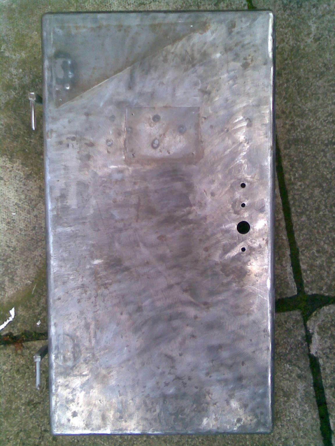

    today i started to attack the cabinet

    you can see the effect of the grinder on the top of the cabinet, like a knife through butter
    in the next photo you can see the 'sump' (if thats what its called) too narrow for the grinder, the drill makes short work of this

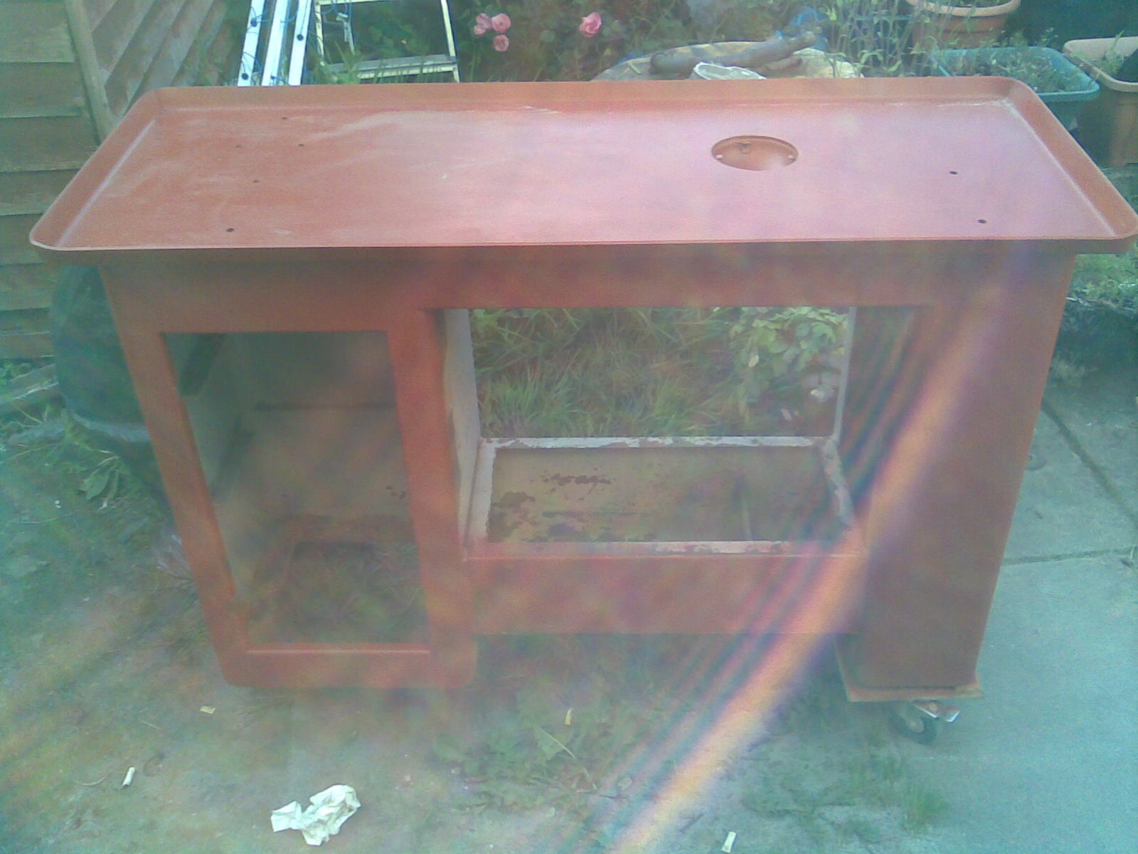

    i got as far as doing the top and front of the cab as well as the door then gave the stripped parts a lick of red oxide primer

    tomorrow i am aiming to have the rest of the cab stripped primed and the interior parts painted leaving the exterior ready for its first coat (if im lucky i may get 1 or 2 coats done)
    you may notice the castors on the left hand side of the cab, these are just for ease of moving the cabinet
    kudos to RNR for the grinder / wire wheel idea, i never thought of putting one on the grinder

    One thing tho, Once a part has been prime, it can not stay without paint for more than a day or 2... The primer must not get in contact with humidity once it is dry.
    You must paint over it (with final paint or under-coat) ASAP .
    Ho.... and do a test first primer... then paint on a small section to see if the paint re-act to the primer. (not all paints are compatible with all primers...)
