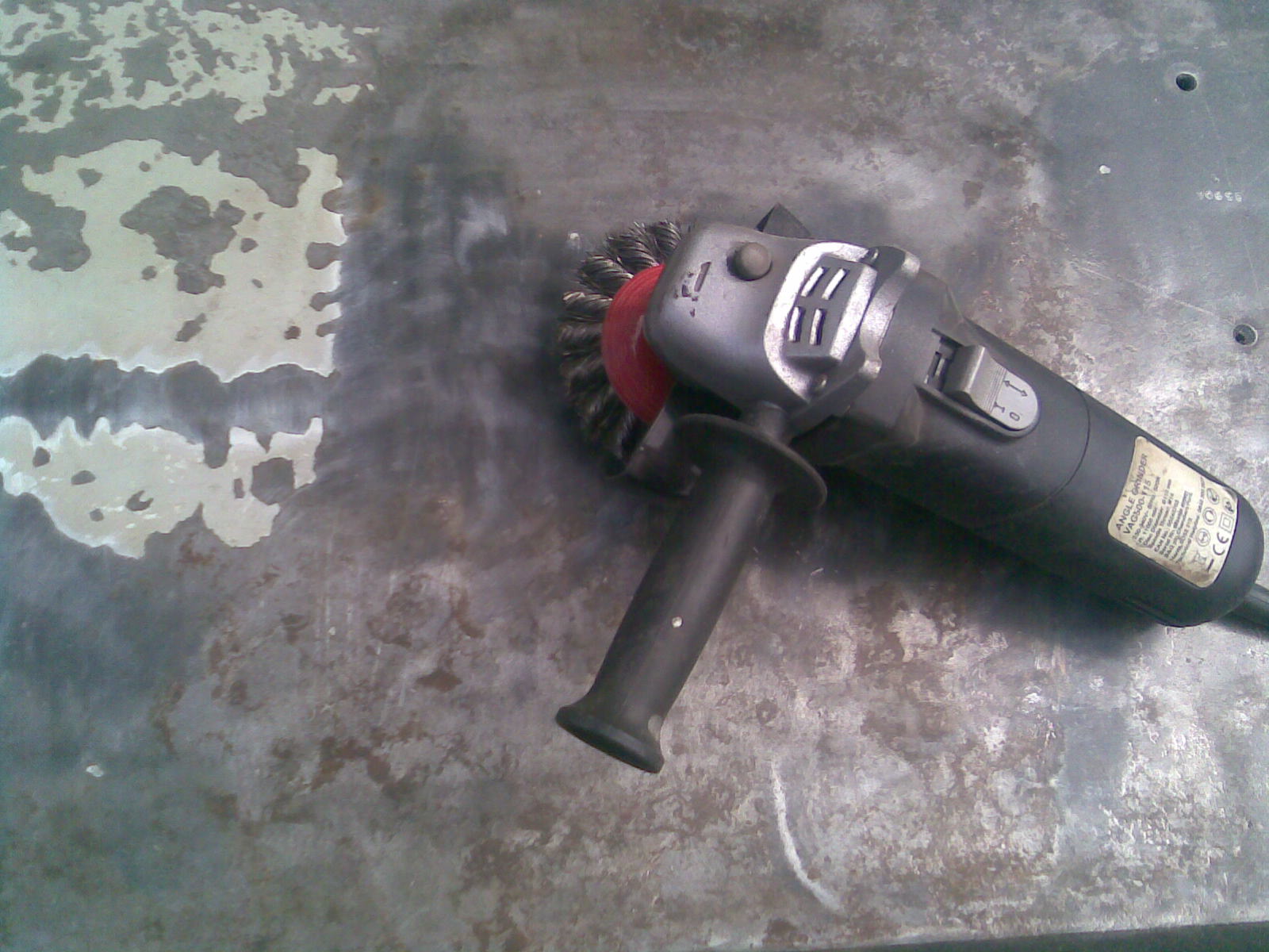

    The fun bit is not the paint. It is the preparation... Nitromos ! Wire brush ! Masking tape !
    Once you've finished repainting nicely your new lathe, these 3 words above will be the one you won't want to hear ever again! Beleive me! ;-)
    Seriously, To get a good finish on the paint, the secret is to take your time on the preparation! Make sure you get the whole lathe down to bare metal and shiny. No rust, do trace of oil, greace or old point. And do de-assemble everything and mask. Lot of people repaint there Lathe fully assemble and without masking, the result is horible... and the new paint peels off after a few weeks.

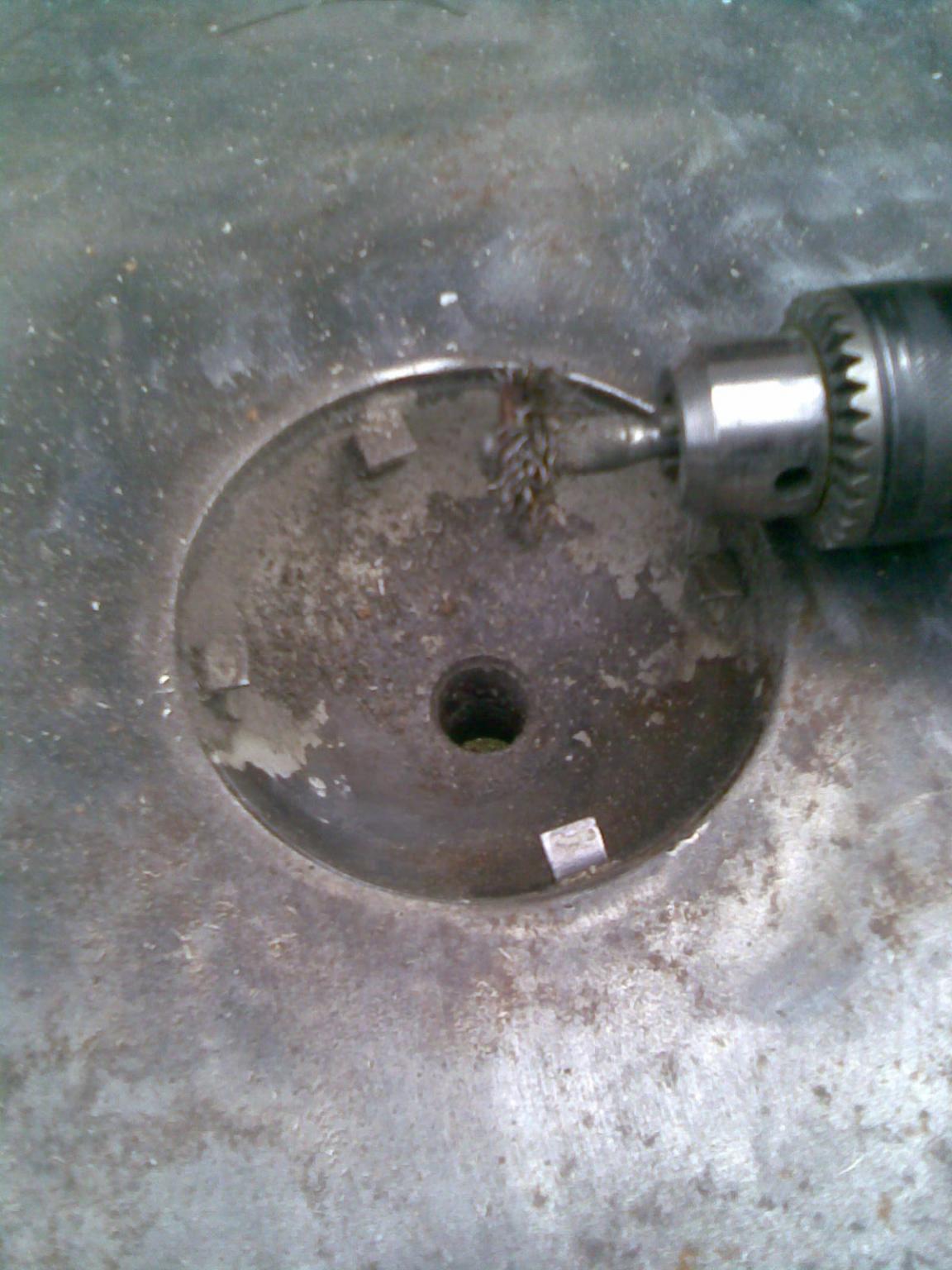

    as for quantities, it really depends on what method you are going to use. spray cans, spray gun or brush?
    as for diesel i just filled a 5 liter drum, im just using it to clean up the heavy dirt and grease so i dont think il use more than 2 liters
    you don't have to use diesel, i just use it because its cheap and close at hand
    what i really recommend you have is some wire wheels, either for a drill or an angle grinder but preferably both big and small in sizes
    and as much as i hate the stuff, nitromors is the best way of stripping paint from areas the wire wheels wont fit.
    good luck with the restoration
