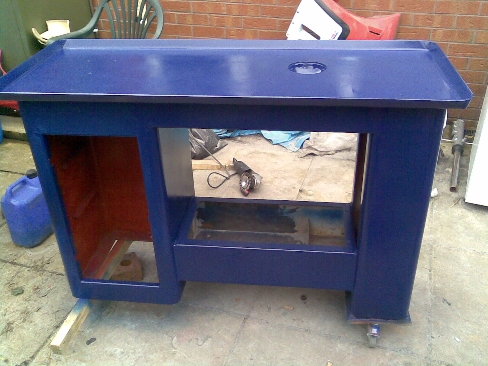

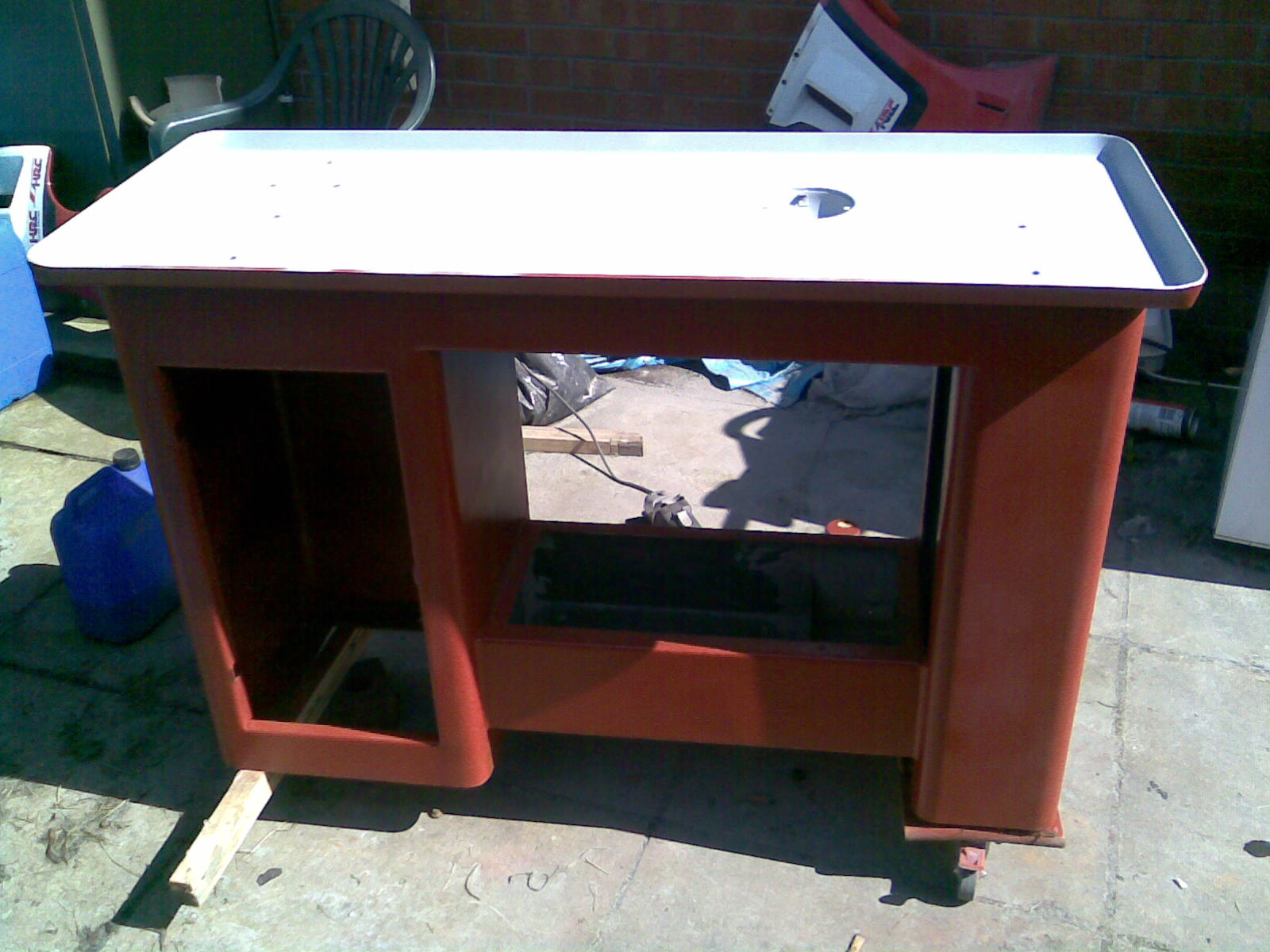

    made a bit of progress today, finished striping the cabinet, sanded it back and then gave it a proper coat of red oxide primer. then i used the high build primer.
    at that point i had a thought, is it really such a good idea to do it mainly white? it'd just end up grubby and quite horrible in no time!
    the original idea was to do the top blue and the bottom in white but since the blue came out so well (pictures don't do it justice) i decided to go for the blue and use the white for the interior of the cupboard and the door.
    first coat done, one more then lacquer should do it
