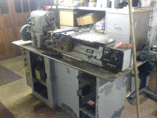

  1. I acquired this filthy Hardinge from a firm for which my brother has been doing some work. Apparently, they acquired it in a company buy-out and had it shipped to their high precision dept. The manager took one look and consigned it to the scrap heap (their HLV's are pristine and polished :)).
    That's my younger brother on the fork-lift and my next eldest brother's car and trailer. With my Eldest brother giving me a hand to get the thing off the trailer it was quite a family affair. Handy things, brothers :)

  2. Once in the garage, the first job was to get rid of the horrible off-white hand paint job...
    Fortunately the lathe must have had a minor 'tart up' prior to the hand painting; The darker grey blow-over spray job has not stuck to the original Hardinge enamel very well , so I was able to simply scrape off the two layers in one simply operation.
    I'm not sure what to do about painting it yet; I'd to spray it but my compressor's too small and the lathe is far too heavy to move to a spray shop - I'm thinking about rollering it on ???

  3. I heard back from Axis_gb , Sony's Uk distributor for the lathe's magnescale DRO. They have a replacement switch overlay in stock for <£10 and will supply a manual for free :) Truly superb service :)
    It's a testament to the robustness of the magnescale scales that they were still working (over the 2" or so that I could move them) while stuffed almost full of congealed coolant. There's no way a glass scale would have survived. I took them apart and scraped most of the stuff out, then cleaned them with safewash pcb cleaner (doesn't eat plastic, unlike some solvents) now they're working OK. (
    More good news...
    I had been disappointed to find that there were no change wheels or banjo behind the machine's gearbox cover (all the pictures I had seen of the HLV's had gears). Mick (the man on the forklift) spoke to one of the machinists at the firm I got the lathe from and he says they don't need change gears at all to cut English threads, the built in gear box works without them. :)

    Looks in relatively good nick, just been a bit unloved. Do you really need to polish the steel? Abrasives and lathes don't really mix all that well, OTOH a coat of paint could work wonders.
    Question is, did they junk it for a reason? The fact that it's still around could mean there's not a lot wrong with it
    I am also a fan of Safewash, smells like bubble mixture, expensive but not so bad if you buy the 25 litre size. I use it in an ultrasonic tank, dissolves awkward organics and leaves everything shining like a new pin.
    Robin
    Wicked project Bill, I will be keeping an eye on this one.
    Just taking back to the grey makes it look so much better, remember as you do this you’re doing it for us both and possibly some others!
    I think it’s just a case of not being to the "managers" taste by the sounds of it Robin, fingers x for bill that it’s not got any major faults.
    I would love to have a project like this, the space would be nice to ;-): beer:
