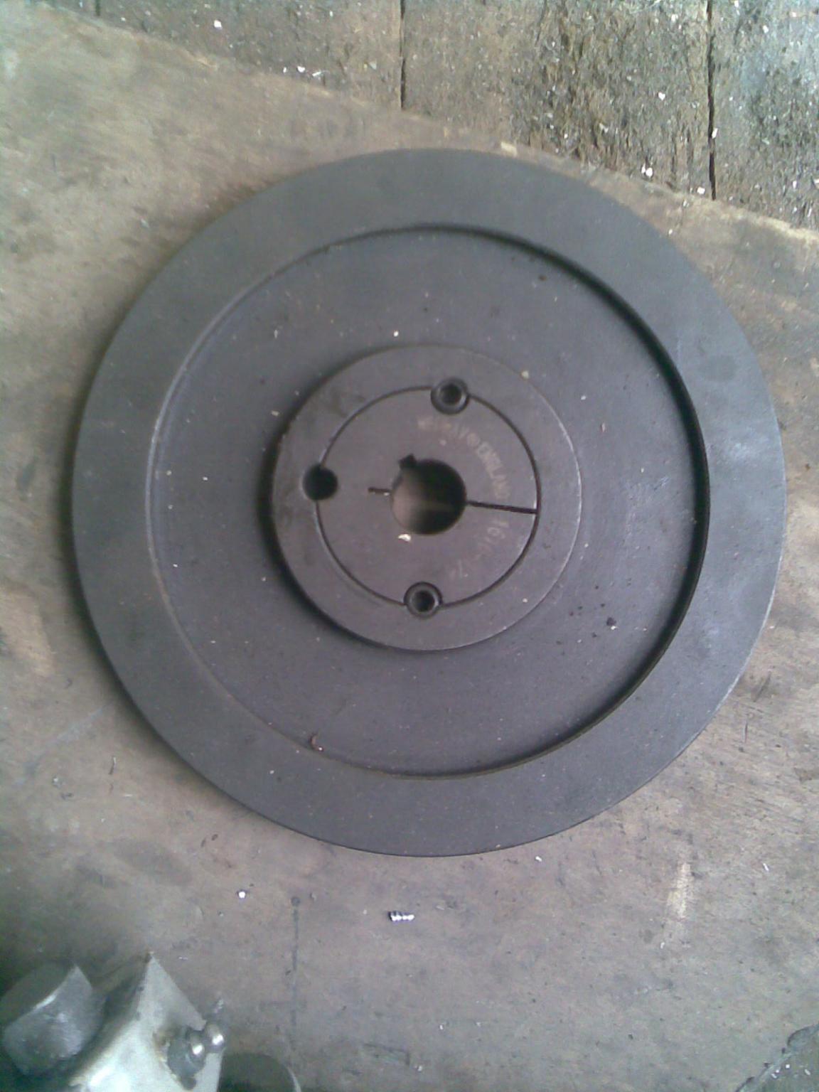

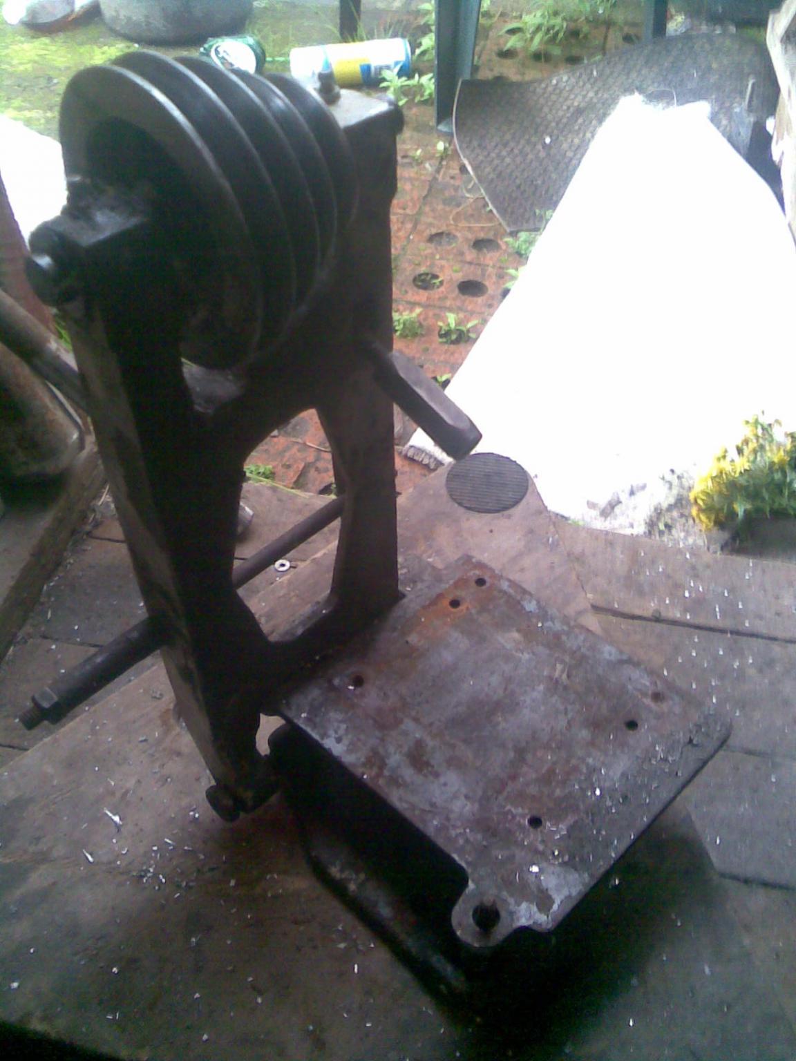

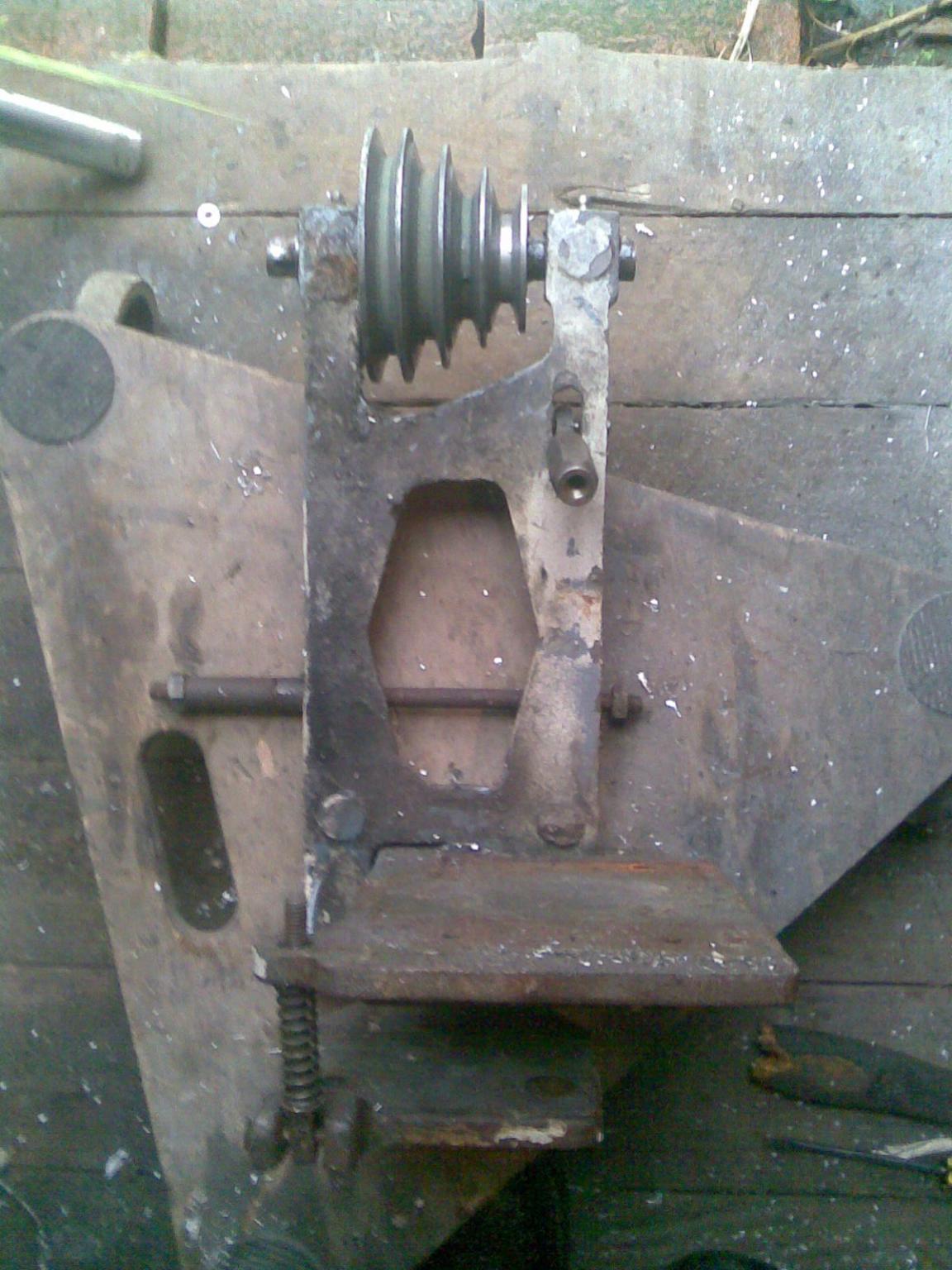

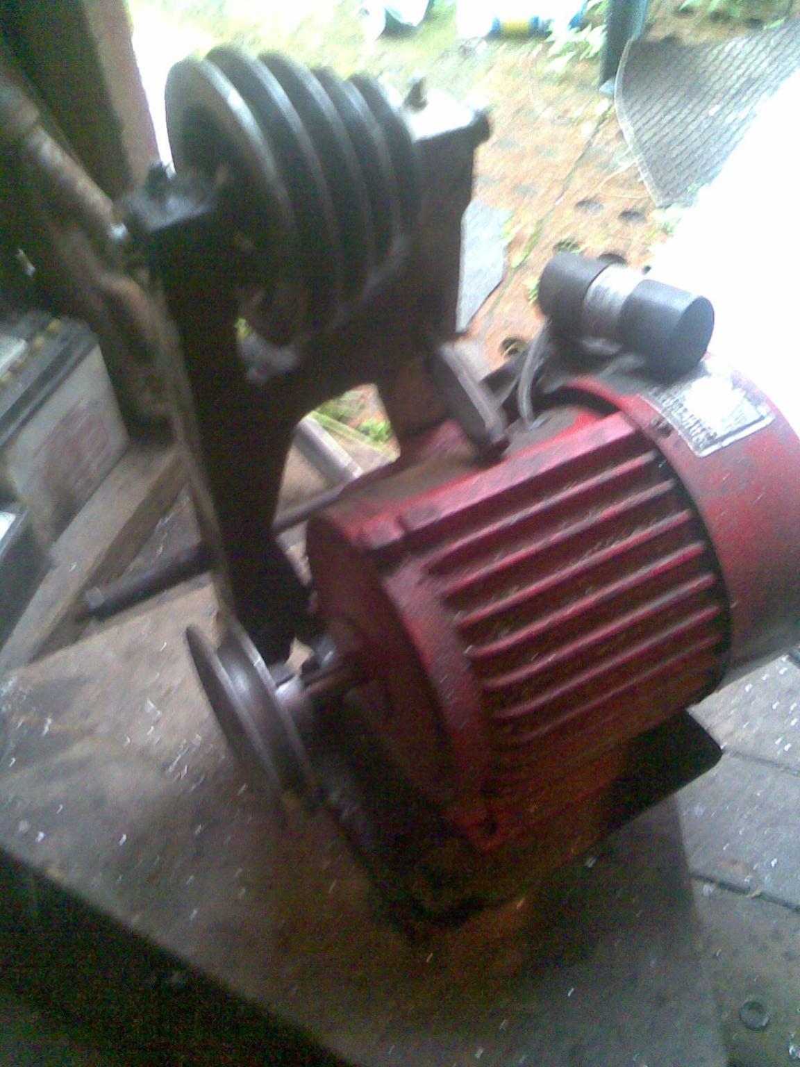

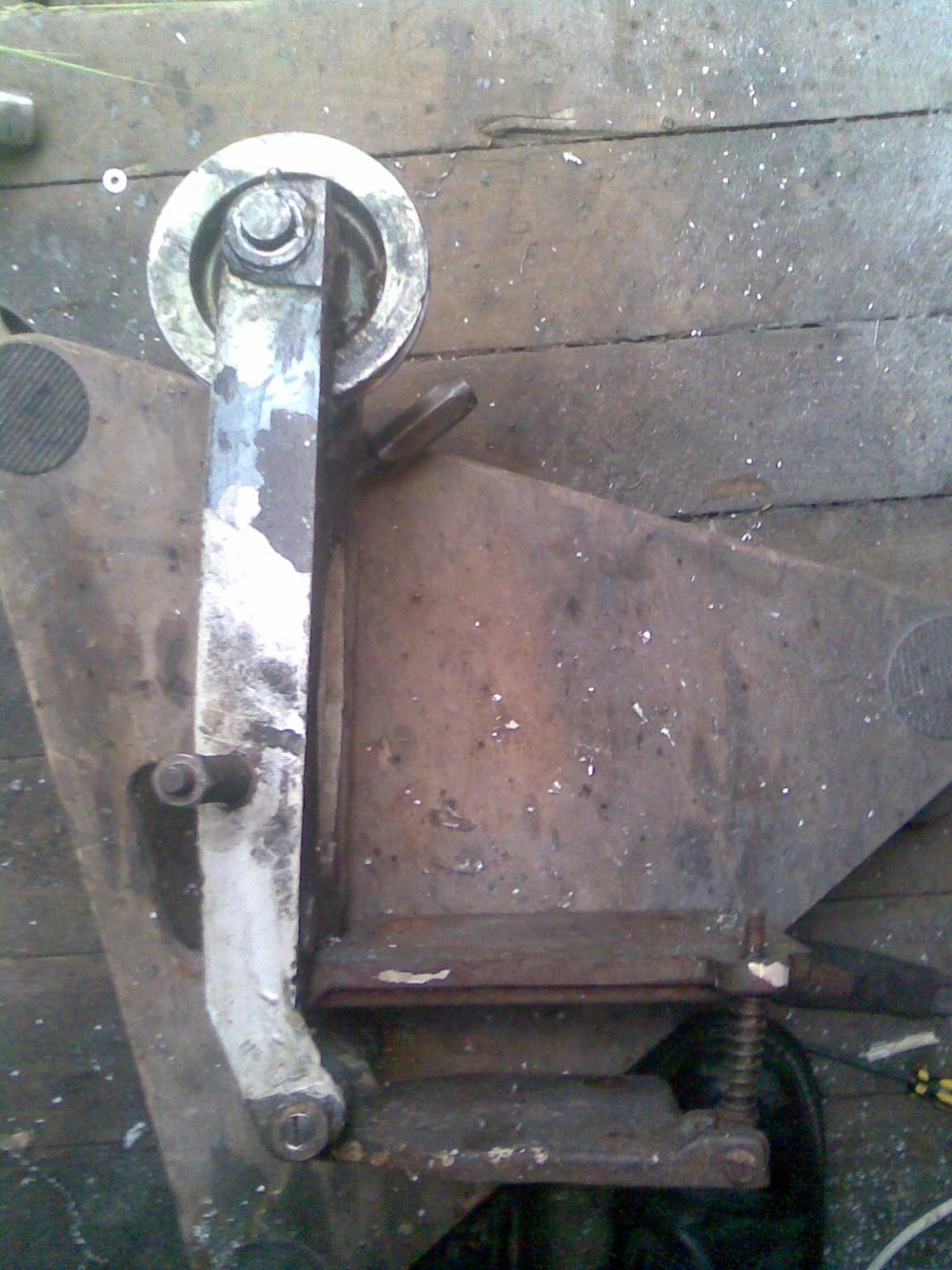

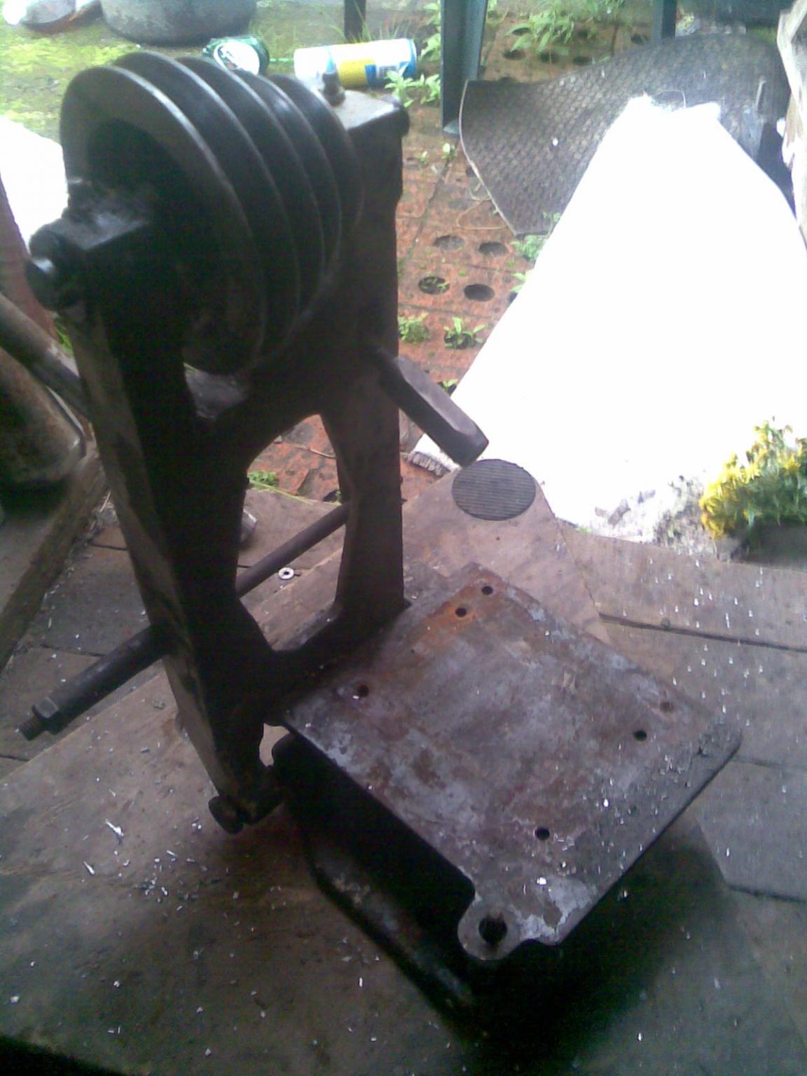

    after receiving questions about the motor mount from onecut i decided to take a few pictures and try to explain the counter-shaft assembly
    this is the assembly (minus the counter-shaft primary pulley) with motor loosely in position
    the motor is a modern-ish 1ph 1/2hp 1480 rpm
    the motor's footprint was slightly off for this fitment, but that was soon cured by drilling and filing the rear 2 mounting holes.
    if the motor's footprint is significantly different then an adaptor plate would need to be fabricated
    the main thing to make sure of when fitting a motor is to make sure pulleys are as parallel as possible
    both belts are tensioned by a single lever that mounts between the assembly and the back of the headstock
    here we can see the counter-shaft primary pulley, this lathe originally had a set of 2 speed pulleys delivering power from the motor to the counter-shaft (giving 16 spindle speeds) this modern equivalent certainly does the job but limits me to 8 speeds. i plan on running a 3ph motor with a vfd in the near future so i wont bother sourcing/ machining a 2 speed set of pulleys

    one thing to note, the csb model has a different "simplified" counter-shaft design

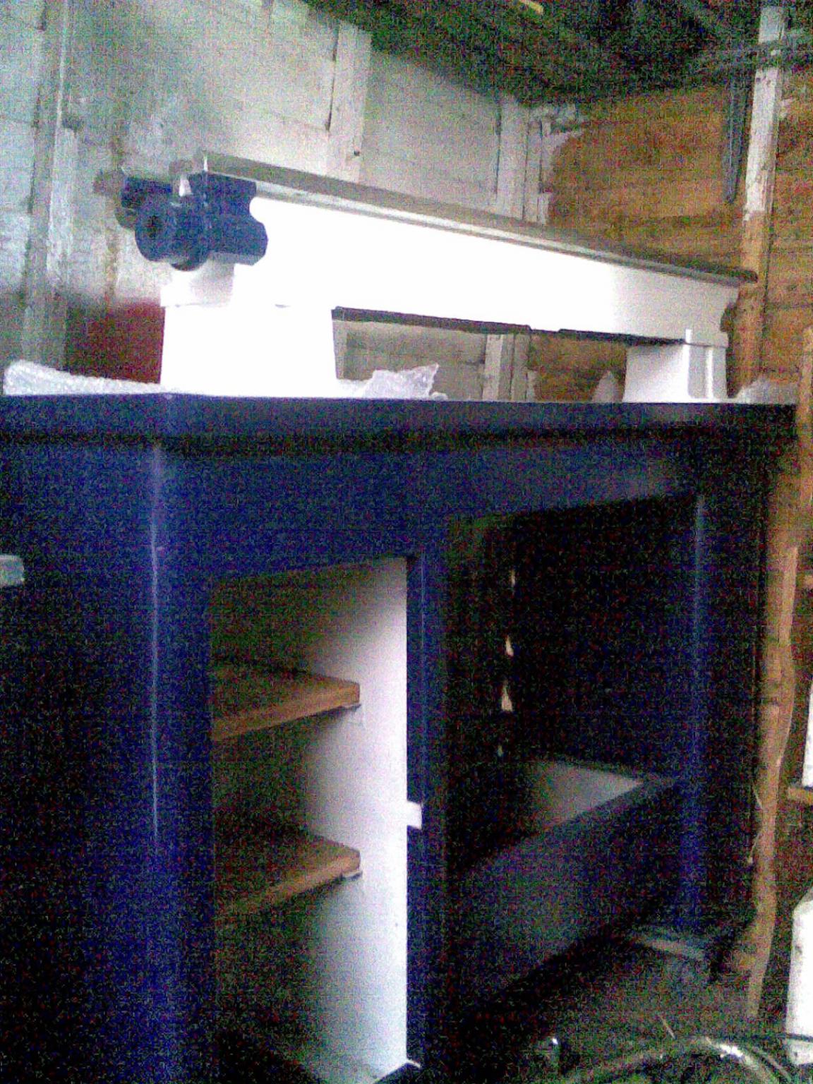

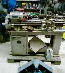

    found these pictures today.
    these are the first 3 i took of the lathe just before i bought it, back when i didn't have a clue :p
ID:	6698Click image for larger version.
ID:	6699Click image for larger version.

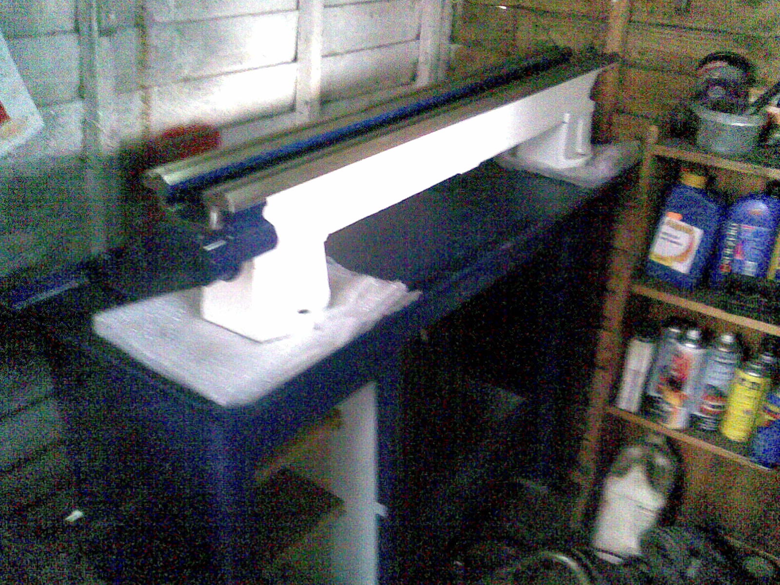

    and for comparison...

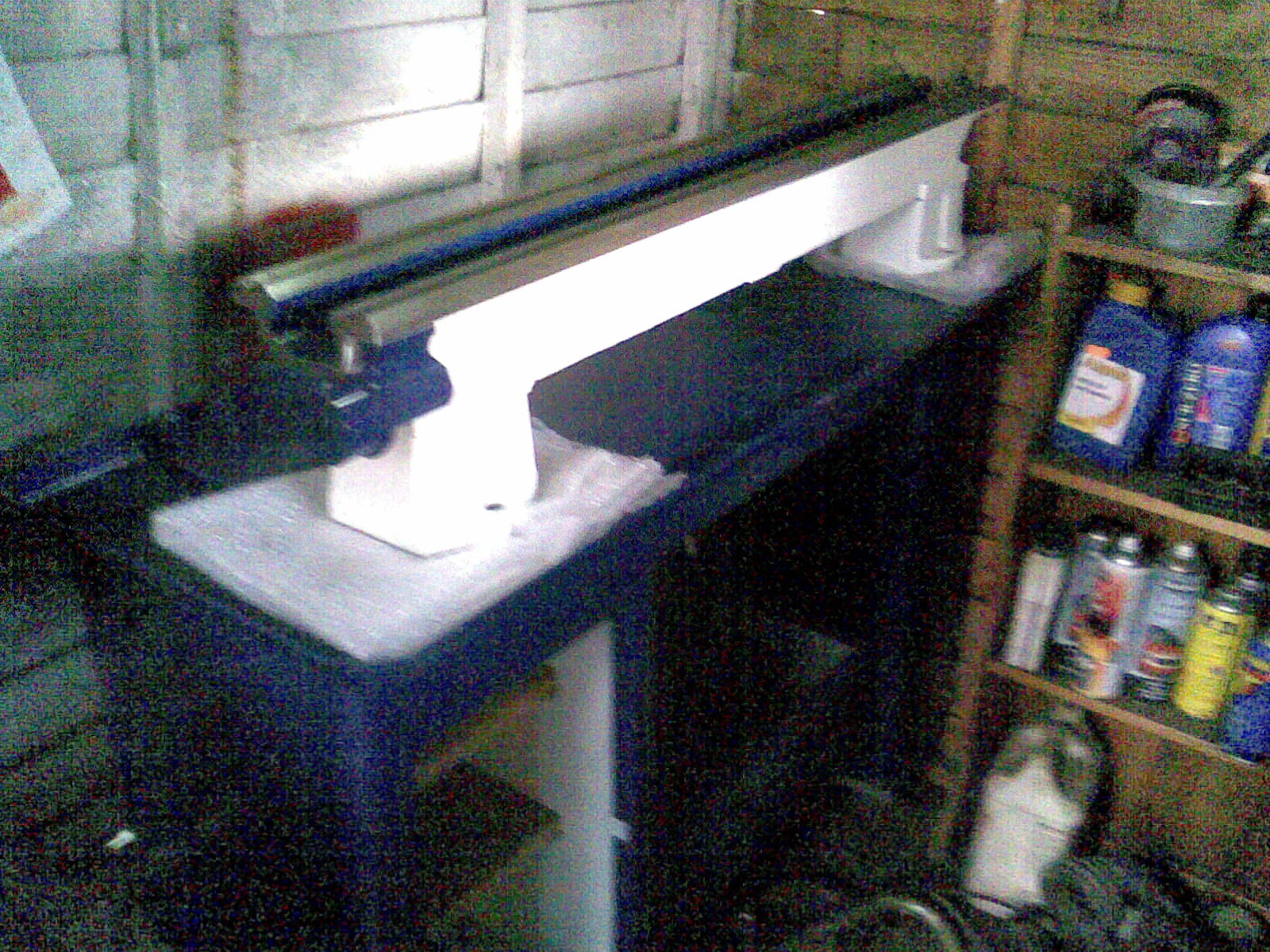

    this is the latest photo (note the bubble wrap method of paint protection)
    sorry again about the disgraceful photo quality but its my only camera/phone

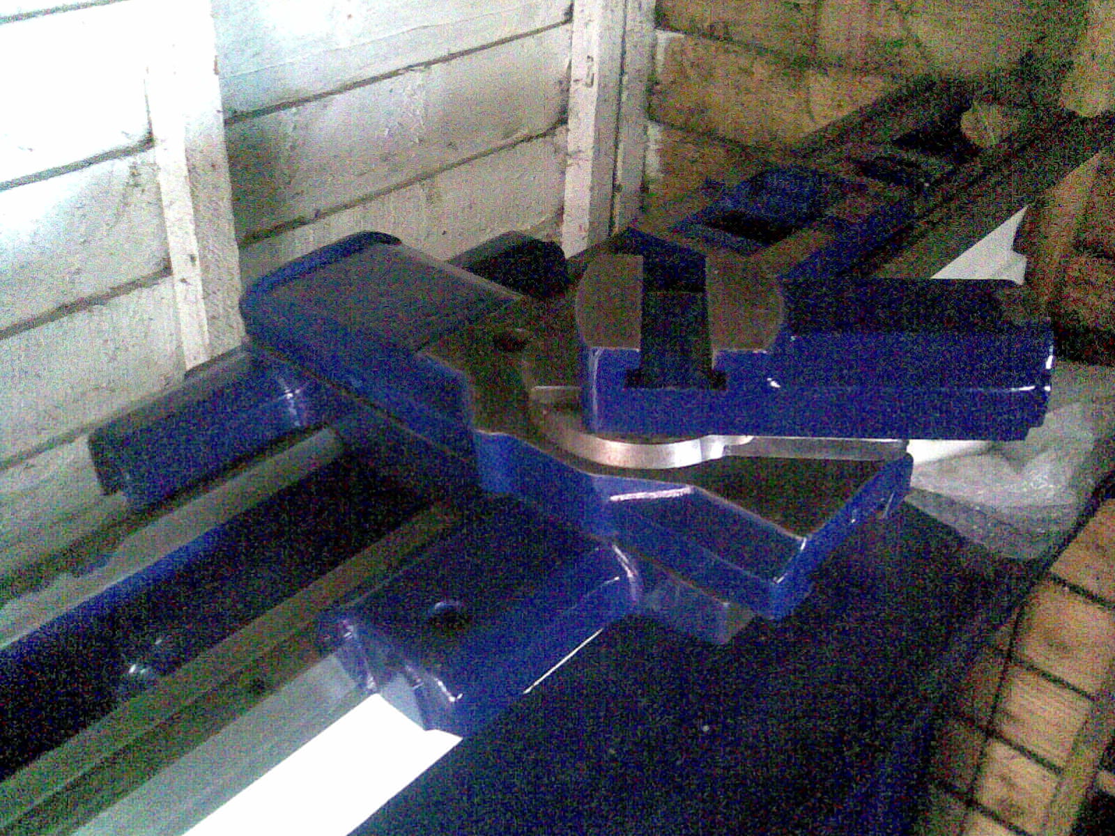

    ok, slow progress but progress all the same
    here is a slightly better pic than what i had posted last
    the carriage is looking well with the cross slide and compound loosely fitted for the photo

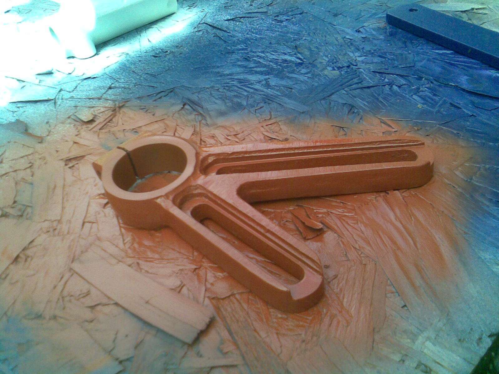

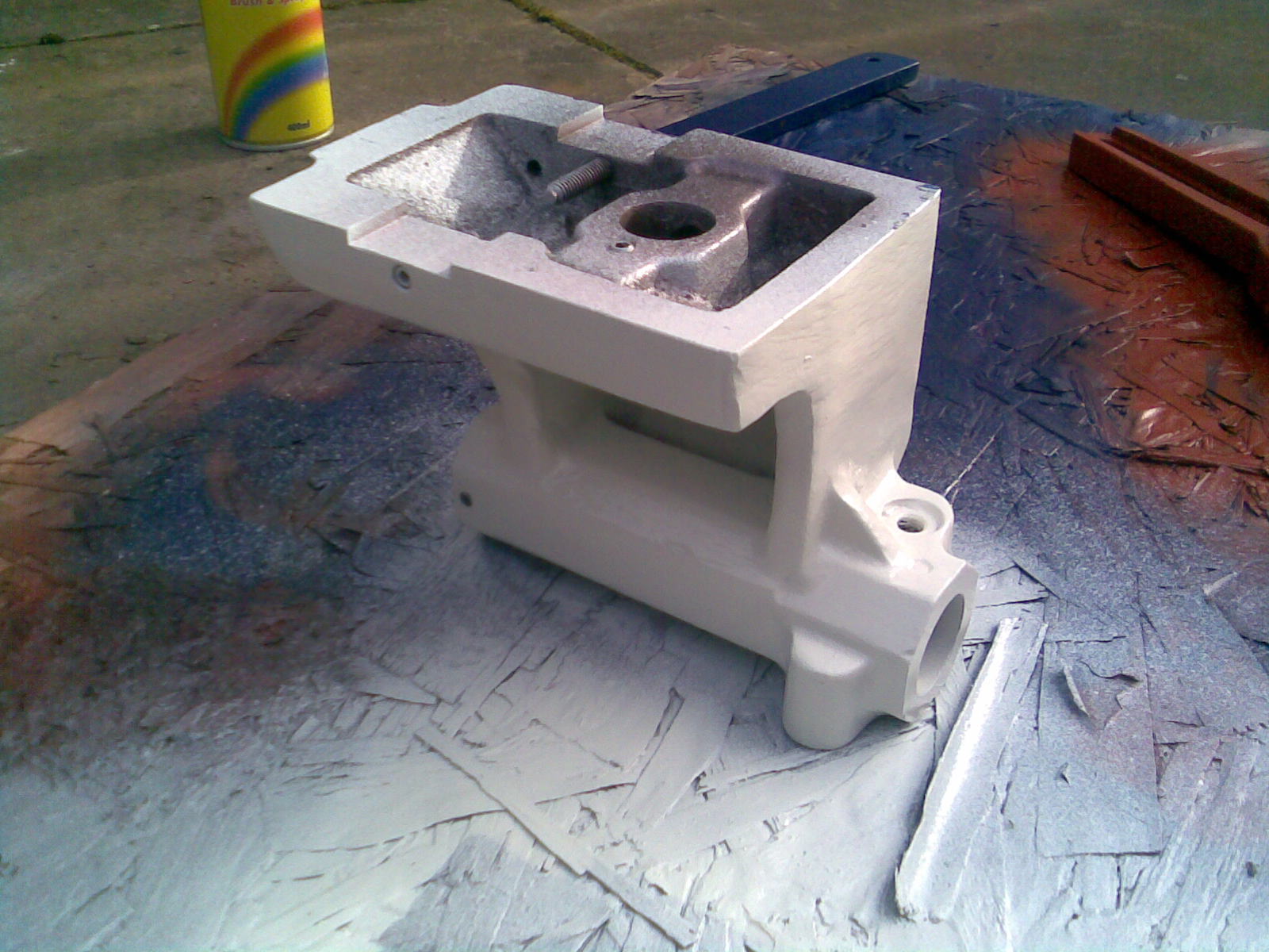

    outside the shed we can see the change gear quadrant and tailstock casting receiving a good lick of paint
    as you can see, the quadrant has received its first coat of red oxide primer and will get another one or two before being sprayed blue
    on the other hand the tailstock casting has already had 2 coats of oxide and 2 of grey before being sprayed white, once dry it'l be assembled

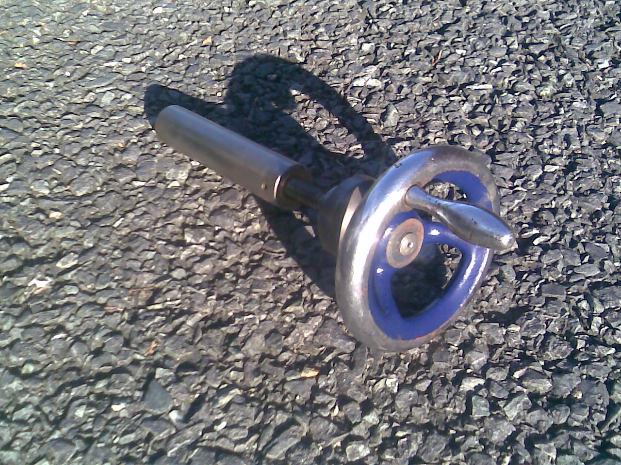

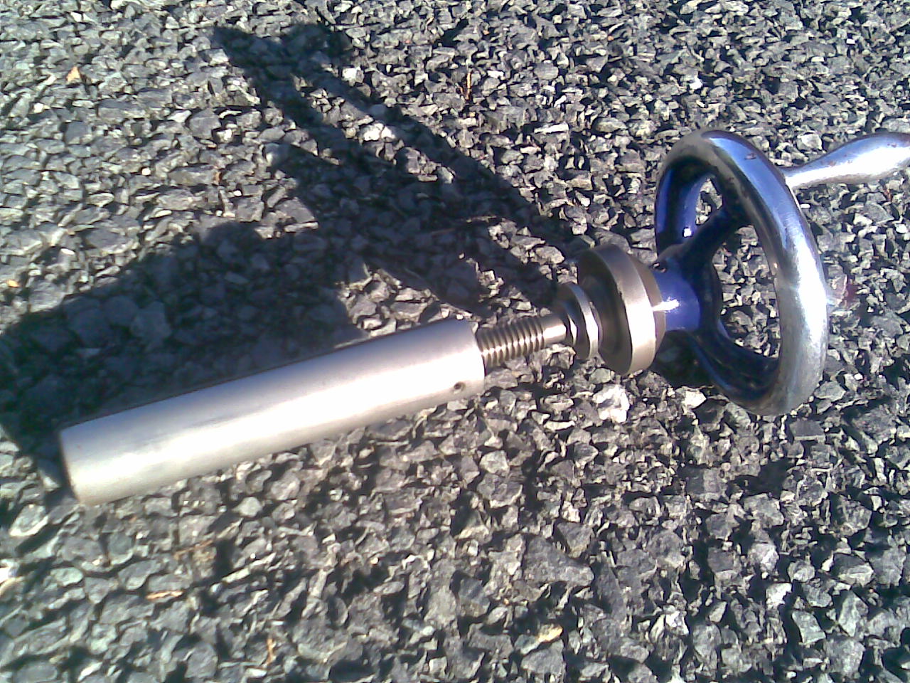

    here we have the tailstock ram, screw and handle already cleaned and handle painted ready for assembly
    all the paintwork done in this thread has been with cans, from primer to lacquer the technique i find works best is to be very patient and take things slowly. i found out a long time ago that if i try to apply a full coat in one go that i am guarantee'd serious runs so light coats with a few minutes in between works well
    its also good to make sure the nozzle is 100% clear and the can has been well shaken!

    good job jonny one thing l noticed the crosslide that holds toolpost angler divisions on it ,you have yours tilted in picture,how come mine doesn,t move is it because yours is a b and mines a poor relation c-take care :-one cut
