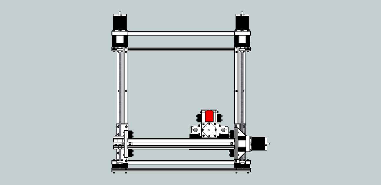

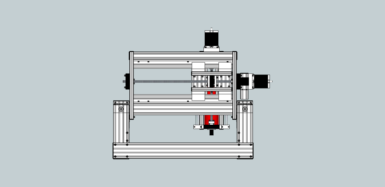

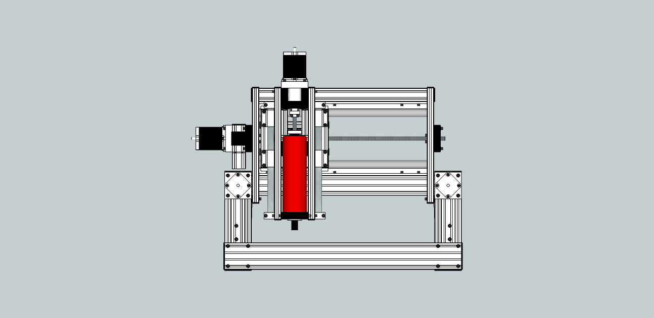

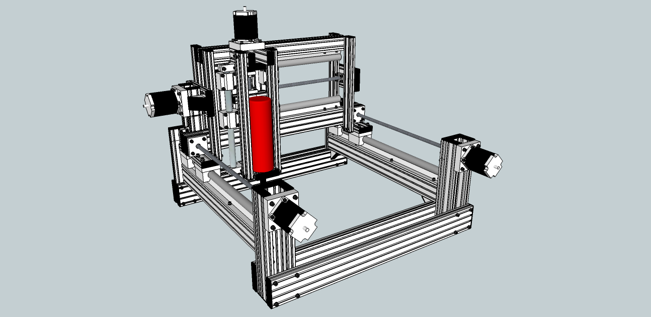

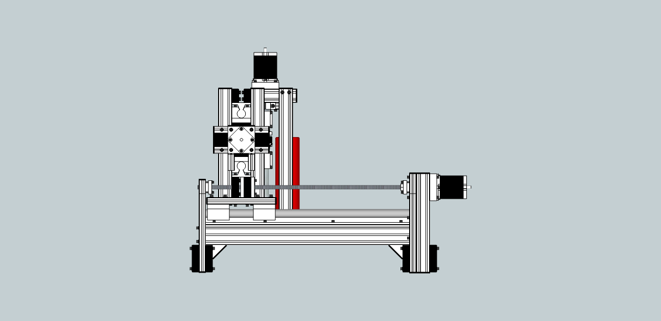

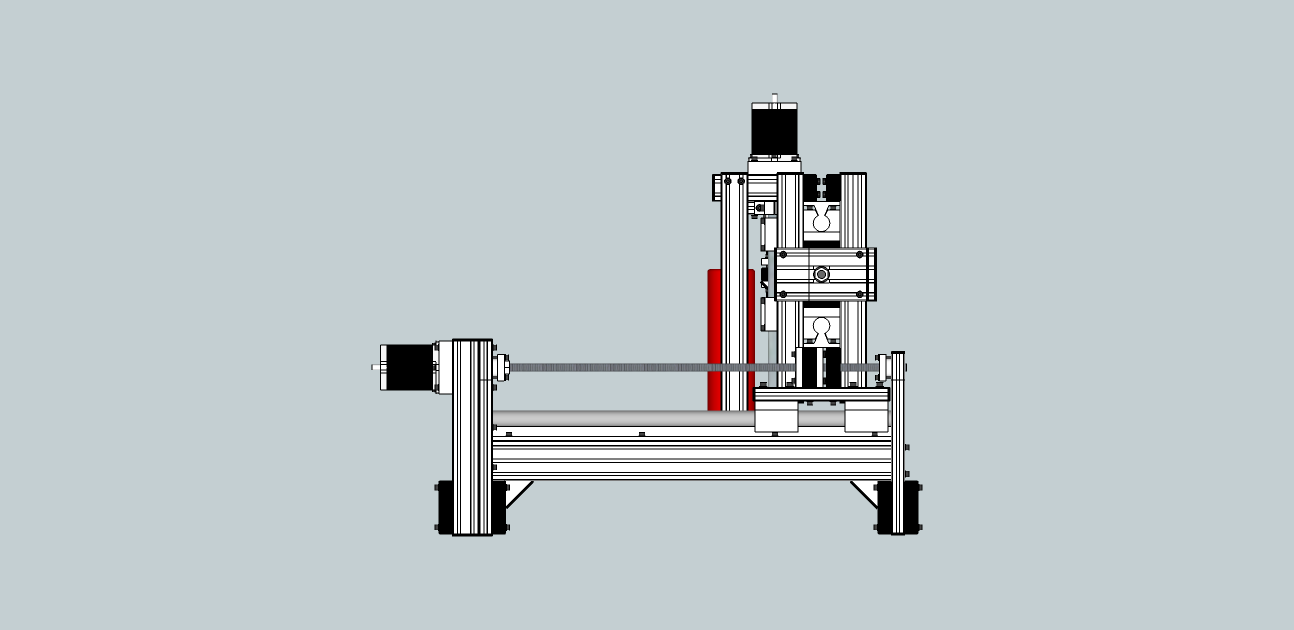

  1. Hello All, here is my first post in what I hope will become a full build log. As mentioned in my Introduction (http://www.mycncuk.com/forums/new-me...say-hello.html) I have one quite tough requirement a bit of steel machining and am building it with a view to making the plans available to others who are in the same boat as me, well not my Narrowboat, but you get what I mean :-)
    Posted here are the drawings for the machine I have in mind for my use X=600mm (Apprx 400mm useable) Y=500mm (Apprx 300mm useable) and Z=350mm (Apprx 150mm useable). I hope this design is scaleable by adding longer rails and extra rail supports, that was certainly my intention. I have also allowed space where the drive nuts are to go upto 16mm leadscrews for the bigger machines, though I have seen 8'x4' machines with 12mm, to me it just doesn't look man enough.

    Build requirements are to use as many standard components as possible and any unique parts must be able to be made on a Pillar drill. I tried to design it so there had to be no sections that had to be cut to length, but I'm afraid I was only happy with a design that involved the 4 long X Axis beams to be of exact length. All other joints are on the main faces of the extrusions.
    To repeat my self slightly My choice of components are governed by 3 factors 1) Cost, 2) Sizing, where possible they are Multiples of the 20mm of the sections I have used & 3) The need for nothing more complicated than a pillar drill.
    The machine has come together quite chunky, but that to me is OK as I want to machine metal quite a bit of the time, say 10-20% and I have allowed the cutting area to extend over the rails at the front to give a solid base as I can for doing this.
    I will put a Bill of Materials (BOM) on here soon, it's just a bit messy, as it was being constructed along side the drawing. I posted some of the major specs in my introduction, but a BOM will give a more complete story.
    I may do a slight redraw to include the DumpsterCNC anti-backlash nuts as for the price I'm not sure my idea, to be posted soon can compete! I have tried to justify Ballscrews, but I wince at the prices and speed and accuracy are not my ultimate goals. I may change my mind of course once I start making stuff, but I am fairly confident I can retro fit them at a later date, without too much trouble. Mostly I want to get a machine going so I can start learning!!!!
    I'm happy to provide more detailed views if you need them and really want to know if this design is viable.

    Hi Geoff,
    I see some issues that will definitely affect it's ability to cut steel and will also affect performance in Aluminium.?
    The tall gantry won't be any where near strong enough.!! While it's sat directly on the bearings the what looks like 45x45 uprights just won't handle the forces steel and aluminium will put on it.
    The un-supported rails on the Z axis and to be honest the whole z axis design just won't be upto the job of steel or Ali.!
    Don't know if your planning on putting any braces across the frame to support the bed.? But again to cut any hard material then extra support will be required.
    Please don't take my comments has pulling the machine down just comments based on quite extensive work building router based machines that can cut hard materials and still give an acceptable quality.! . . . . The thing you and others should be aware of is that router based machines can never cut steel or aluminium like dedicated milling machines can.!!
    Wish you luck and keep the designs coming.
    I am really not surprised by this :-) , it is why I have sought help on the design! I am starting to think that some of the videos of what to me at least look like flimsier machines cutting Ally accurately, might be using a bit of artistic licence!
    Although doubled up, the uprights are in fact just 40x20! so are as weak as soft smelly stuff in that case :-) I was thinking of joining the two Y Axis cross beams with a sheet of Ally to stiffen the entire structure, just haven't got round to adding it to the drawing.
    To cover both of the above points, the Y Axis will travel over the cross members at the front of the X Axis and I was planning to work the material with the Z Axis as close to the top of its travel as possible. That means all loads will travel the miniumum distance to the strongest parts of the machine. Not sure if that will help enough? I am hoping to keep the centre as free from bracing as possible as I want to be able to engrave on Motorcycle engine cases, but I guess it is only a small amount more work to remove bracing to get big stuff up from underneath, when compared to removal of the Sacrificial bed and its support.
    I didn't Jazz, it was what the drawings are posted for!
    I do appreciate that dedicated machines are the best way to go, they always are :-) and I would love to have space for more machines, but I will be working in a 6ft cubed area on my boat and I really only have space for this 1 machine outside the Pillar drill! Super accurate finishes are not going to be critical on the parts I make, they will be more art than engineering, so cutting speeds, hand de-burring and polishing, while a nuiscance aren't performance critical.
