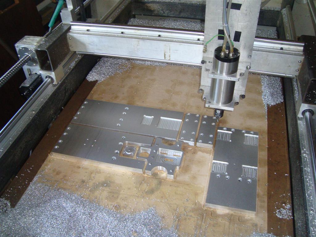

    Flat aluminium bar is nowhere near flat, but if you get standard 6082-T6 flat plate I've found that to be very close. If you're using supported round rails it will be sufficient, but with profile rails greater flatness is required to stop them binding so I'd go for milling pockets in the flat plate or if you've not got a milling machine get the eco-cast.
    For example:
Name:	DSC09610 (Medium).JPG
