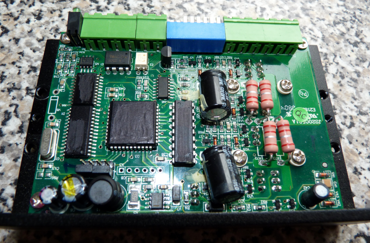

    LOL, that looks like my 2280n!
    Let me know if you need any pics of it...
    If you can find what the component is connected to that should make it fairly obvious...
    That's easily done as different drivers put them different ways round - if I recall correctly the 2M880n is the other way round. I've got some pictures of inside a 2m880N, but unfortunately they're mostly out of focus or too dark to see anything useful:

    Just out of interest which mosfets does the 2m542 you have use? The one I looked at has IRF9Z34N
    I'll grab some pics for you shortly, i'v got 3 of these drivers not doing anything. I like taking photo's as well so they should come out nice !
    Ok mine are the original MSD542’s from Motion Control Products; they did another version after this one as well but I’ve not got any of those.
    I took these quickly for you, so don’t know if they help. Click twice on each for the full size image.

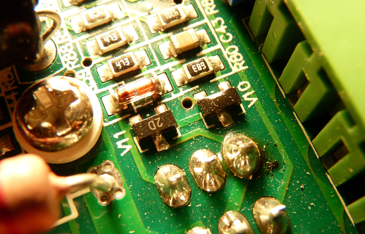

    Thanks for trying Lee, i will lift the dead component and clean it up so that i can see the tracks and have buzz round. Looking at the reverse side of the board it is labeled as a Leadshine M542 V2.0 dated 2008-10-09. Do we have any Leadshine stockists?
    Jonathan the Fets i have on here are IRFZ44N
    I've just sent Leadshine a mail to there support people to see if they can help? see what happens?????
    No problem!
    This one is a Leadshine v1.1 so it looks like yours is the one after, Gary @ Zapp maybe able to help or one of the guys at MCP. Dont know if they did/do a v3.0 but it would be handy if you could get another v2 to have a look at, have you not got the others...i guess not or you would of looked at one of those.
