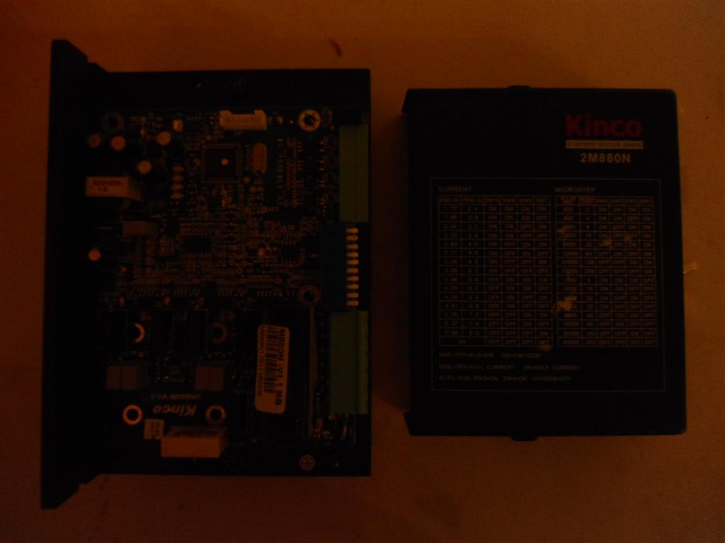

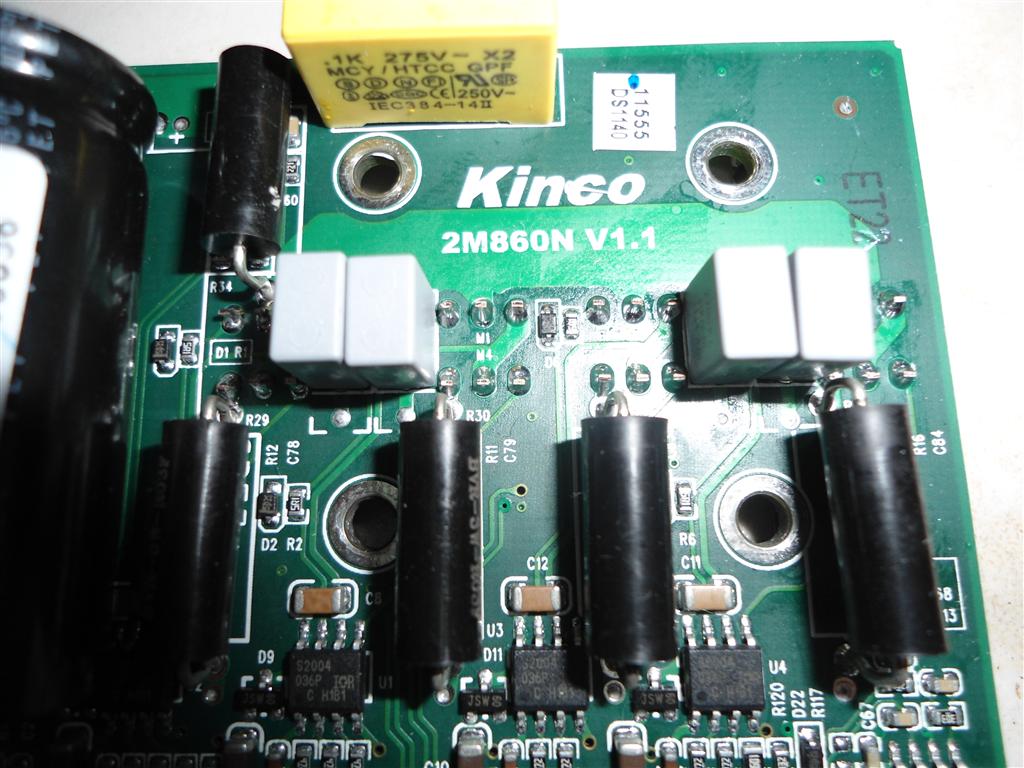

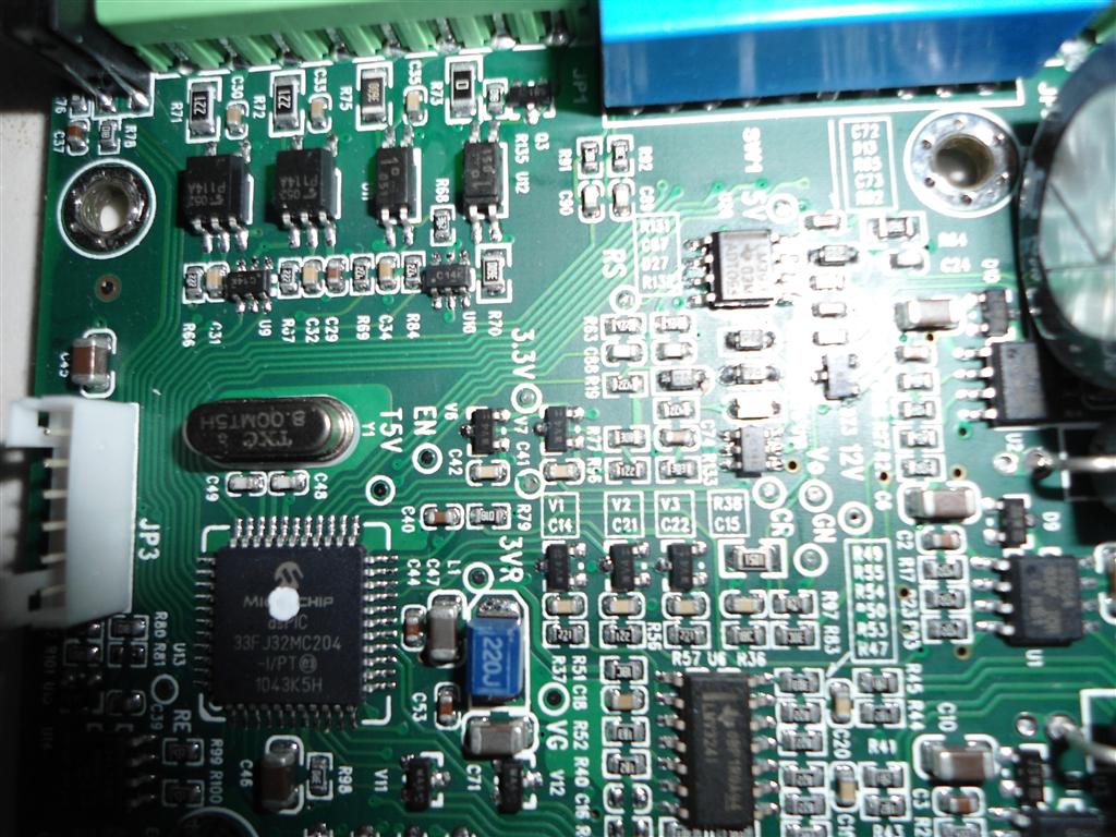

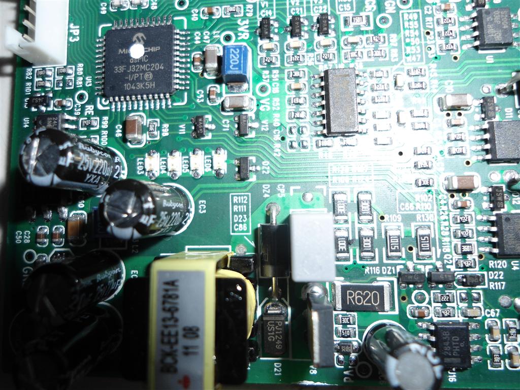

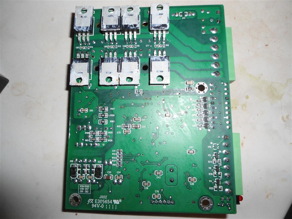

    LOL, that looks like my 2280n!
    Let me know if you need any pics of it...
    If you can find what the component is connected to that should make it fairly obvious...
    That's easily done as different drivers put them different ways round - if I recall correctly the 2M880n is the other way round. I've got some pictures of inside a 2m880N, but unfortunately they're mostly out of focus or too dark to see anything useful:
    Attachment 6190Attachment 6191Attachment 6192Attachment 6193Attachment 6194Attachment 6195
    Just out of interest which mosfets does the 2m542 you have use? The one I looked at has IRF9Z34N
