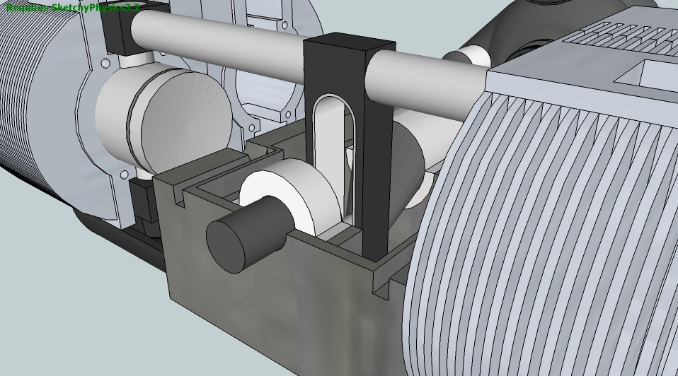

    BR i can see some issues with your design and position of TDC when firing happens. With everything being at opposing positions you will just end up with a pile of bits as it locks up upon detonation. I would look at a more traditional layout of the crankshaft myself? As for tools a Mill and a lathe is must for what you are doing. Buy the biggest you can get away with on your pocket and space. Allow plenty of time to learn the basics to save hundreds of hours screwing it up. Expect to spend more money on the consumables, hand tools and measuring devices than the machines.

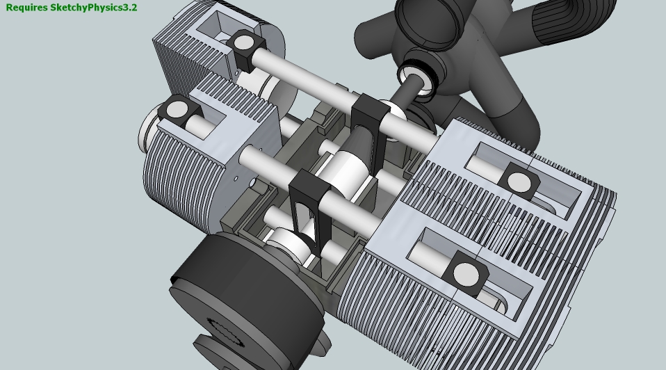

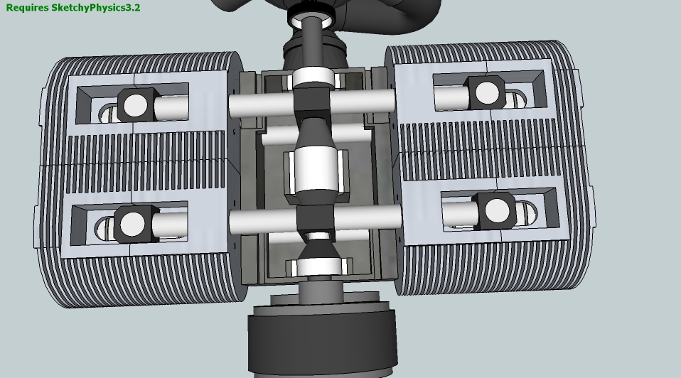

    BR i can see some issues with your design and position of TDC when firing happens. With everything being at opposing positions you will just end up with a pile of bits as it locks up upon detonation. I would look at a more traditional layout of the crankshaft myself.
    Now this is the kind of advice I'm looking for. I currently have it set up so that the opposing pistons are basically one unit, so that each pistion assembly has 4 combustion chambers.(see pic) Would it work better if the piston assemblies were a few degrees off? More than a few?

    You need to consider power delivery. Each time a cyclinder fires, you get a high load followed by a power surge. This causes the crankshaft to deform, so it's got to be suitably designed to handle the peak torque. By having two cylinders firing at the same time, you'll be putting a lot more stress through the crankshaft.
    Ideally you want power delivery at equal intervals, which would mean the two crank pins being 90degrees apart, however you'd have to take into consideration the crankshaft balance.

    i think your ok in principle but i would have thought a 45degree rotation on your crank timing so that your firing one charge at a time (higher frequency vibration but less amplitued than firing two charges simultainiously i would think)
    crank balancing ..... errrm.... your on your own there :) im not sure if you just balance the crank or you take some of the piston and con-rod mass into consideration
