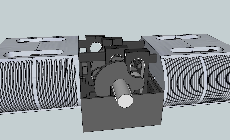

    Actually a good share of commercial diesel engines are two stroke even today. Catapiller, and Detroit Diesel to name 2 big ones. The main concern with this design, I think, is that injection starts after the exhast port is closed, which I don't think will be a problem.

    Look at it again, there are no valves, only ports. There are already two combustion chambers per cylinder. The rods you see are the scotch yoke/connecting rod for the piston. Actually though if I had them go 90 degrees and then down I wouldn't have the difference in exhast flow on the bottom chambers.

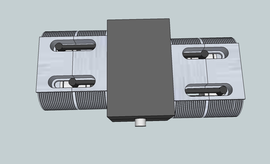

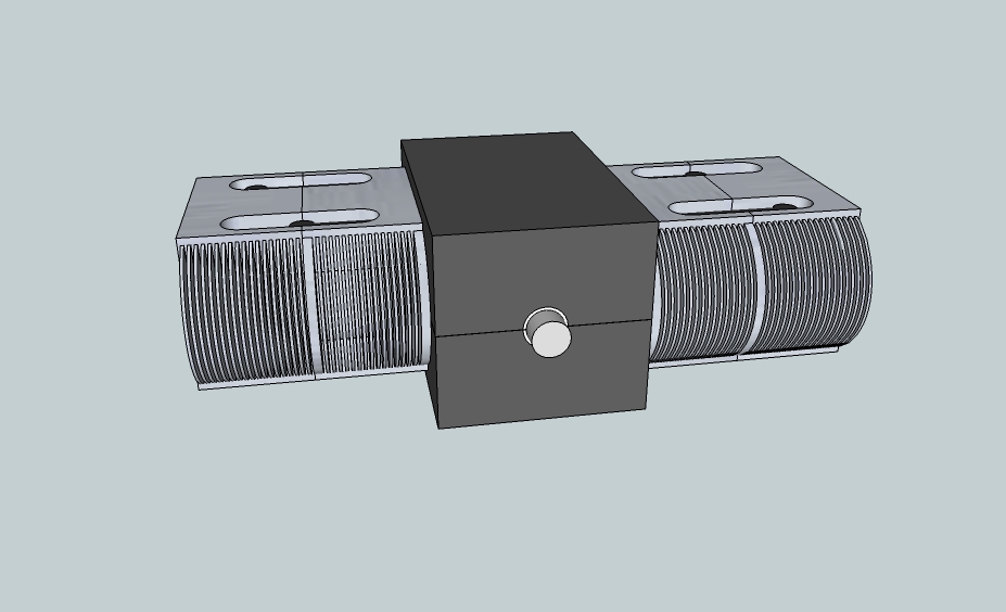

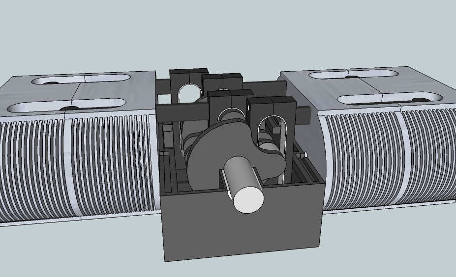

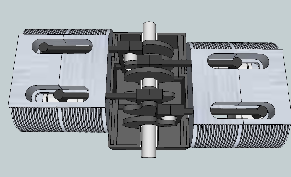

ID:	6260Well I took some of your suggestions and made some changes to my model.  I staggard the cylinders, increased the stroke a bit, made the intake ports longer than the exhast ports, and completely redesigned the crankshaft and crancase, including some counter weights.  I still need to redo the manifolds and induction system as well as add injectors and systems for cooling and oiling.  I wonder if one could design the lubrication and cooling systems as one system.  As in oil cooling, running the oil through a radiator and such.
