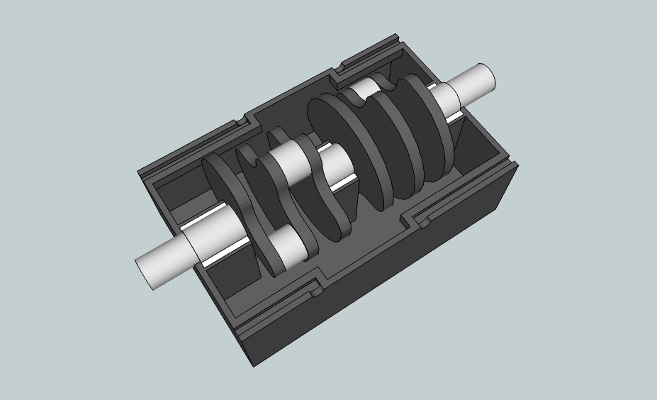

    You still seem to have the crankshaft running in bushings, assuming that's what the white pieces are? Surely you would want to use proper bearings, or is the temperature too extreme, doesn't seem likely? Fitting bearings seems a lot easier than making bushings and getting them all aligned.

    I'd assume the ultimate aim would be to use plain bearings, just like a normal engine...
    That's what I intended I just didn't do any research on what they look like.

    Fair enough, I thought rolling bearings were more commonly used in engines which now I've checked clearly isn't the case. There seems to be much discussion on various forums about their relative advantages and disadvantages.

    Standard 'modern' plain bearings consist of two semi-circle shells of white-metal on an aluminium backing plate.
    The white-metal acts as a temporary and sacrificial bearing surface in the case of no oil/metal to metal contact, as under normal circumstances there should be oil to provide a hydrostatic/fluid bearing.
    The only modern engine where you're likely to find rolling bearings, are small two strokes.

    There does that look better?Click image for larger version.

    I wouldn't go as far as "better" :-) You may also want to invest something to deal with the lateral (axial) thrust on the crankshaft.
    Could you explain your thinking regarding the 90 degree offset of the crankshaft?

    I guess that was what others suggested in order to keep everything smooth and balanced.
