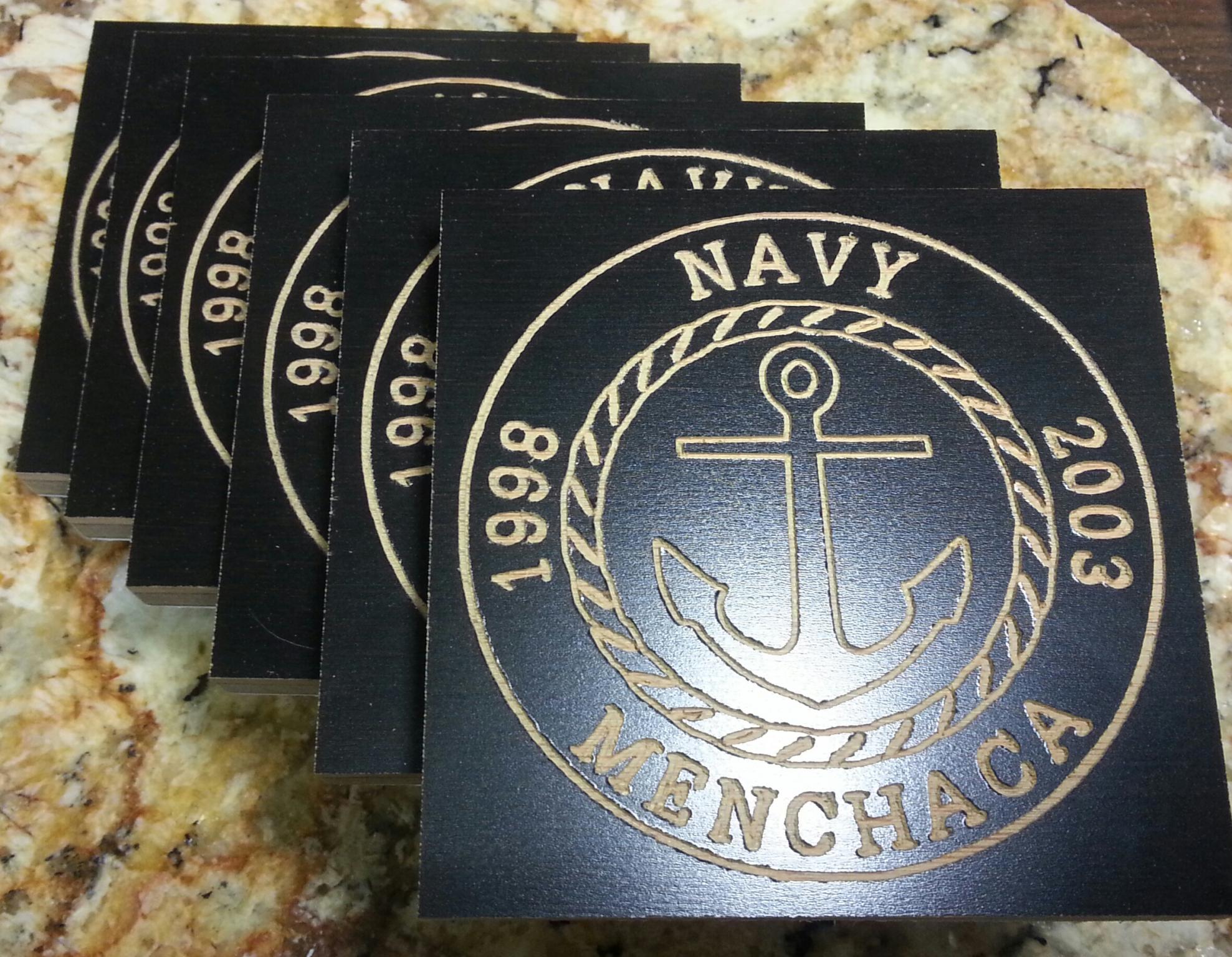

  1. Oh man inkscape is great for fonts. Its openSource.
    You can fit text to a curve. This allows text around a circle.
    I'd post a pic...but can't figure how.
  2. I figured it out.
    After you do "fit text to path", you can also adjust each letter individually for the spacing (kern) or vertical offset. This is good so letters don't touch each other or the circle:
