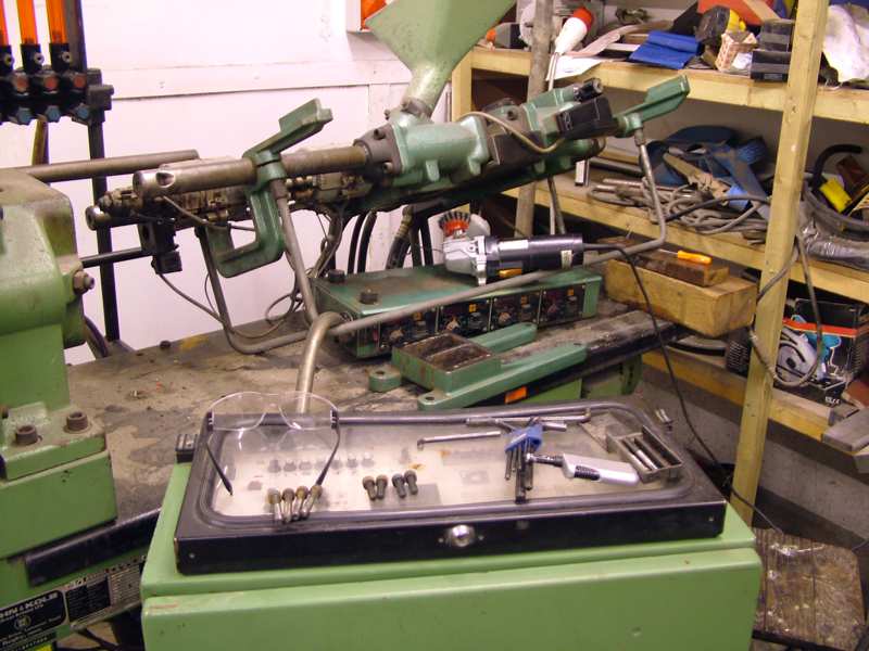

    Put it all back together with clean relays, fixed the broken solenoid connection, checked LED b20 now lit when I closed the guard and it all looked hopeful.
    I switched on the motor, pressed "Close mould" and the platen zoomed forwards, I pressed "Open mould" and it zoomed back, I pressed "Advance ejectors" and heard the ram go, couldn't see it because the guards were shut. Didn't dare press anything else because the screw was cold and I haven't checked the interlocks that would prevent me testing the screw shear pin for functionality at the same time.
    Jubilation, shouts of "Yeehar etc.
    Next I need to put together the water cooling, check for leaks and descale the pipework. The cooling does the oil, the mould and puts a thermal break in the screw which is in hot plastic at one end and connected to a hydralic motor at t'other. Don't want to cook the seals.
    For cooling I have a 1/4 hp suds pump, the cheapest new car radiator I could find on e-bay, 10 yards of 3/4" hose, a nice quiet fan and lots of sulphamic acid for the descaling.

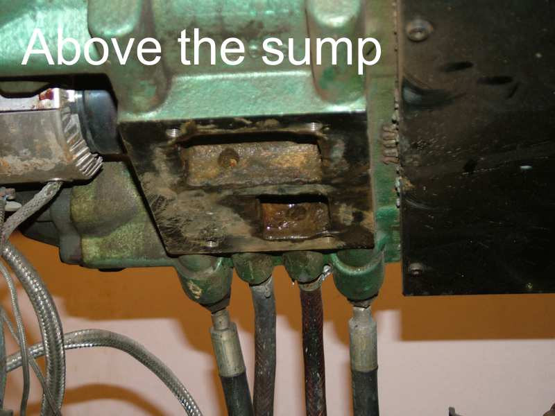

    I had to make 2 new hose connectors before I could try pumping water into it's cooling system. Nothing would go through the oil cooler, turns out it has a thermostatic valve so I won't know if it leaks until 32 gallons of hydraulic oil get hot.
    Nothing came back down the screw cooler return pipe either, but it did a pretty good impersonation of the "Mannequin Pis" so it would seem I have blown a gasket. Don't think that circuit has a thermostat, seems unlikely, probably just gunged up. Hopefully things will become obvious when I split the gasket seal. It's in a bit of a tricky place to get at, but that has never stopped me before.
  6. #16

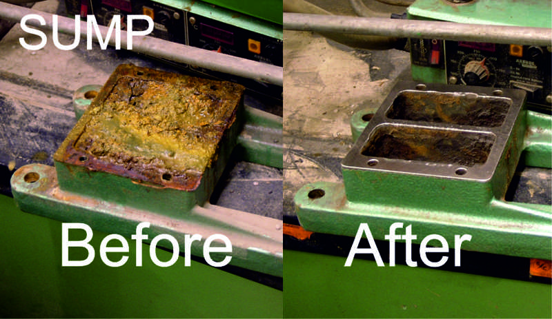

    Opened the leaky gasket and found a sump full of rust gunge. Just waiting for the top to dry out before I remove the last of the old gasket and make with the gasket compound. Type blue I think.
    No obvious blockages, no thermostat, the water goes over the top. I can only presume the rust gunge blocked the pipe, it is certainly the gasket eating culprit.
    I sat there for 20 minutes stabbing a screwdriver up in to the top cavity until no more great lumps fell out. If it blocks again I should be able to dislodge it with compressed air and let it drop into the sump. Well, it's nice to have a plan

    I suppose it is vaguely possible that someone might have similar problems and find my pictures useful, so here are some buzz words for the search engines to pick up on... Arburg Allrounder 221 221-55-250
ID:	6349   Click image for larger version.
ID:	6347   Click image for larger version.
