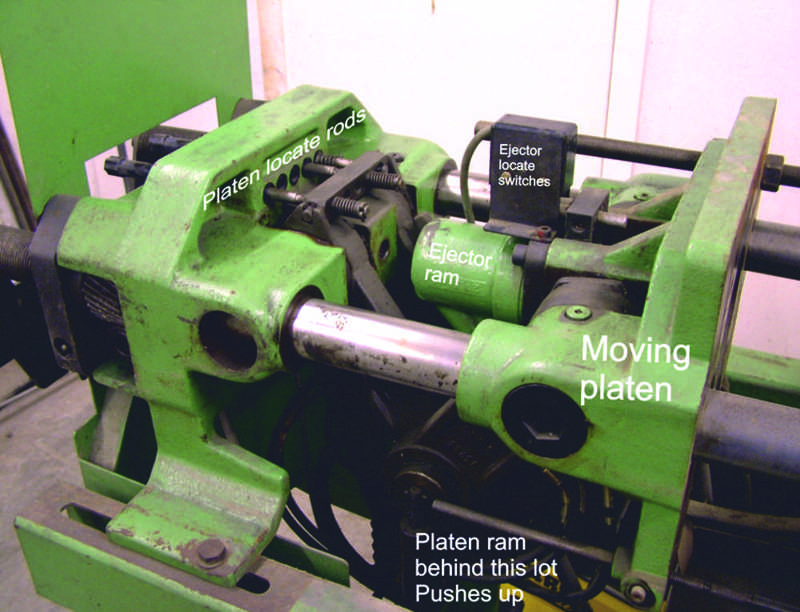

    The name of the game is persuading LED b20 to light show the guards are in place and allow the hydraulics to come on.
    The manual says, "Magnetic read-contact on safety grid of the safety gate, activated by a magnet mounted to the stationary mould platen".
    Do you reckon "read-contact" should be "reed switch"? If so I am good to stick my multimeter up it's yarris.
    It is one, or more, of 3 sensors that is kaput.
    #2 looks common or garden mechanical.
    #3 is built in to a "Rexroth hydraulic interruptor". Sounds a bit Dr Who but has a little Perspex window and I can see what looks like a contactor going up and down. Hoping it isn't that one, too many screws for comfort.

    The hydraulic interruptor looks like an afterthought because it doesn't wire to the little distribution board which does the rest of the guard switches. According to the hydraulic circuit diagram it diverts any oil sent to the platen closing ram straight back to the reservoir. I presume they used the electrical switch on it simply because it was there. It seems to do exactly the same job as the "read-contactor".
    After much reeding of the manual, I have found a reference to an optional, "pneumatic safety gate" which I don't have. I believe it locks the guards shut while the machine cycles but the manual is vague. There is a socket where an "auxiliary control box" plugs in and the manual says, "Jumper plug in b41/b42 if control box is not connected. Without plug in b41/b42: no mould closing". Off the top of my head, I can't remember there being a plug in it, this could be fun to try and recreate without a circuit diagram if it isn't there. OTOH it would be nice to think that wiring and sensors are all present and correct.
    There's another idea out the window, I don't have the aux socket, it's blanked off. Everything seems to work fine, except it doesn't.
    To understand it I took the guards right off and found 2 more gadgets to stop me cycling it with the guards open. A switch and an interlock that physically blocks the platen if all else fails. This machine is seriously paranoid.
    It all comes down to one box of tricks with a 12 wire connection that covers most everything and I will need help to buzz it out, I haven't got enough hands.
    With the guards off I went around all the bits and pieces figuring out what they do. It's much easier to fix something if you know how it works and the manual is not friendly. Now I understand it everything looks bleedin' obvious.
    I was surprised to find the fixed platten isn't fixed at all, which explained why it has pipes connecting to it, it's got grease lines. If it moves before it should, the machine assumes something didn't eject properly and it would be a bad idea to insist.
    Next. disassemble the box of tricks, buzz it out to the controller, make sure the guard switches are connected. It has 8 switches going to 12 wires, how hard can it be?

    Still no reason why LED b20, guards closed, doesn't light. I took the control box apart and found a mess of TTL, this thing doesn't have a microprocessor. The control box has an input labelled b20 which lights the LED and does nothing else.
    There must be another circuit board to nobble b20 somewhere in the cabinet which is an absolute rats nest of wiring. However, I now know which pin on the monster plug control box plug goes to b20. Armed with that I should be able to find this mystery board and see which of it's inputs is failing to light b20 and enable the hydraulics.
    When I plug/inplug the shorting link on the optional core retract guard socket I can hear a relay click, so I am probably looking for a board with relays on it.
