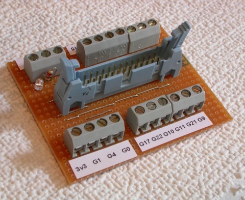

    Interestingly enough Mike Cook has recently done a little BOB for the raspberry pi:

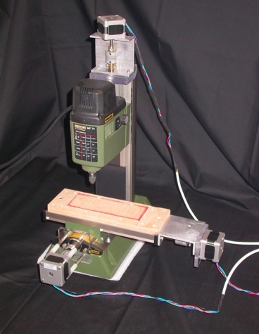

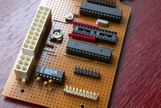

    He hasn’t had his long, however looking at his “portfolio” he has also done a CNC Conversion converting a Proxxon MF70 machine to cnc and then building his own version of the RepRap controller, a unit also based on the Arduino:
