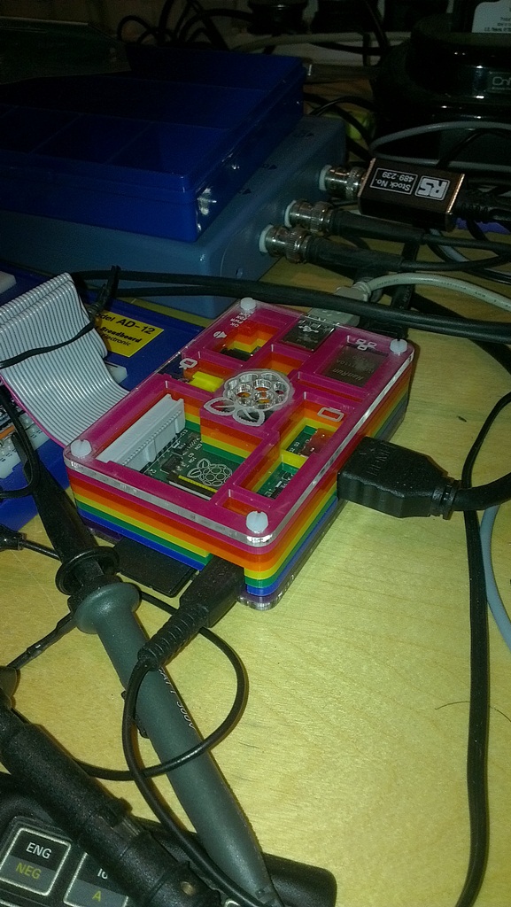

  9. :) The only progress I have made is to put Pi #1 into a nice CNC'd case from Pimoroni
Name:	Pimoroni Pi Case.jpg
  10. #50
    That is sexy !
