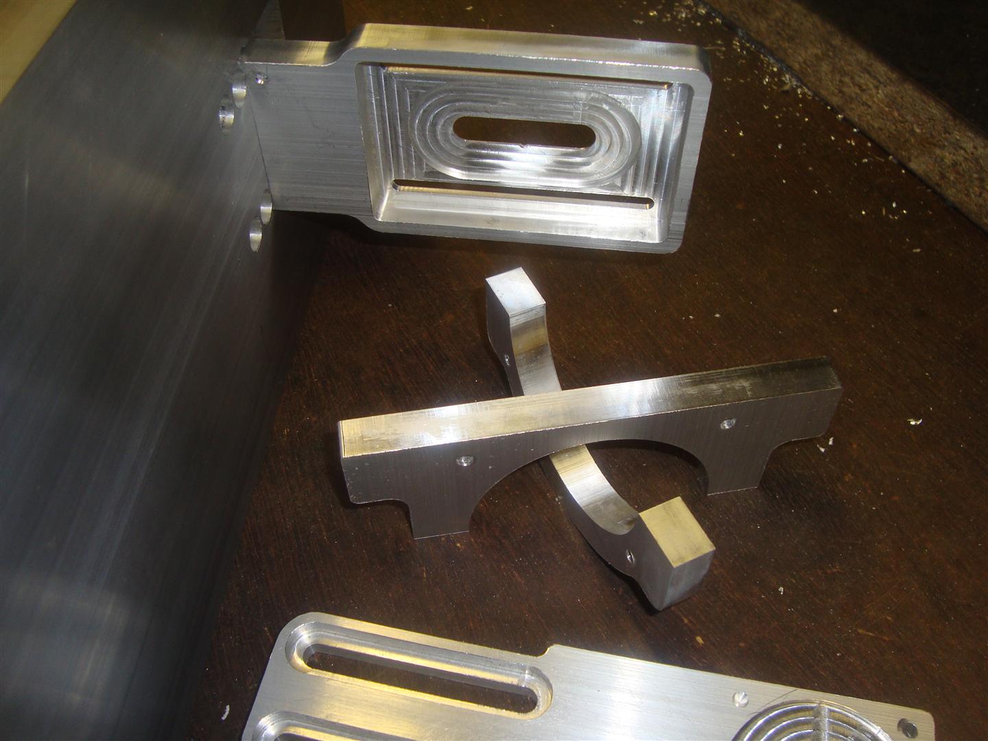

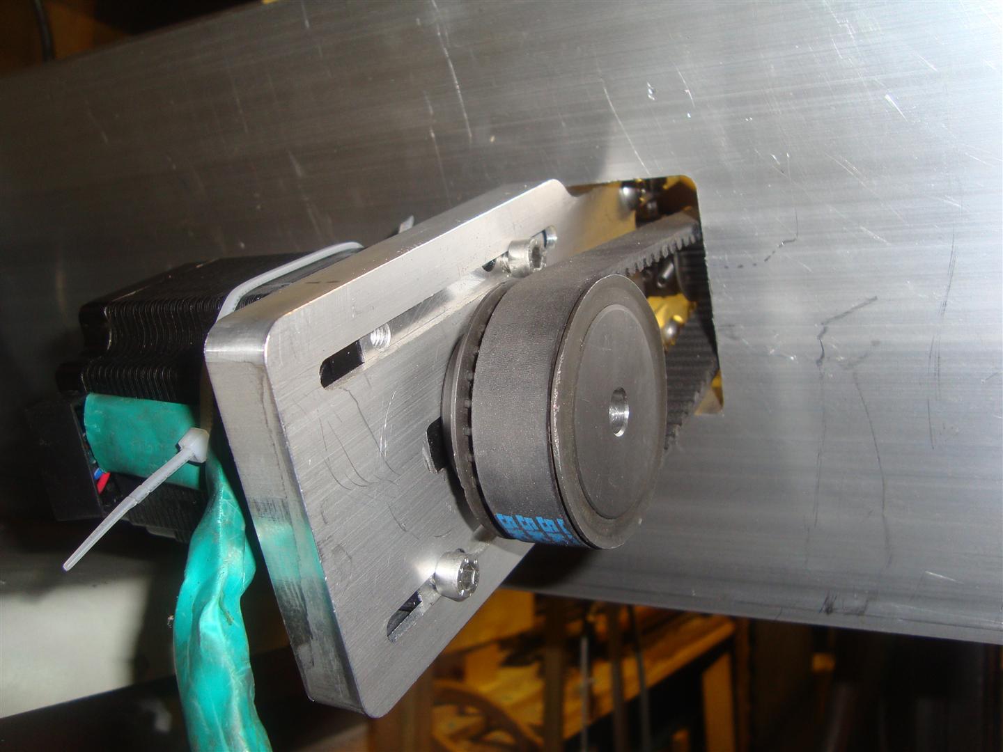

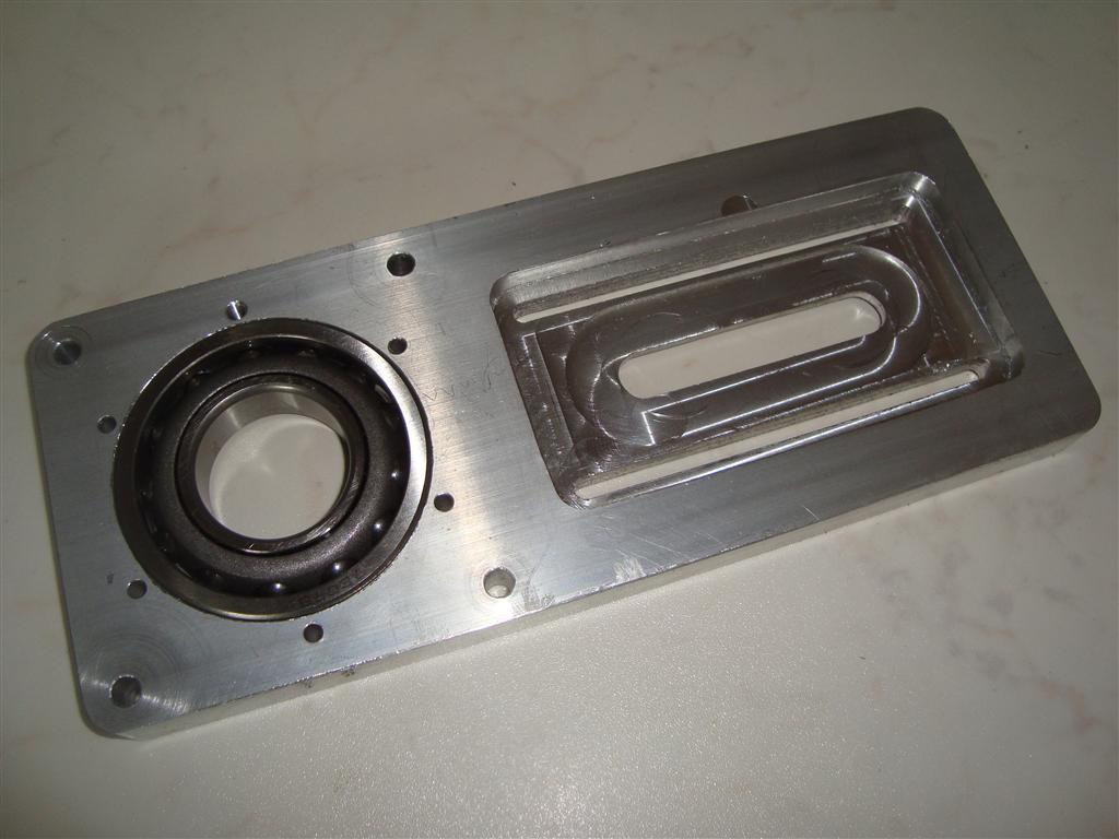

    As irving's said, recessing the motor mounts is an easy strong way to get round the short shaft problem, here's a few examples:

  2. #32
    If you're buying the Hiwin rails new then there's no need to get 20mm for this size machine - 15mm is perfectly good for the vast majority of CNC routers. This could help with making the Z-axis more compact.
    Thanks Jonathan... Pics really help visualise things... Looks to me like those mounts are milled down to about 3mm? Have you noticed you're missing a bolt in pic-1... or is that one an optional extra... Lol
    Yes something like that... you don't need much thickness if there's plenty of material around the motor mount surface to stop it bending. I missed two screws in that picture as it was just a test fit.
