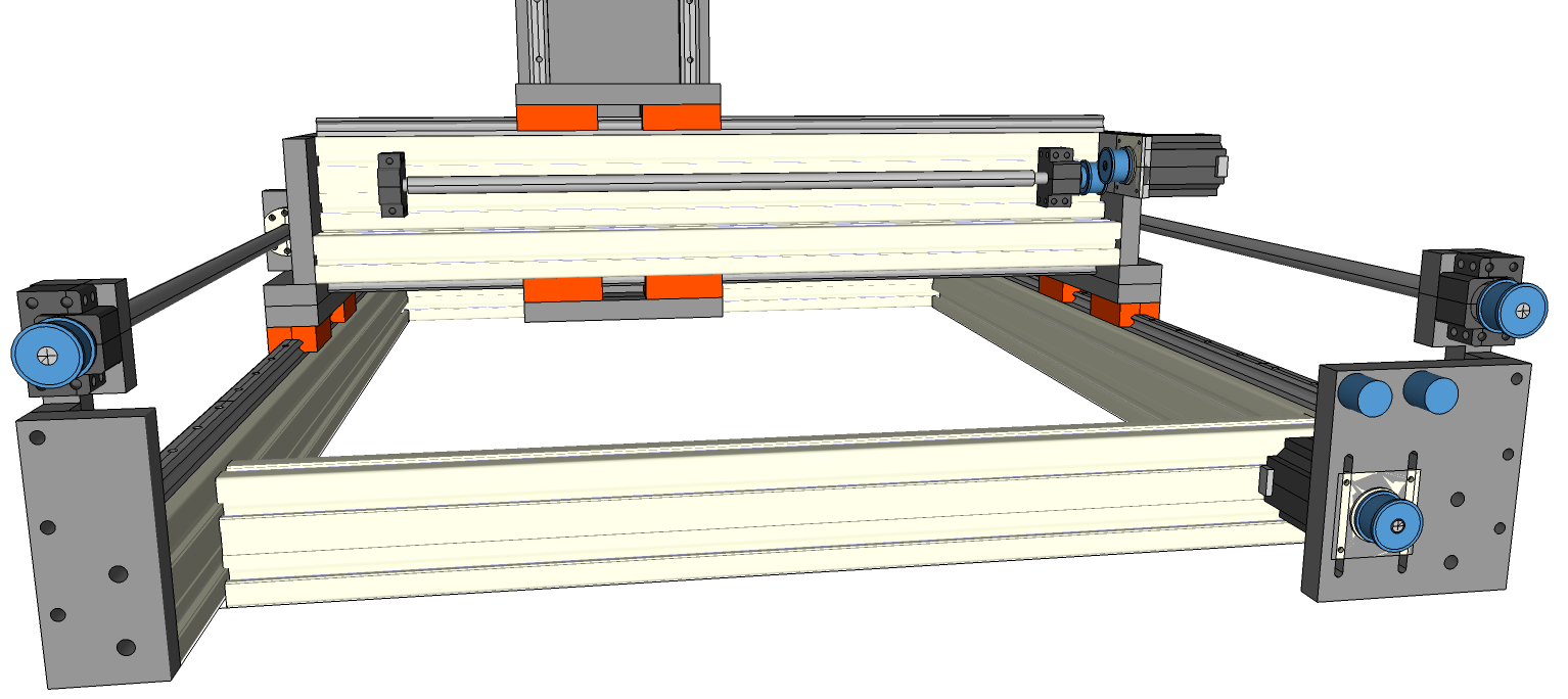

  7. #45
    Layout of the pulleys and belts (imaginative) for my X-Axis.... Pretty much as per normal recommendation I think, but have located the motor and idlers to one side as I want the bed to be unobstructed for passing through longer boards in the future when the sides will be mounted on an adjustable-bed steel frame, and the two cross-members removed.
    Please shout if the short distance between the motor and RHS ballscrew pulley makes it more difficult to align the teeth on the cogs or align the pulleys.
    Think I've found a use for MDF....... to cover the X-axis belts an pulleys!

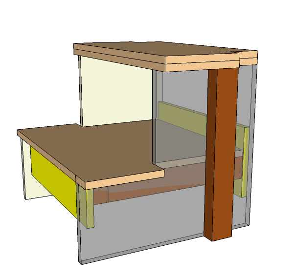

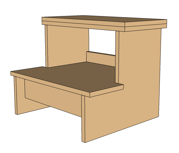

  8. #46
    Quote Originally Posted by Shinobiwan View Post
    Andy is that a fixed rear end bed?
    Nope Ant, my van has a double-bed/lounge at either end.
    I've thought about using that end as my "workshop", but am so non-domesticated that I can't be arsed making up the bed every day, so just leave it permanently as a bed... And will initially use the area depicted in red for the build.
    Doing a build in a caravan does raise some challenges... Later today I will be picking up some 18mm MDF (mostly cut to size) to make this little bench-let/steps/stool thingy that will be further modified with fence-like clamp thingies to help with drilling, tapping, and assembly.
    Getting there slowly....
