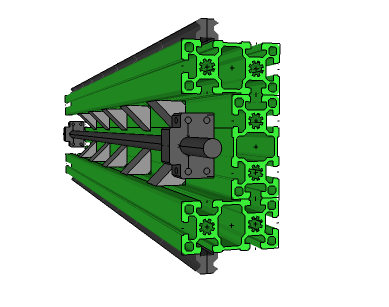

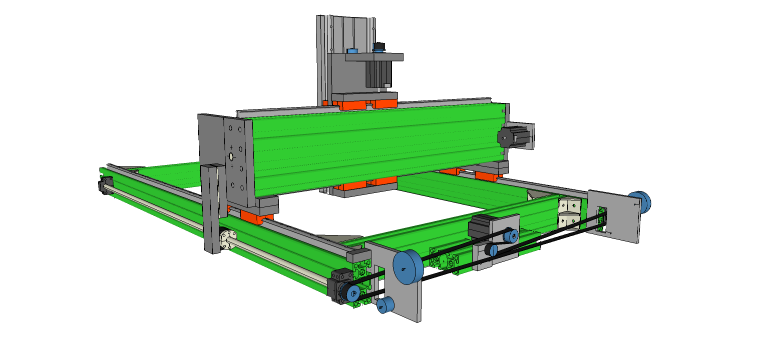

    Quick query on the adjustable recessed motor mounts that many folk seem to have machined.... I will be using Nema23 motors...
    Is 10mm plate sufficiently thick for making the mounts... and then having a border of 10mm wide left unmachined all around the motor sufficiently strong?
    Btw, for the counter-balancing I picked up some nice strong 60mm steel groove wheels from http://www.ebay.co.uk/itm/3209778190...84.m1439.l2649

    Quote Originally Posted by WandrinAndy View Post
    Yes it should be. I've done it by cutting a pocket for the motor into 1/2" aluminium, so the surface the motor actually rests on is only about 4mm thick, but the border is 12.7mm thick. This provides plenty of support without reducing the available shaft length.
