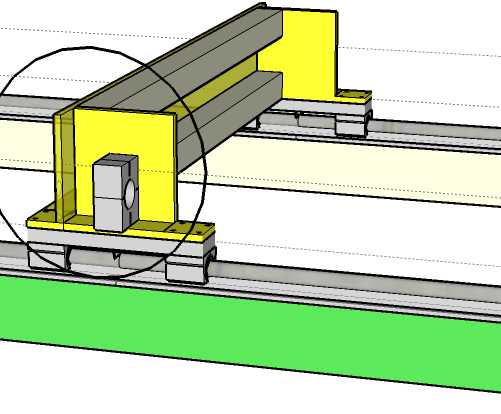

    I'm busy with my design and have a query that references aspects of some incomplete bits within the circle in the attached pic.
    The back part of the Y-beam and the top part of the X-carriage is going to be formed out of 152x51x9.5mm aluminium angle, which is coloured yellow.
    I had decided to put the ballscrew-nut housing midway between the X-bearings as depicted by the grey block, but am now wondering whether it might not be better to maybe beef up the end of the Y-beam, attaching it securely to the vertical angle on the X-carriage, and simply make that into a ballscrew-nut housing, which would result in more "direct" drive to the Y-beam? The fact that this is towards the end of the X-carriage may not be ideal, but would it be acceptable or likely to cause problems?
    Cheers,
    EDIT: Have now cancelled that idea and am going back to Keeping it Simple!

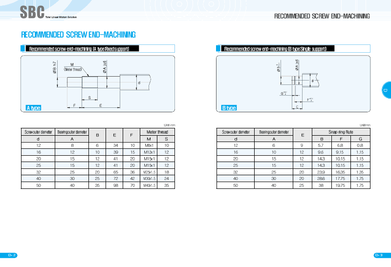

    Does anyone perhaps have a legible dimension data sheet for Chai's 1610 ballscrews?
    I have a copy off eBay but these old eyes canna read the dimensions even after sharpening and increasing the image size.
    Particularly interested in the BK12 and BF12 bits.
    Thanks,
    Here's the end-machining drawing I got from Chai a couple of years ago:
Name:	end machining.png
    Which dimensions do you need from the rest?
    Thanks Jonathan. I had already saved those up off a previous post of yours I think.
    I'm after the size of the BK and BF support blocks, and particularly the dimensions from the centre of bearing to each of the edges. My current design looks like too tight a fit for these blocks, so would like to know what I need to cater for.
    How do you guys normally accurately align the bearings and ballnut?
    I'm guessing I need to allow some leeway in order to be able to adjust during setup.... Is this normally done at the ballnut or at one of the bearings and if so which bearing?
    Found the dimensions I needed for the BK12 and BF12 mounting blocks.... they are 60x43 and the bearing centre is 32.5 from the base. So just the one remaining query:
    Quote Originally Posted by WandrinAndy View Post
    Yes some leeway is exactly what you need. Ideally you have 'leeway' in the plane perpendicular to the axis of the ballscrew, not just in one direction. So to answer your question, a bit of both. If you mount the bearings in slotted holes then that gets adjustment in one axis, to get adjustment in perpendicular direction you should be able to use the small amount of clearance in the ballnut mount to adjust the ballnut centre height, but clearly it depends on the mount.
    If one bearing is fixed, then spin the ballscrew so the ballnut is at that end, move it back and fourth a little to make sure it centers then tighten up the 6 ballnut bolts. Spin ballscrew so ballnut is at other end, now tighten that bearing mount so it aligns to the ballnut and the other bearing mount by default. If the ballscrew gets noticably more difficult to turn (by hand) towards either end then there is an problem with alignment, so loosen the nut/bearing depending and try again. A tiny amount of misalignment will impose a high radial force on the ballnut which well cause excessive wear since they're not designed to tolerate radial forces.
