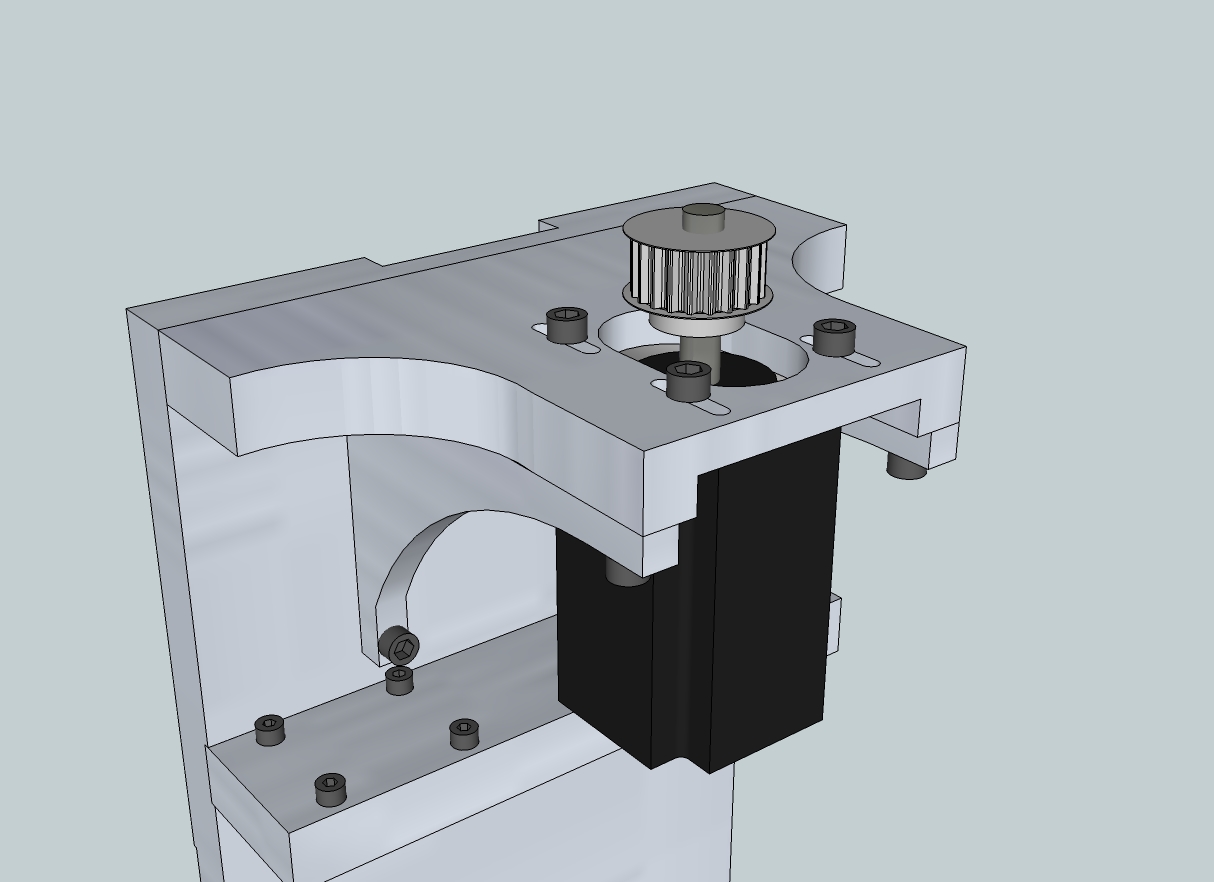

    This also allows different pulley sizes to be used without changing the belt, which could come in useful.
    Thanks Jonathan, good advice as I will be putting larger pulleys on the motor side. Now I can do it with the same belt.
    Yep going for Hiwin, as I can't find any suppliers of new THK or NSK. I'm using 20mm profile rails and the carriages have 4 rows of balls.
    I've redrawn the motor mount, but decided not to go with a full plate on the back of the z axis. Just extra weight for the gantry to carry. Can be easily added later if needed.

    15mm rails will be plenty strong enough. The load ratings of 15mm are several times what the machine will require... considering you were happy with round rails just a few days ago, I don't think there's much point using bigger than 15mm since the difference in stiffness between 15mm and 20mm profile rails is tiny compared to the difference between profile rails and round rails. Many much larger industrial machines use 15mm rails.
    Quote Originally Posted by Iwant1 View Post
    If you do add one it needn't be thick - 10mm would be fine as it's only to stop the joint between the plates that the Y and Z bearing blocks mount on bending.
  3. #23
    Know this is a bit late 3 weeks after posting but I've been asked for some input by Adil and was looking over the build again and spotted this comment.!!
    Jonathan never have understood why you use this rear plate in the way you do because that rear plate on the back add's very little protection against the joint between Y axis bearing plate and Z axis rear plate bending in the vertical.?
    The only forces that apply here are vertical force applied from one side and the overhang distance from the Y axis bearing plate to Z axis rear plate is nothing.? possibly few MM's. So the chances of that joint bending are zilch and if the forces were great enough to bend that then the rest of the frame and gantry are in big trouble and 99% sure something else would be bending/breaking much sooner.
    Your design is an open ended box with very little strength in the vertical direction and if enough vertical force is applied at one side the other side will deflect in a similar manner.!
    If you want to brace for that movement then plates on the side bolted into both plates would be much better and could be much thinner and still give far better bracing support than those backplates.? This back plate just add's weight and cost IMO for not enough gain and isn't required.!
  4. #24
    The back plate is there because otherwise the Y-bearing mount plates are effectively cantilevered, hence in my opinion it's worth having something to reinforce these joints. However I agree that plates on the sides, as you suggest, would offer much better reinforcement, but this would increase the width of the Z-axis and loose some travel on Y, assuming the width of the Z-axis has already minimised. The plate certainly doesn't need to be the same thickness as the other parts, it was just convenient for the one in post #20 since I didn't have much of anything less than 20mm in stock, plus it was an easy way to support the motor mount.
    Not really much of a cantilever is it at 1 or 2mm and still your not supporting the cantilever but have created double cantilever ~(see-saw with bearings as pivot.!) with no bracing support.!!
    Plate thickness doesn't matter could be 50mm or 5mm it's still adding very little vertical bracing support.? Plus it restricts the back side of the gantry so cable chain etc is more difficult to run.? . . . Like say IMO it's heavy, expensive, restrictive and unnecessary. . . Each to there own.!!!

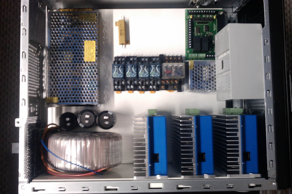

    So, while away all the bits and pieces I ordered arrived behind me. It was like Christmas, opening all the parcels. I loved it.
    Here are some pictures which I think will help others new cnc builders realise how many parts we need to buy.
    The first picture is my control box layout inside of an old pc case. 12v, 24v and 70v psu are here along with drives, safety relays, discharge resister, BOB and fuse box.

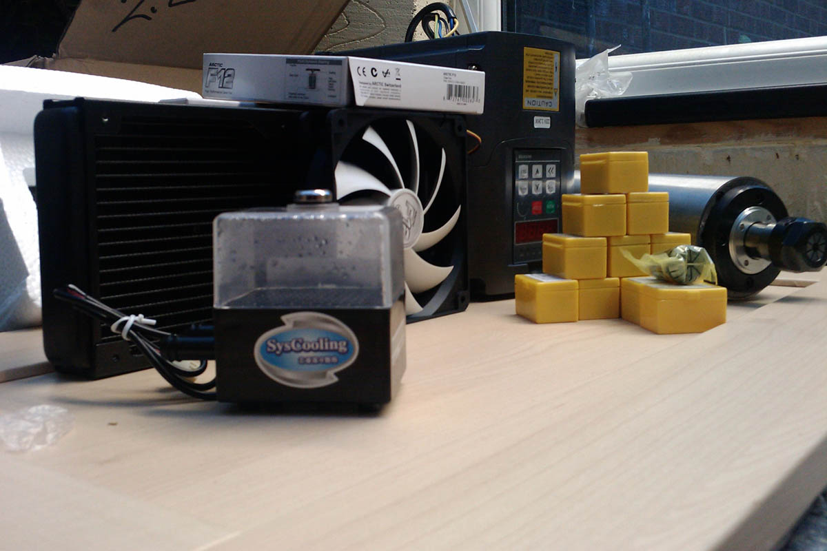

    My spindle and VFD were from Chai, unfortunately FedEX hit me with a 35 quid bill. I bought an er20 collet set, and full cooling setup consisting of double ali radiator, 2 fans, and a pump with reservoir. Just need to buy hoses and adapters. It was a great feeling powering the spindle for the first time.

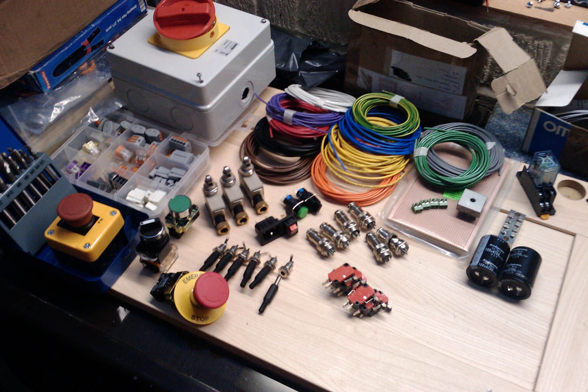

    This picture shows all the other components like switches, connectors, wiring, e-stops and lever connector blocks. Just forgot to put the cy screened cable in this photo.

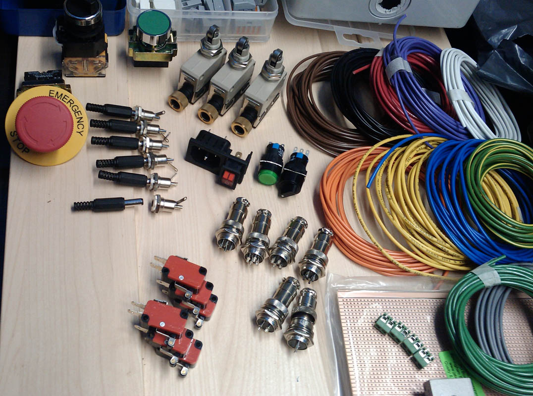

    Close up of switches and plugs. Andy, here you can see the difference in size between my 3 homing switches and 6 regular micro limit switches. The green push button is for the safety reset and round toggle switch is a limits bypass. The ones in the middle seemed a bit small so I bought larger ones which can be seen on the top left of the pic.
