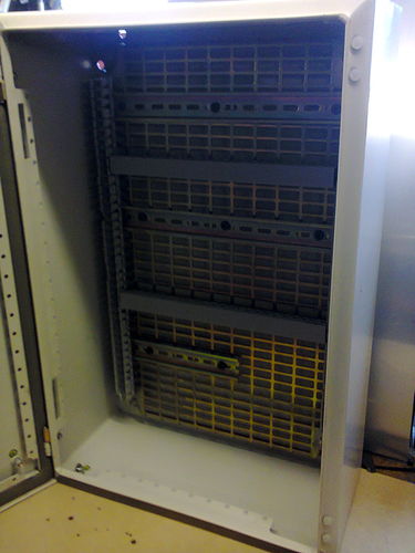

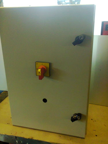

    Since I've decided to go with dual x axis drive, my PC case control cabinet is looking too small to squeeze another am882 driver in, and also the recent decision to go with an ethernet SS and PDMX 126 BOB. So another part on my shopping list was a PROPER control cabinet, which as of today, am the proud owner of a used 600mm x 400mm x 200mm electric enclosure with slotted cable trunking, on/off switch and safety locks. Bargain at £40 shipped. Everything should fit now considering its twice the size of my PC case.

    As for advice, DON'T buy any electrical components till your machine is built. Mine are just sitting there, eating up their warranties.

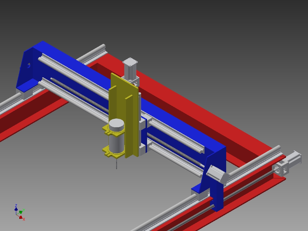

    I don't want to hijack this post but i have a similar design and I'd like to use your experience.

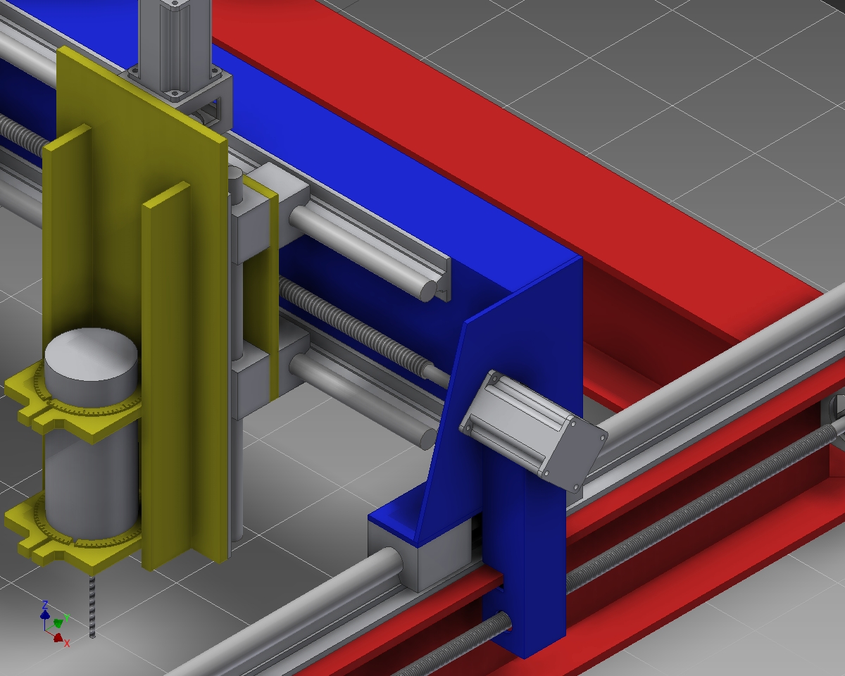

    I've designed the frame etc. in inventor and from the simulation i get deflections smaller than 0,015 mm with the force of 500N excreted on a tip of an end mill. Thus, the design seems to be sturdy and good enough but I'm waiting for any suggestions.

    Now your design.?? . . . You have a problem Houston (several actually).!!! . . . . but this one Is a common mistake easily missed.!
    The linear bearings on the Y axis can't possibly be fastened like you have them drawn.? Chicken and egg problem.!! Fasten plate on one set and you can't access the bolts for the other bearings.!!
    I'd also consider using different thickness material for the Z axis.? Those thin plates, even with the bracing will resonate while cutting which will affect quality of finish. Don't rely to heavily on the Cad simulation, without inputting all the variables and cutting forces then it won't show this. I know from experience that if you plan on cutting hard woods or hard material like aluminium then your Z axis just isn't strong enough.
    Just remember no matter how well built or how strong or accurate the rest of the machine is it's the Z axis that takes all the cutting forces
    and if this flex's or resonates the rest don't matter a jot.!! . . . The machine is only has good has it's weakest link, this Z design is weak.!
    ( Also Don't rely on the Linear rail adding strength they don't really add much.!)
