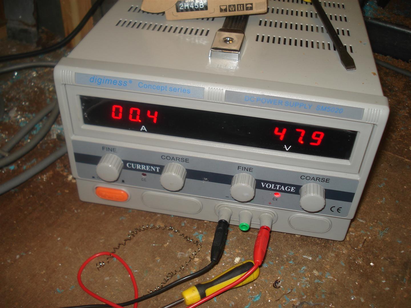

    I use the same one and it gets warm, but not hot or anywhere near it's temperature rating so I've not put a heatsink on mine. The peak current running through it is quite high, but here it's the mean current that matters (as that determines the power dissipation) and that is much lower. However if you've got a suitable heatsink lying around then you might as well use it.
    Here I'm running one stepper driver with a 3Nm motor at 4.09A from my lab PSU for testing, note the current:
