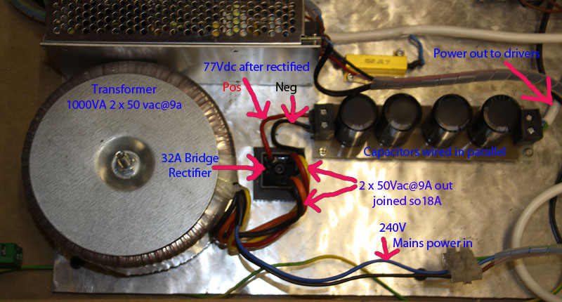

    Heres a pic of one (Big one) wired in parallel using 4 x 4700uf caps.!! ( Ignore the chocy block on the input that was a temp bodge.!) Click image for larger version.
    Has you can see nothing too it. . Simplizzzzz.

    You don't need or want 1000Va for 68V-ish @ 12A 625Va will do fine.
    With toroidal setup You only really need about 68% of total motor amps so 12A will be fine for 4x4.2A motors.!
