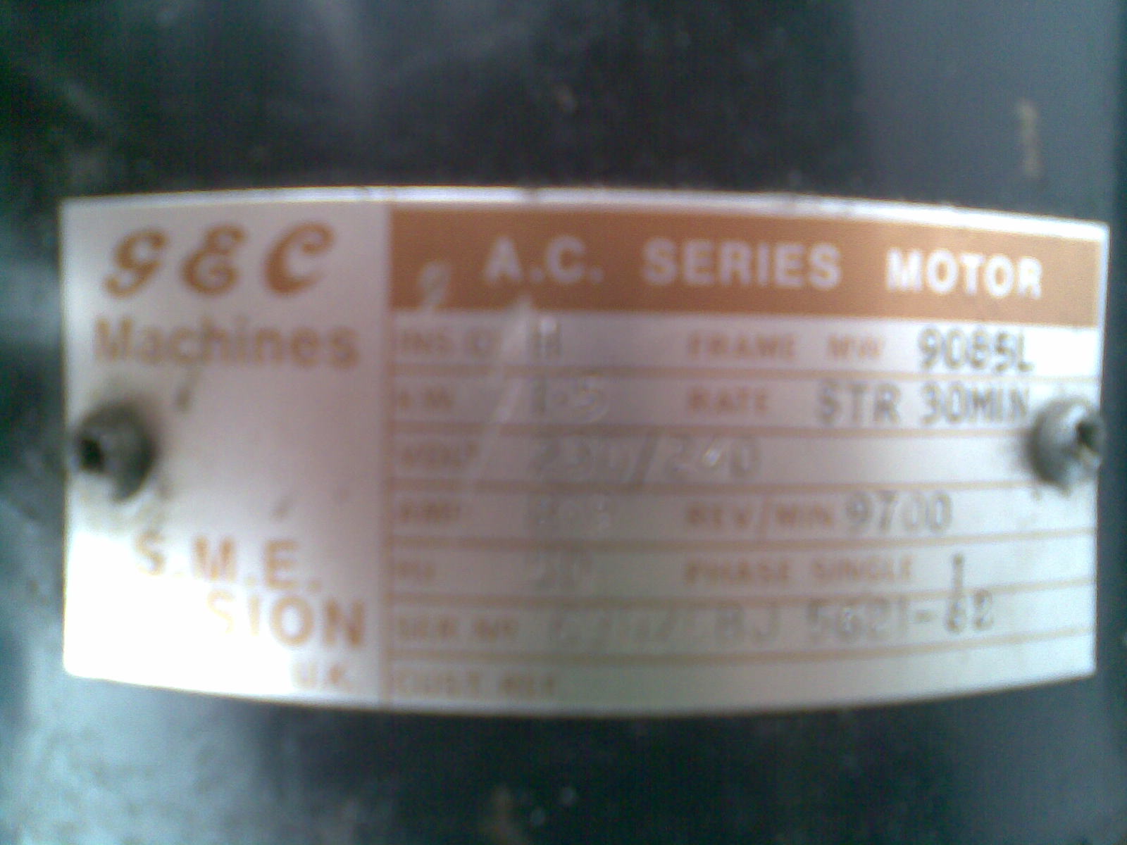

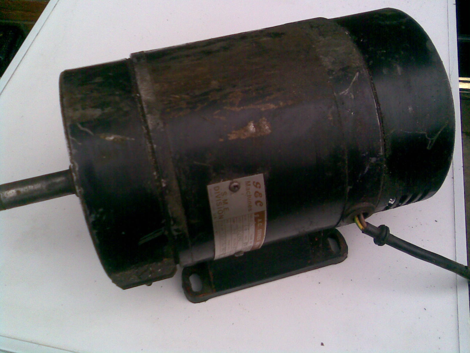

    well... here are some pictures of the motor in question
    picture quality isn't great as the only camera i have is my trusty but outdated nokia 6300

    just noticed that the pic of the spec plate is indecipherable so i wrote down what it says
    G&C machines
    S.M.E. division
    made in the uk
    AC series motor
    INS. CL h
    KW 1.5
    VOLT 230/240
    AMPS 8.9
    HZ 50
    PHASE single 1
    REV/MIN 9700
    RATE sfr 30 min
    FRAME 9085l
    SERIAL NO. 630 cbj 5621 82

    It'll be some kind of commutator/brushed motor, not a standard AC induction motor.

    I've got to admit, I'm struggling to think of anything that would need 1.5kw (aprox. 2hp) at that speed, or what you could use it for!
  9. It sounds like a series wound ac motor / universal motor?
    open it up, so see it the armature and the field are wound in series?

    Since its limited to 30min operation, I'd hazard a guess at some sort of cooling/pumping/extraction process.
