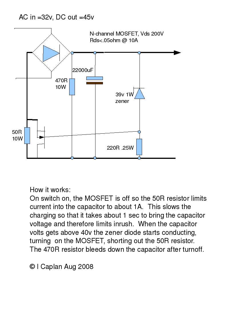

  6. I have been experimenting with this circuit as an alternative to my Thermistor/Relay inrush limiter
Name:	inrush limit2.jpg

    That looks interesting.
    I did consider something similar, but using a relay.
    However, making the voltage sensitive switching is a bit beyond my electronic abilities, so that's why I was considering using a relay.
