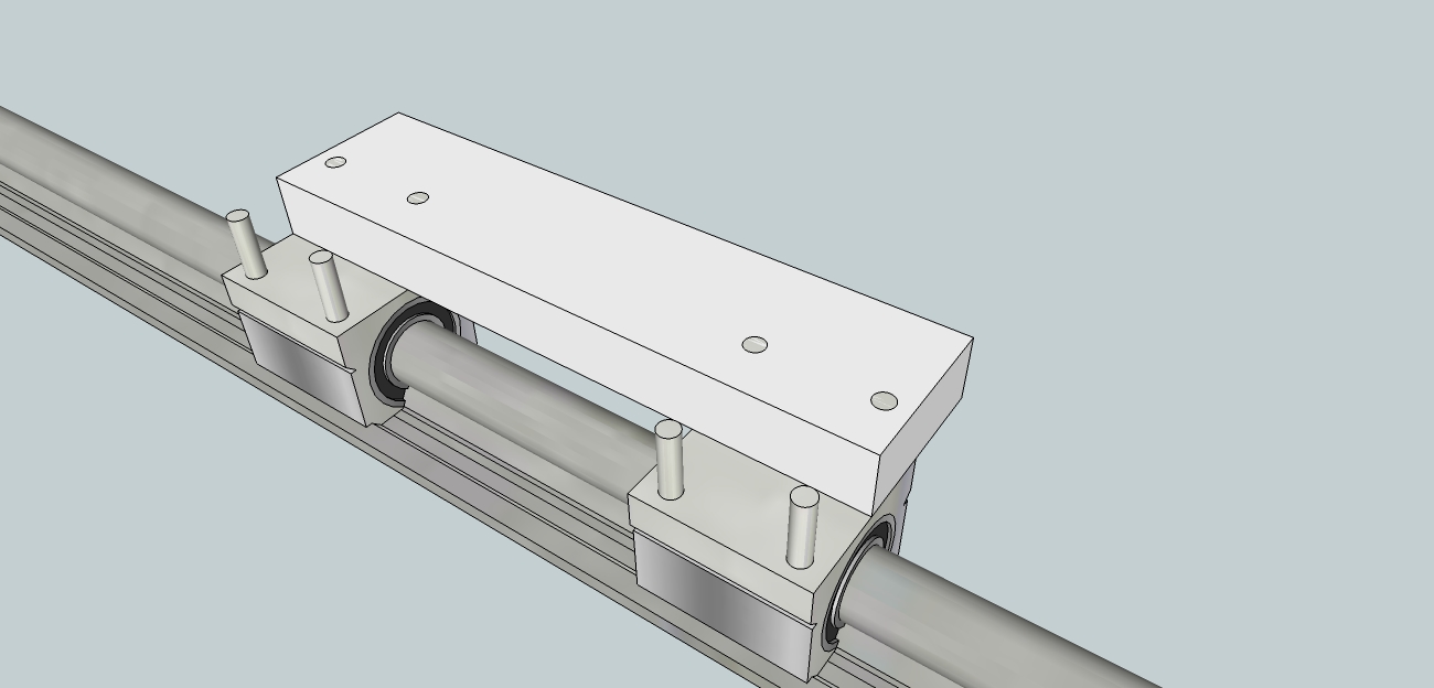

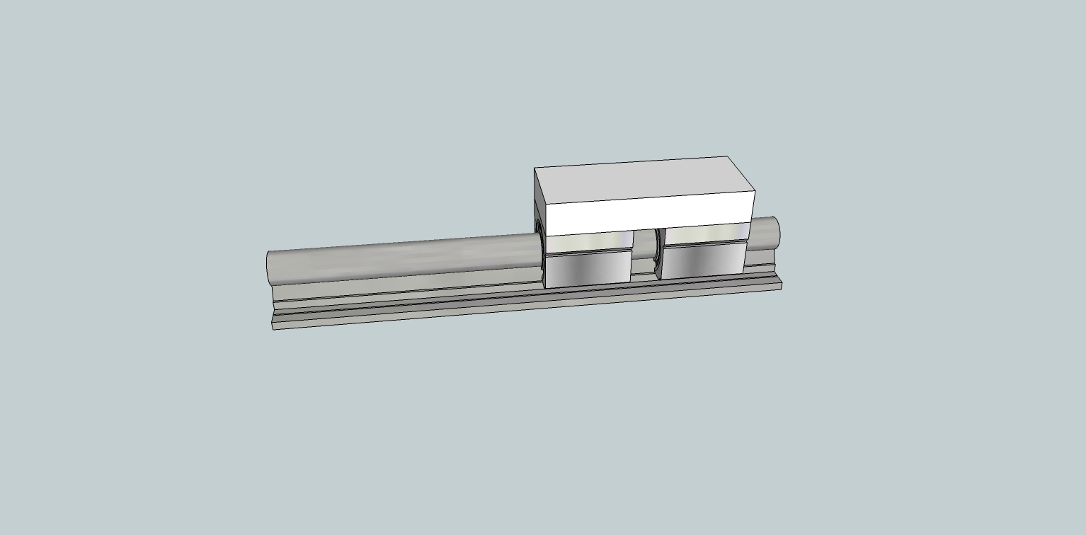

    How do you transfer bolts holes from 1 piece to another so you know they will line up. For example you wish to bolt a section of ali plate to the rail bearings. I could then print that part out to full size if possible and use it for marking out etc.

    I would group the ali plate then move it to one side. Next, double click into the bearing block group and use the circles already on the bearing block and pull them up say 20mm or whatever thickness ali plate you're using, such as this:
Name:	making holes.jpg
    Now get out of that group and get into the ali plate group, select the circle tool, hover around the perimeter of those circles you just pulled up, you can just about see them on the top of the ali plate, then move the cursor into the centre of the circle. The tool will automatically find the centre, click once then move to the rim of that circle again and click again. That's your circle done, now you can use the pull/push too to push it down 20mm. This gives you a matching hole through the ali plate

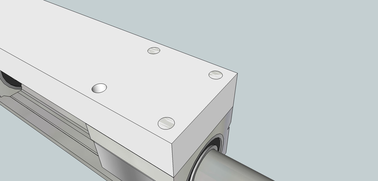

    It still won't look like a hole because of the pull up from the bearing block. So get into that group again and push the circle down by how much you raised it. you should get one hole looking like:
