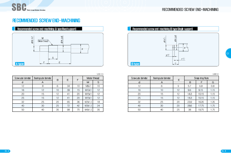

    547mm is the overall length of the ballscrew including end-machining. So since the ballnut is 42mm long and the end machining is 44+12mm, that leaves 449mm travel. Realistically a little less due to the seals and stuff getting in the way. Here's the end machining drawing to help work things out:
Name:	end machining.png
    Also, if you do decide to get pulleys I advise getting dimension F increased from 15mm to 25mm to make it easier to fit and align the pulleys.
