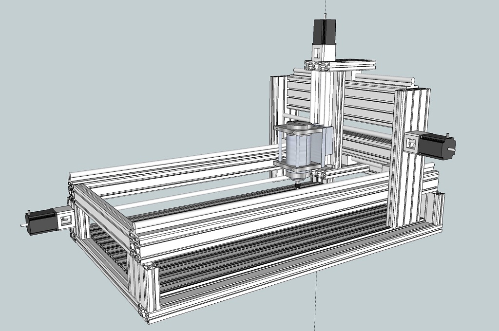

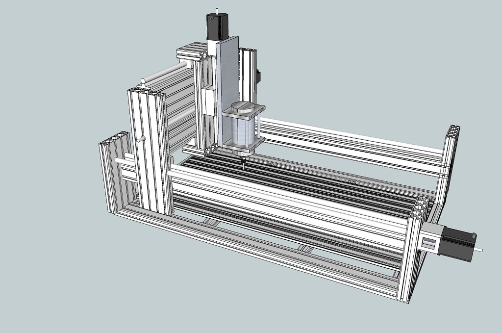

    Here's where I got to before your latest comments came in - also threw some nema23's and a spindle on there just for show and the x axis one will likely go on the corner with a second ballscrew on the other corner linked by belt or chain.
    Maybe a silly question, but is the tool chatter etc linked to harmonic resonance in the frame essentially and if so would assymetric mass damping help i.e. attaching weights to the extrusions in irregular places to stop it singing like a tuning fork?

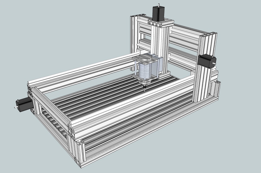

    Gentlemen,
    Another configuration for your consideration - I think is what you guys were on about getting the gantry sides "shorter" by putting the Y axis on top of the x axis bearings. I guess the trade off will be the Z axis being longer below the y axis rails?
    Will probably move the x axis nema and ballscrew outside of the gantry "legs" so if needed I can support the beams the x axis supported rails are sitting on.

  4. #14
    Much much better and far stronger regards the frame and gantry. Yes bring the ballscrews outside the profile has this will make it stronger still not only allowing supports but brings the screws closer to the gantry and X axis bearings.
    I would re think the Z axis as that's very limiting how you have it designed now.? Look around the site and you'll see much better setups.
  5. #15
    I know you want to get value for money on the Z axis screws and slides, but there really is no point lifting the head by much more than the distance from gantry to table. I suggest you could shorten the stroke and make everything neat and tidy.
  6. #16

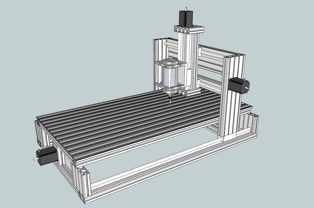

    Latest pic:
    Moved the rails on the Y axis to the top and bottom of the gantry (thanks Mocha) and I assume that was what you also meant Jazz.
    Thanks Robert - I have my eye on a set of ballscrews that are 1050mm, 550mm and 350mm currently (machined), so the frames/axis are kind of sized to match. I might rethink that though when I have the main structure layout set.
    This is all extrusion currently, but if its sufficient to cut plate then I'll make some replacements for various bits once its up and running. I'm also a bit concerned about the rigidity of the extrusion couplings (I guess I could add some structural epoxy to help with that also, as it seems to work for Lotus, Jaguar and Aston Martin to name a few ;).

  7. #17

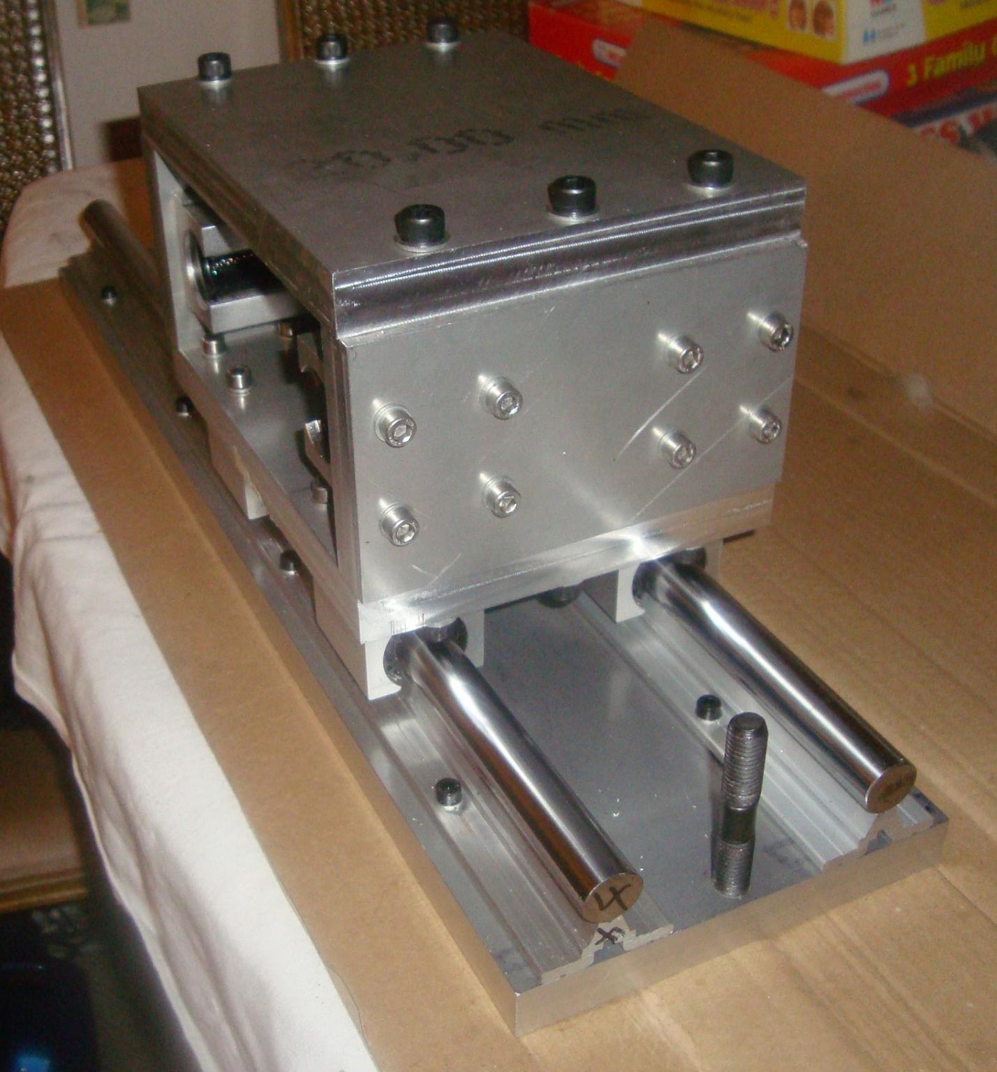

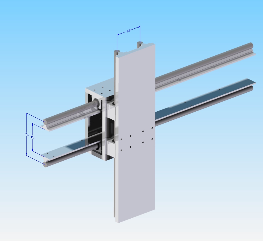

    Jazz will have meant putting the Z-axis rails on the plate that moves up and down, not the bearing blocks. Like mine (old picture):
ID:	6447Click image for larger version.
    However you do it, as Robin said, with the short distance between the chuck and the bed there is no need to have so much travel. You're much better off spacing the bearing blocks out further on the linear rails (this sacrificing the travel) since this reduces the magnitude of the force on each, leading to higher stiffness.
    Yes, that or avoiding symmetry in the frame can help to prevent resonance issues.
    Bear in mind Chai (linearmotionbearings2008) on eBay will cut and machine them to any length you want and the price is just based on the length so there's no need to stick to a particular set of sizes just because that's what he's happened to list on eBay for someone else.
  8. #18
    Latest pic:
    No not at all like that.! . . . I was talking about the X axis ball-screws and a completely different Z axis design not rail placement.
    Not got time to explain now but will do later if you like or someone doesn't beat me too it.!
  9. #19

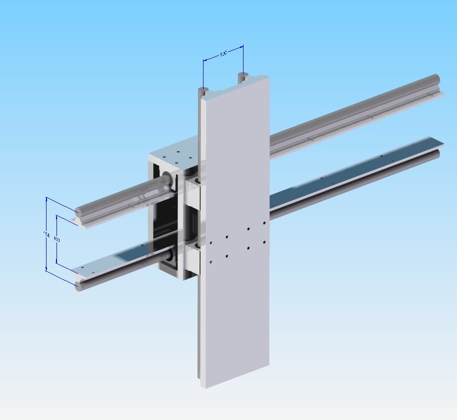

    Ah thanks Jonathan - that makes sense and gives a lot more clearance under the gantry. Questions though:
    I thought having a narrow Y axis rail spacing wasn't desirable due to the leverage that can be applied when under x axis cutting motion? Sorry - I see you already addressed this in your reply....
    Also, how do you mount the setpper motor on that design - between the rails on the back of the plate?
    @ Jazz - no worries, forums aren't the best medium for communicating or understanding design concepts - shame there isn't a fag packet app built into vbulletin ;) If/when you have time to explain I'd be more than grateful for a longer explanation and I'm happy enough to work in the 3d virtual world (it's cheaper) whilst I learn the concepts.

  10. #20
    Here's the latest iteration - changes are:
    - Re-structured the Z axis to kind of match what Jonathan showed in his photos and some general tidying up in that area.
    - Made the corner posts on the bed taller and moved the x axis ballscrew assembly to the same height as the rails and outboard (did the same on the other side as well to keep a dual ballscrew option open).
    Still to do - add in the bearing pillow blocks, which will probably mean some changes to some areas to accomodate and anything else I am missing, once you guys have finished ripping into it
