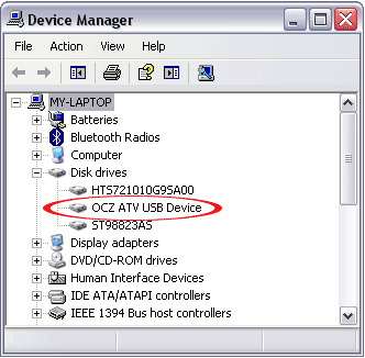

    Now click your windows start button and go to: Start-> Run and then type in "devmgmt.msc" then click the "ok" button. Now expand the "Disk Drives" menu, then double click on the USB Flash Drive you would like to work with.

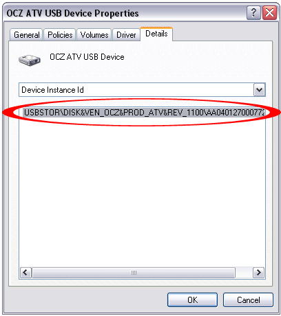

    From the "USB Device Properties" window that opens, click the on the "Details" tab, now select the entry listed as the "Device Instance ID" and then press "ctrl+c" to copy the text to your clipboard.

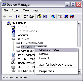

    Now click your windows start button and go to: Start-> Run and then type in "devmgmt.msc" then click the "ok" button to get the "Device Manager" window. Under "Disk Drives" locate and "right-click" the USB flash drive you would like to work with and select the option to "Update Driver".

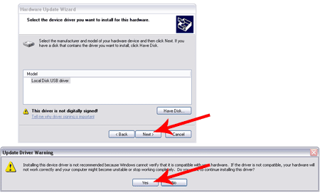

    You should get a "Update Driver" warning, just click the "Yes" button to that. You should get a warning that the driver is not "digitally signed", thats ok we know why, just click the "Next" button for that as well.
