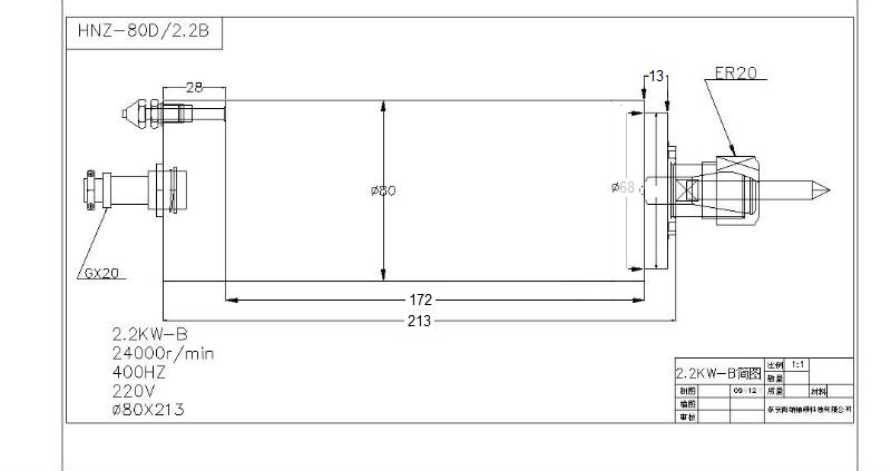

    Quote Originally Posted by BikerAfloat View Post
    Hi All,
    I'm after drawings for both the 1.5 & 2.2 kW Chinese spindles if someone has them, could you post them for me please?
    Cheers,
    Geoff.
    Thats the best i can do so lets hope someone else has the other...

    They do vary a little. Just had mine out of the spindle mount anyway as I'm investigating dynamic balancing and it's slightly different to that drawing. The main body is 80mm diameter for 200mm, then 11mm more at 68mm diameter, then the chuck protrudes by 39mm. When a tool is installed you need to add about 8mm to the length to account for the collet nut. It shouldn't make much difference to the Z-axis design...

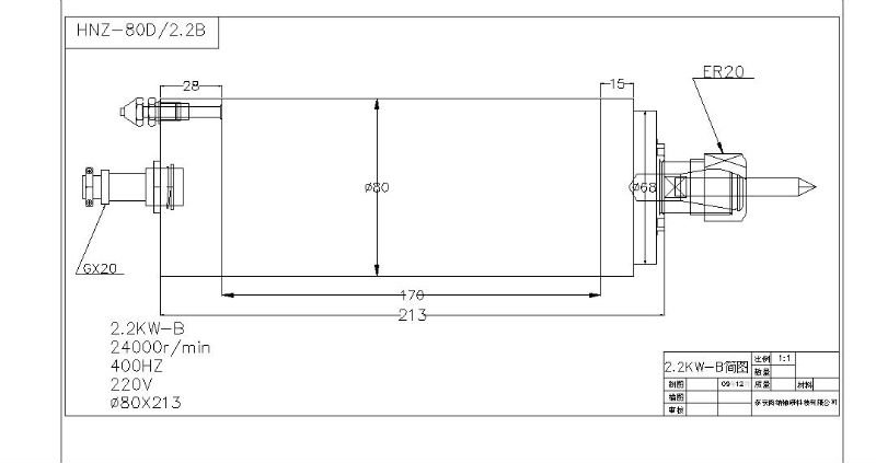

    The drawing has a few innacuracies in it and in fact is the same size as yours i suspect, take a look and see if you can spot the mistakes..lol
  6. #54
    Thats better..

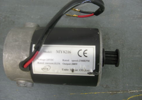

    A 24v 200w electric scooter motor:
    e scooter electric 24v 200w Motor belt drive escooter | eBay
    It has a what seems like a "too good to be true" new price of just £26 on eBay and from the size of the wires is relatively diddy. It gives 2700rpm, which is in the right ballpark now! Presumably these are man enough, they lug humans around!
    Main concern is with Duty Cycle, any thoughts?
    So...
    ER20 Long shank collet roughly £20
    2 x 6004 2RS Bearings £10
    Scooter motor £30
    24V 10A Power supply roughly £30
    Some pulleys & a belt say £30 all in (Might even have some suitable somewhere in Dad's shed
    Might have material for holding bearings and making motor mounts
    Downside, simply cos I wanted to do this myself...
    Would need someone to do the machining for me.
    With stepped pulleys, I guess wiring the motor direct to Power Supply with a switch and a link to the machine E-Stop would be fine.
    £120 say £150 tops, definately do-able, especially as it would be close to "best practice" for metal.
    Obviously collets to get as well, but since it's ER20 only 1 set needed if I go 2.2kW WC eventually.
    Any ideas for a 240v motor, minimum power and so on?
    or is the Scooter motor idea viable? Bearing in mind Steppers are also often run this way!

  11. #58
    I'd look for a DC tread mill motor far more powerfull with good duty cycles.!
  12. The Following User Says Thank You to JAZZCNC For This Useful Post:
  13. What an excellent idea Jazz
    Plenty on eBay for <£30 I can rob power supplys, motor & speed control from a complete machine!
    Gonna check Freecycle to!
    Cheers,
    Geoff

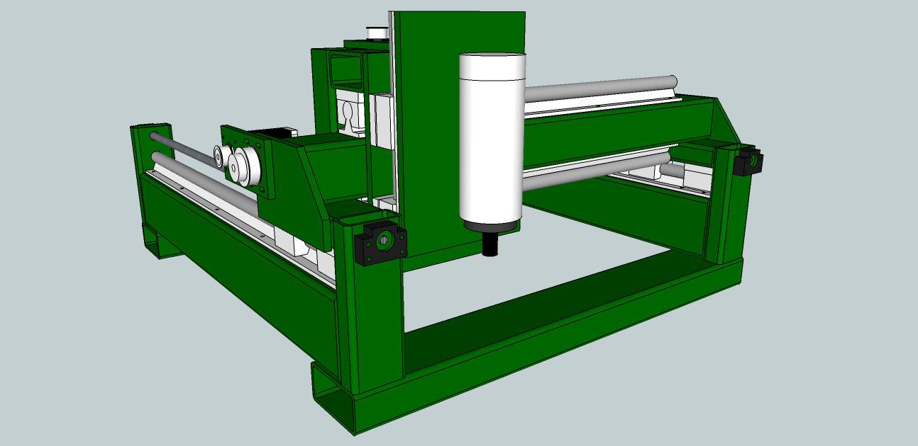

  14. Hi All,
    After some more reading and some hard thinking, here is the Mk2 machine (progress so far):
Name:	Steel Box Machine Development.png
    Went back to the drawing board completly, re-assessed the space and scaled the machine to what I think I can get away with, rather than basing the machine on the A3ish size previously.
    Ive used 5mm Wall Steel RHS as that should be good for the tapped threads to hold down the rails.
    Bottom Cross members: 120x60x870
    X Rail Supports: 120x80x900 with 900mm SBR25 Supported Rails
    Ballscrew Supports: 80x40x220
    RM1605 Ballscrews on all Axissss.
    Gantry "Feet": 80x40x200 5mm Wall Steel RHS with 2 x SBR25 Bearing Blocks
    Gantry Cross Member: 80x80x870 with 2 x 700mm SBR25 Supported Rails, top and bottom.
    Y Axis Ballscrew Supports: 10mm Thick Steel plate
    Z Axis Plates: 12mm Thick Steel plate
    Z Axis Rails: SBR25 Support rails 300mm long
    That makes travel roughly X=780, Y=480, Z=100
    Y & Z are driven by 2:1 Belt drives, for the X Axis, I am considering a single belt, 3 pulleys and 2 idler bearings also at 2:1 reduction
    That's a 2.2kW watercooled spindle on the Z, though I'm also looking at the Treadmill motor option for low rpms. Just waiting for a suitable treadmill motor to appear on eBay!
    Problem with this machine is I'll have to "borrow" a mates workshop to build the frame and pay someone to make some of the other components as they go beyond my skills and equipment, ho hum, not the original plan, but I'd like to build just 1 machine and have it last me.
    As you can (probably) see in the image, the Spindle comes outside the X Axis, I have left this as it gives me good travel over the steel box which I plan to use for a base for machining metals.
    Most likely welded construction, though bolts still hold some appeal for maintaining a "I built it myself" perspective...
    ... Just noticed I will have to bolt on the Y axis leadscrew/motor mounts, otherwise I can't get the leadscrew in!
