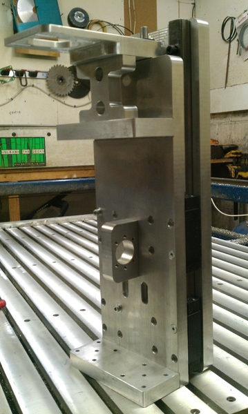

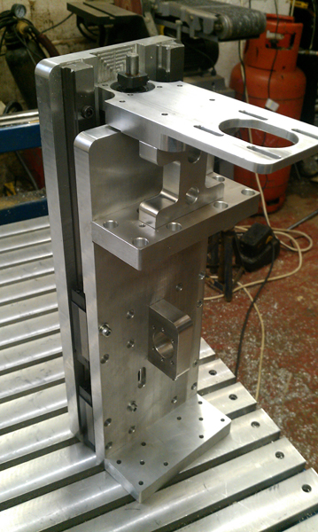

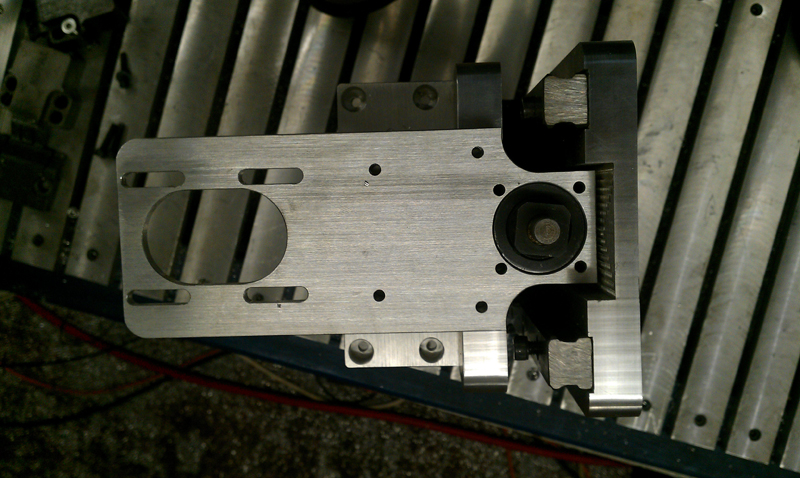

    Just spotted something with Z axis.?
    I you take the motor off the front plate and position it on the Y axis then connect to Z screw with belts you get far better Accelleration from the Z axis. You also don't need long screw and you get the other bennafits of belts I mentioned earlier.
    My setup used the way you have it drawn but I now build all machines using the system described above and can tell 100% it's a much better setup.
    Edit: Like these pics. Obviously done to suit your machine with round rail, which actually makes it easier.!

    Trust me :) the X axis dosnt hit the motor ( always thought the longest axis was the X ? .... theres a fight waiting to happen LoL ) the belts long enough to run under the gantry.
    I ve seen your Z axis Jazz and did draw it up like yours but left it as it was made out of more parts and the pulleys made the router plate hang further from the gantry. I think il have to give in and sort the belt drive on the Z axis , i did think i was heading this way , with the 1:2 ratio.
