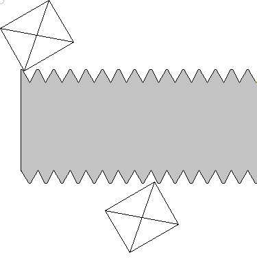

With both the motor selection and drive mechanism, in the end either system is fit for purpose so there's no point in me suggesting that you should use one or the other. What is worth suggesting though is if you do stick with trapezoidal screws, then consider substituting the nuts for the 'wonky bearing drive nut' method I started out using:
Name:	wonky bearing drive.png

Very low backlash, low friction and I bet you could make it with hand tools. There's certainly room for improvement on my design, some of which is discussed in my build log.
