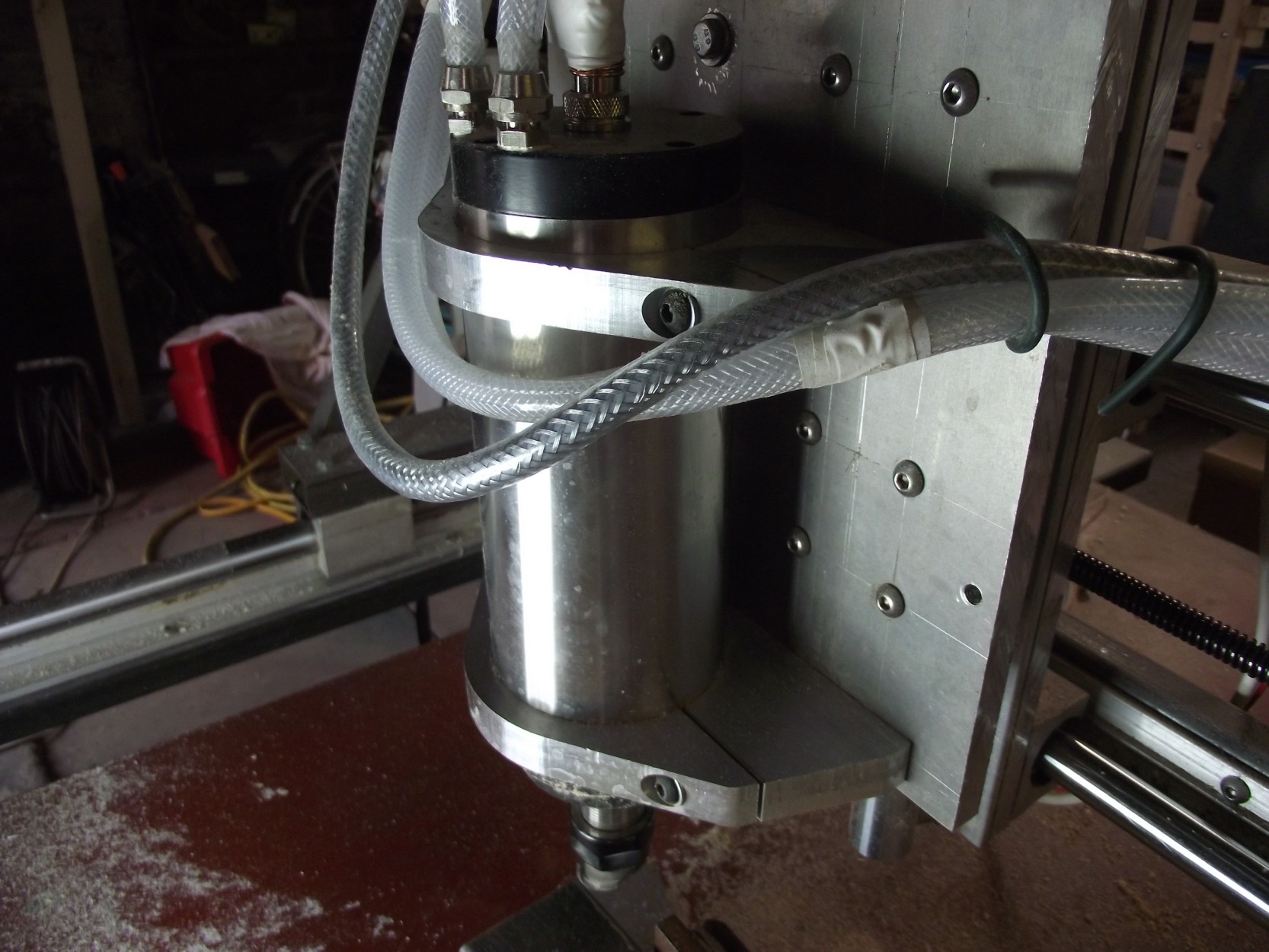

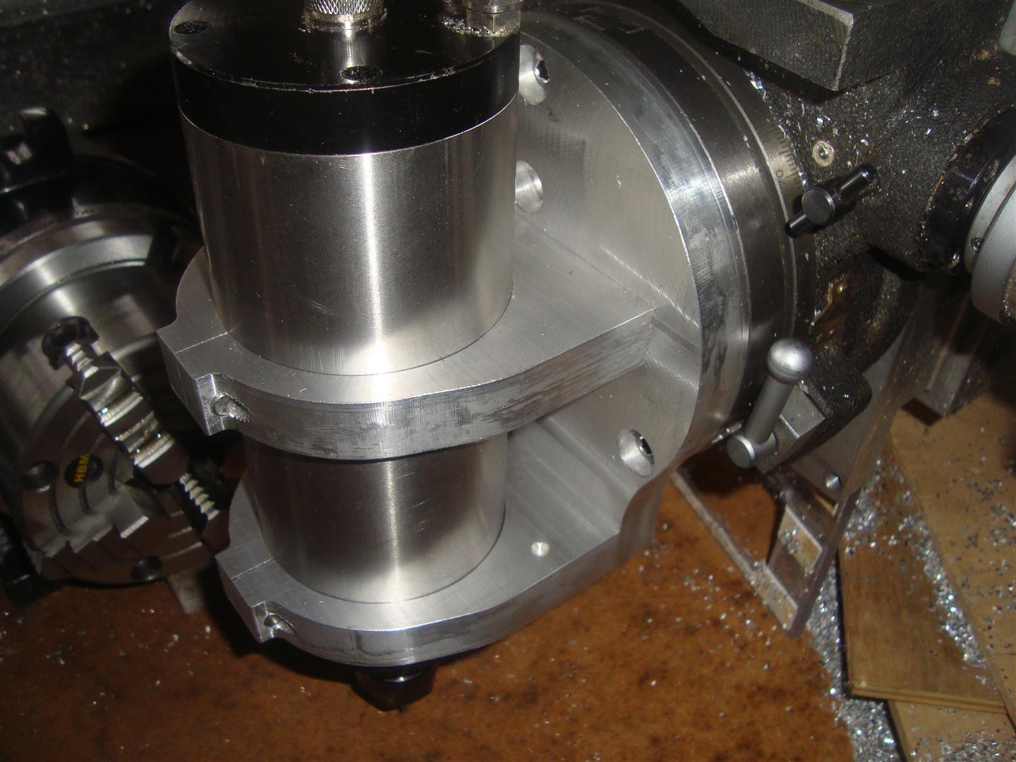

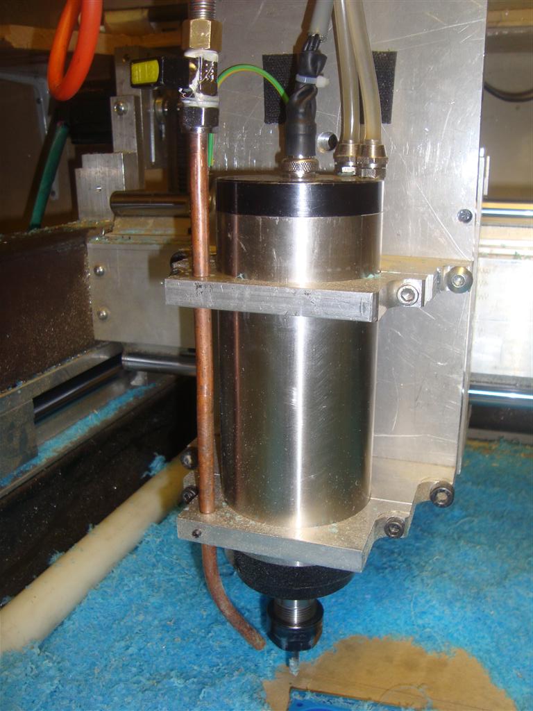

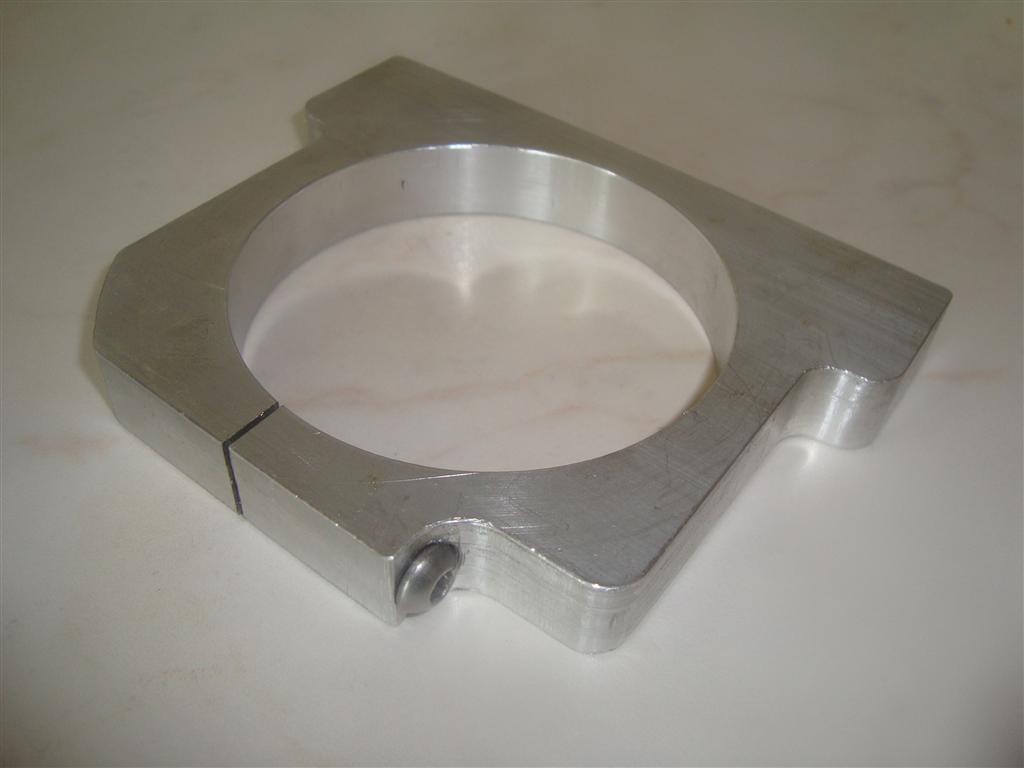

    7) Here's one or two I made earlier:

    I'd advise using 1/2" thick aluminium.
    Problem with that one is it only takes ER11 collets, so you're limited to up to 7mm cutters. That's one excellent reason to get the 2.2kW spindle - it uses ER20 collets which accept up to 13mm tools. Bear in mind several sellers here have used 'best offer' with these spindles to get them cheaper.
