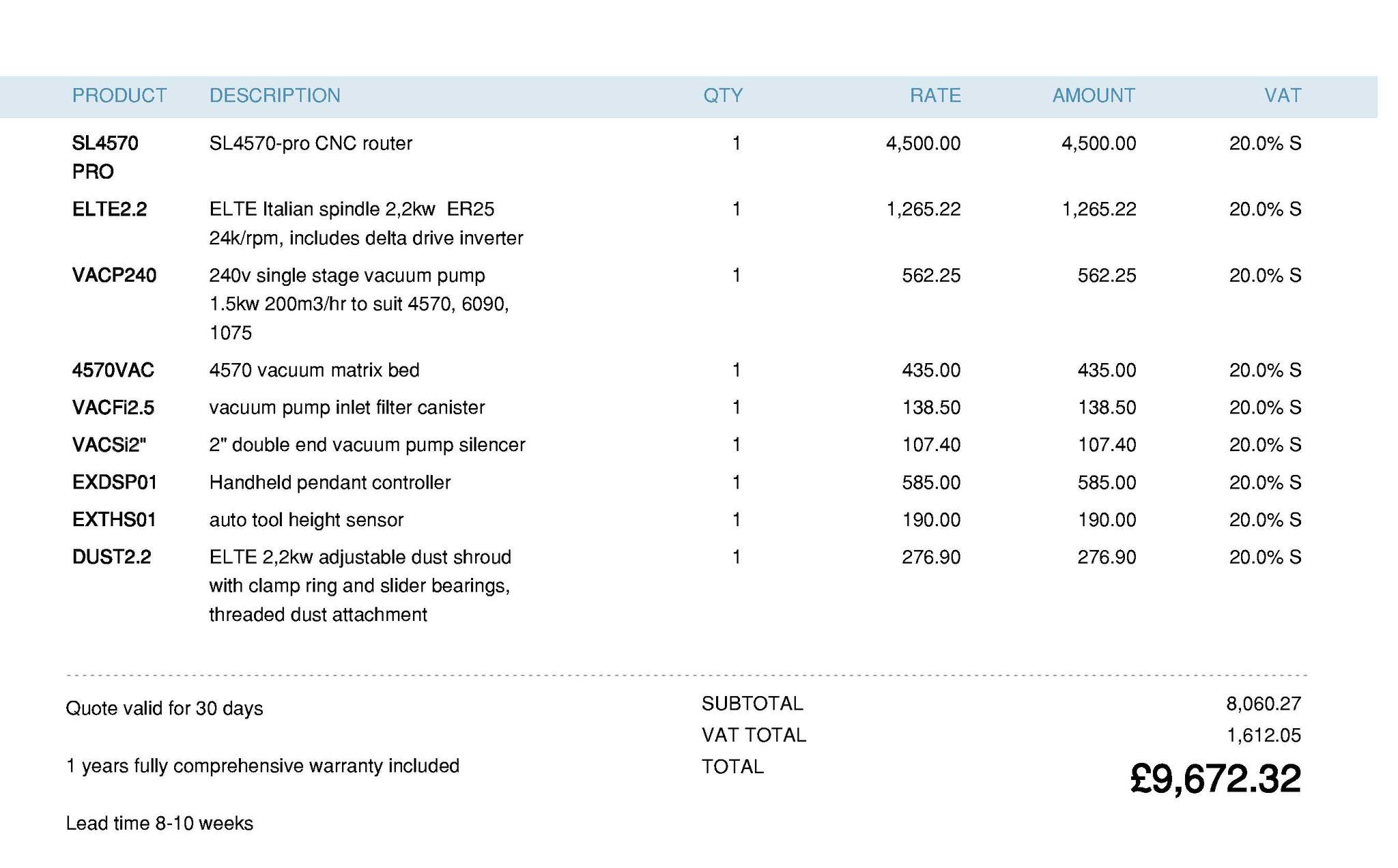

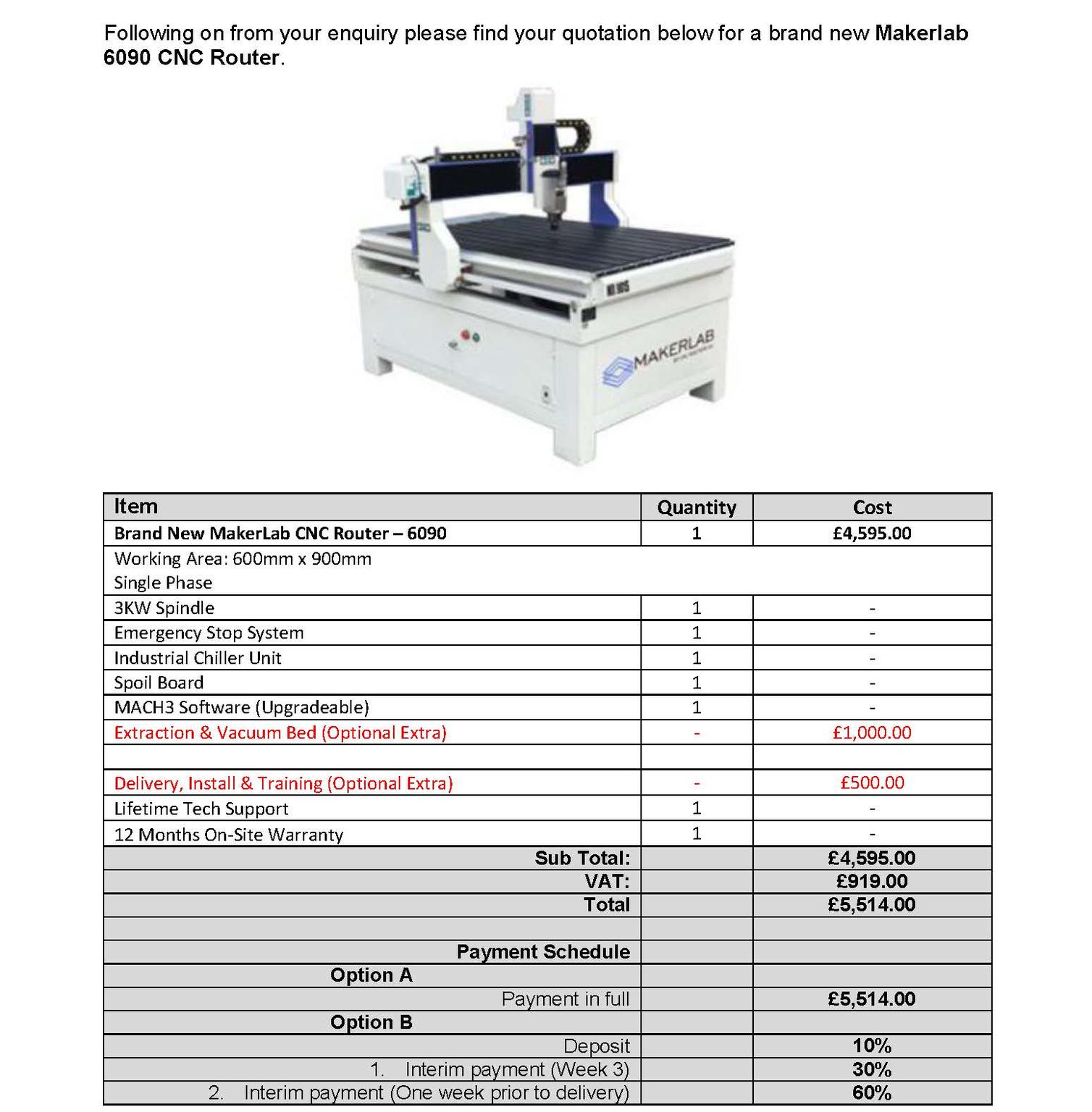

    As previously mentioned I've not really got the time to learn how to build my own machine and would much rather spend what time i do have on learning how to use a pre built machine.
    Ideally with a minimum working area of 450mm x 600mm, Machining various hardwoods and plywoods, I would like some sort of dust extraction, either built in or a way to connect my existing extractor to the machine. Also, the machine would not be running all day every day with heavy usage.
    The software I've got a bit experience with is Sketchup & SolidWorks, and more recently Shaper3d on the Ipad Pro.
    Fusion 360 as also been recommended to look into by mekanik on the forum.
    Budget wise I like good quality tools, but I don't want to break the bank on this! I've had two quotes from two different companies that I will attach below.
    I would rather not spend that much if there are better value/recommended ones available?.

    Have you looked at any of the Chinese machines? Not the cheap end of the range, but some of the bigger machines? A friend bought an Acctek 6090 which he is using daily in his business and which seems to do a reasonable job. It has quite a few rough edges (literally, in some cases) and needed a bit of tweaking to get it running when it first arrived but it's steel and cast iron with profile rails and ballscrews. All up including shipping (he arranged his own), a 3HP water-cooled spindle (about right for this size machine), and USB motion controller, it was around £3K. The difference buys a lot of cutters and material!
    I'm not pushing this specific machine or maker but something like this might be an option worth considering.

    5k is not unreasonable for as machine. The other one is expensive. No need for fancy spindles when the Chinese spindles do the same job.
    Now there is that thing that for that money, me or sb else could build you a machine with better pro grade controller, better drives and motors and much more capable. In fact the first one is just re branded Chinese machine. I hate things with inherent design flaws, and if it was me i couldn't live with such a thing, unless i dont have to.
    yes, some things the chinese machines have better priced than what i can do for the money, like the working bed and ... what, nothing else
    And about the support: Wait, what i have build the only support that it needed was sorting Windows bugs
