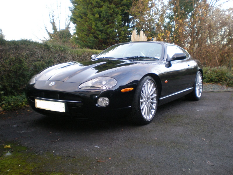

    Also some contribution - I have been a member of and absorbed a bunch of information over a number of years from www.detailingworld.com and must admit I do have a case of Obsessive Car Detailing (OCD ;) ). If you look at the "pros" doing their stuff on their you should be able to (with the right tools and compounds) get a shiny finish from almost any paint/lacquer combination and also what to look for in terms of "no no's" in spray finishes i.e. the stuff alot of these guys have to correct on quite frankly car finishes, which the manufacturers should know better about.
    For the beginner I would recommend a random orbital polisher, as it is the safest way of polishing paintwork/lacquer, or if you have the time and patience to learn a rotary polisher. More importantly though is the use of decent "dinimishing abrasive" polishing compounds which essentially (if worked correctly) break down into finer and finer abrasives which get the results the guys on that forum achieve. I have succesfully used the techniques (with some expense on polishes and polishers) on a number of materials from my car (pic attached of what is now a 7 year old vehicle - 5 years old when the pic was taken), composites (carbon fibre/kevlar etc) to mild steel and the use of the right abrasives and tools will get a mirror finish every time. I also use detailing spray and especially Megs APC (All Purpose Cleaner) for many domestic cleaning and protective chores (detailing spray on windows for example is awesome as it shines like you wouldn't believe and prevents "dirt" build up in the rain as the rain doesn't get to stay on the windows to deposit the crap that's often in it.

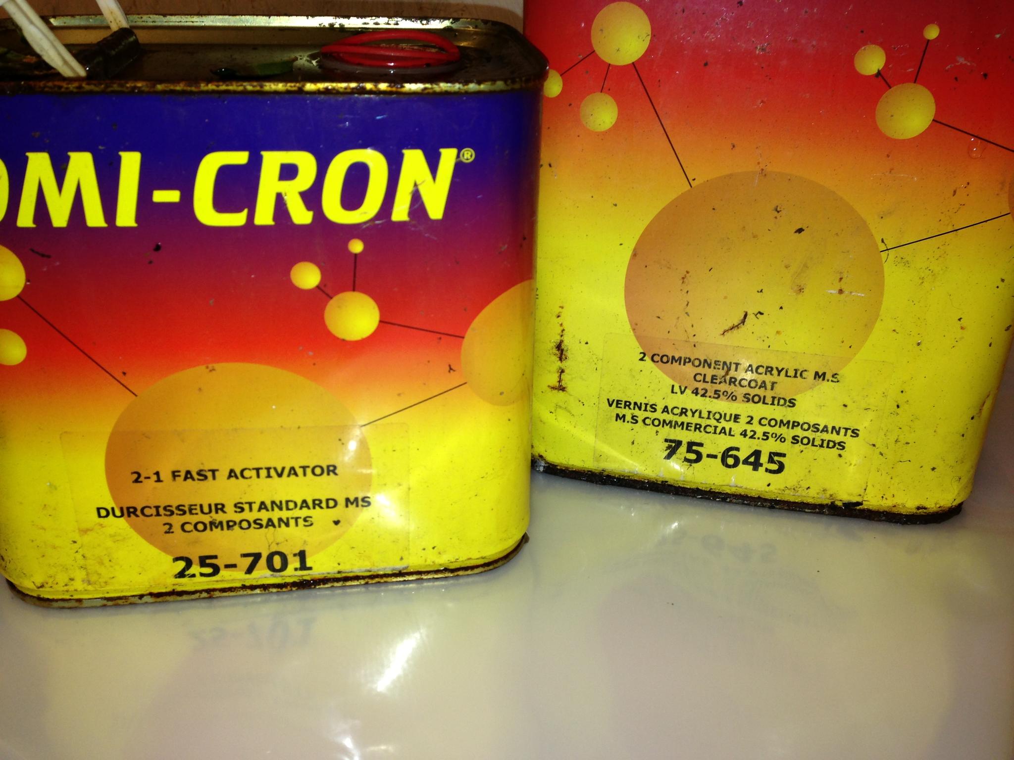

    so... it turns out it was acrylic i used previously and all i used to protect myself back then was a 3M mask as per the other thread.... is it really that bad that you should suit up and keep the clothes you used out of the way of the house??

    it has all the warnings on the back about full body protection and wearing a certain niosh approved breathing mask.
    if we put aside the safety issues... as far as spraying something as simple as a desk, now that i have this lacquer i'm pretty sure that aslong as there is something the resembles black beneath the lacquer i'll be able to get the finish i want for my desk.
    questions though if i use this lacquer.. what paint can i use before it? could i for instance use of the shelf spray cans of primer and black and then blast over with this stuff straight away or will they react? also do i need thinners with the above paint? i've got a feeling its 1 part lacquer to 0.5 activator and 10% thinners.. can anyone confirm?

    2K isn't good for you.
    The acrylic mentioned in this thread, can be applied straight out the tin without any activator/hardener, and is what most aerosols are now as it's low volatile (basically has minimal ingredients that cause health/enviromental issues). It's actually a bit of a generic term, as it can be mixed with other bases to create things like 2K.
    I know there's a deadline coming up (or it's maybe passed) for bodyshops to stop using High Volatile (Organic Compound) paints, and switch to water based, however I'm not sure if that's still a 2pack system or not. There is a lot of upset over it, as waterbased paints aren't as easy to work with. I should really pay a bit more attention to the bodyshop sections of all the trade mags I read!

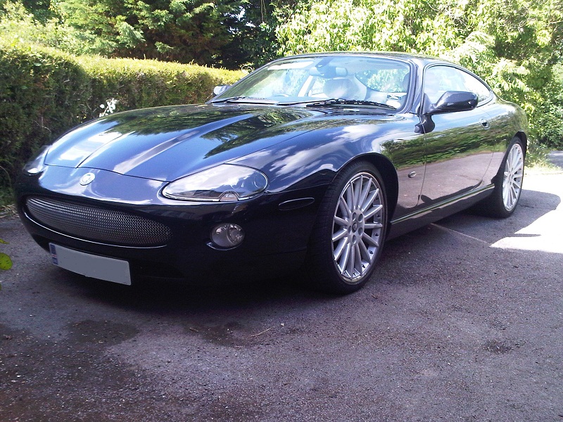

    Chris,I love the car, it looks fantastic. I have a 2000 XKR which also looks good, but not as shiny as yours. does your Jag live in a garage all the time, or does it sometimes get wet? G.
