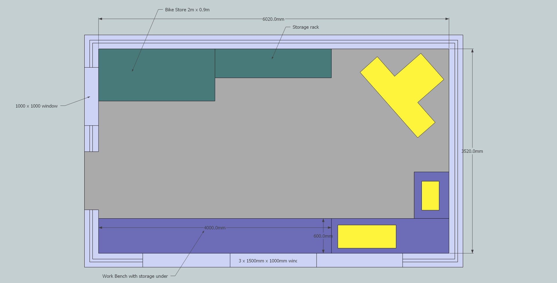

  5. Done some rethinking and some replanning and put some tent pegs and string in the garden where this is likely to go (not so much a garden as a unkempt undergrowth behind the trees). Reckon I can get 6.5 x 4m external which is 6 x 3.5 internal and I can keep it to 2.5m high by putting the door in the end and better utilising the space. So here is plan B in Sketchup this time...
    Give me a continuous run of 6m of workbench with the lathe and grinder at the end, lots more windows and therefore light and room to put the bike trainer up when I can't get out and ride... and i could make it 0.5m narrower if need be (but I dont want to). Will make it a single pitch, 2.5m at the front sloping to 2.25m at the back (top of pic)

  6. #16
    Make it taller than the inside on the outside?
    Ye good idea then when it piss's down you have an indoor swimming pool as well. . . . Lol

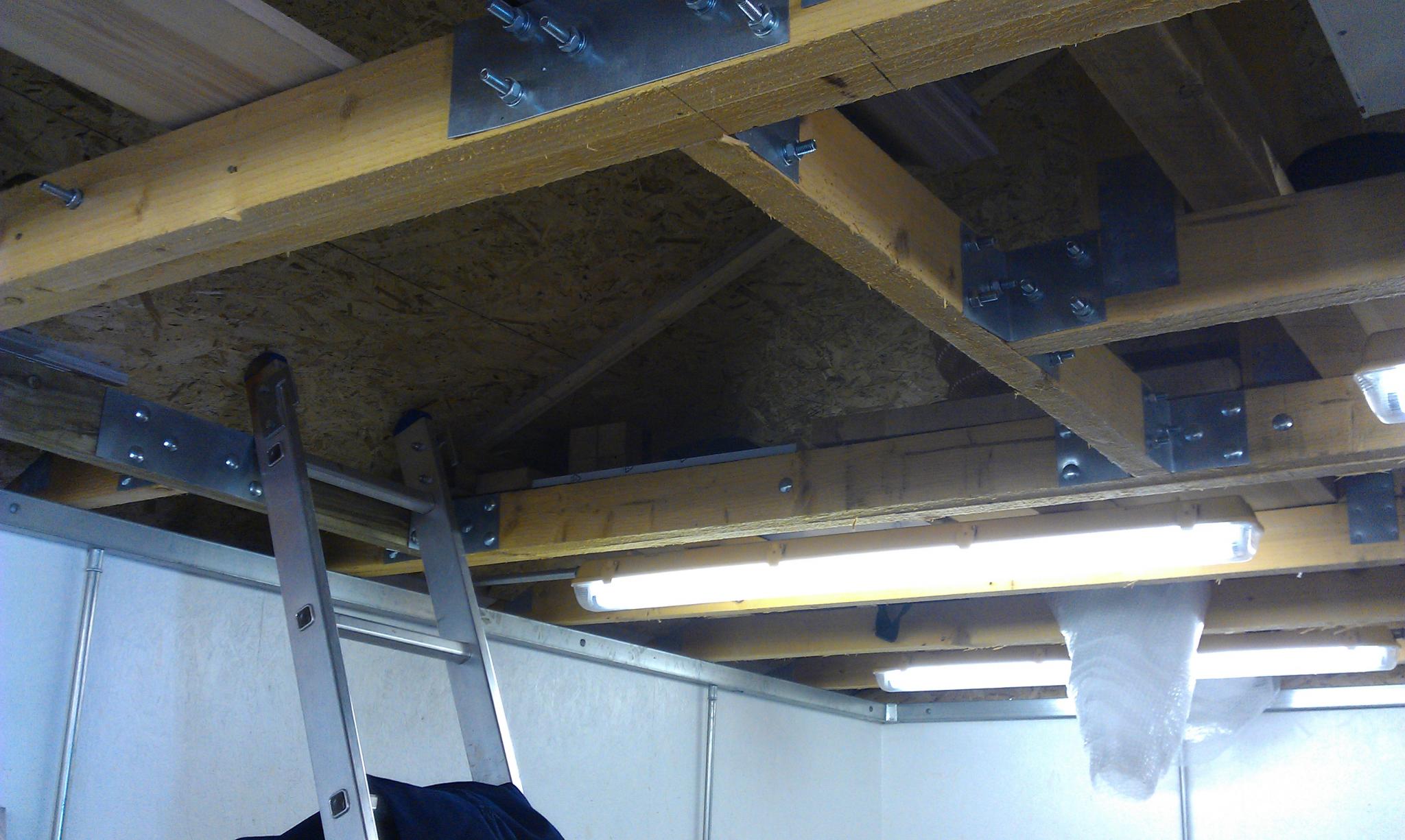

    I wouldnt recommend a single pitch roof. I had this on my last workshop and I am glad I didnt do the same on the new one. Having the extra storage space is a major bonus on its own. But if you do go down that route go for some decent roof covering like plastic coated metal sheeting. Got that on mine and its great.
    Photo of the enlarged access I left myself to get stuff into the roof storage area.

  8. Quote Originally Posted by Web Goblin View Post

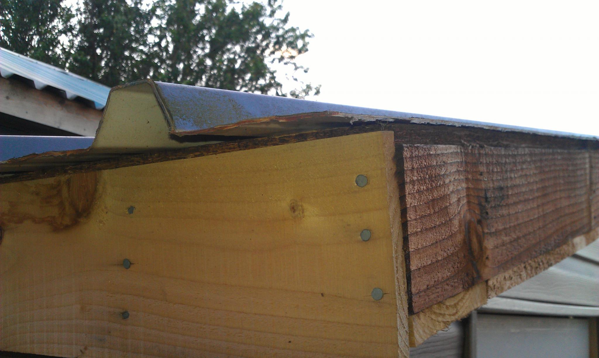

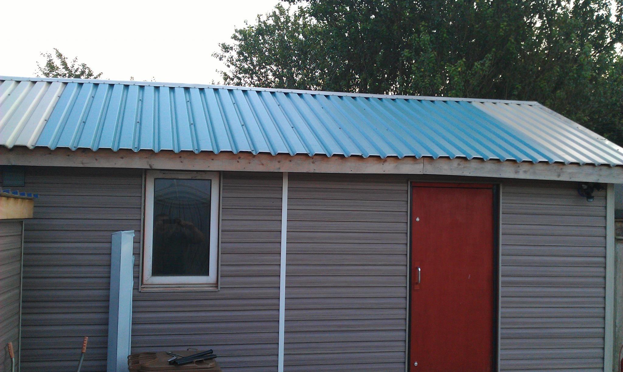

  9. #19
    If you are going to build to 2.5mts at one side anyway would you not be as well having a pitch roof? It might not be as much of a slope as you wanted but it would Still be there. The metal roof is not really that noisy and the roof sheets are screwed down on top of the outside sheet of timber anyway.
    Photo below (left)shows my workshop roof. The photo on the right shows my nearly complete bike shed with the same type of roof. The roof has the outer sheet of osb, 100mm of poly insulation, then another sheet of osb inside so its well insulated for heat and sound.

  10. #20
    Forgot to add that the air gap between the roof timber sheet and the metal sheet gives it a good way to breath to keep the damp away.
