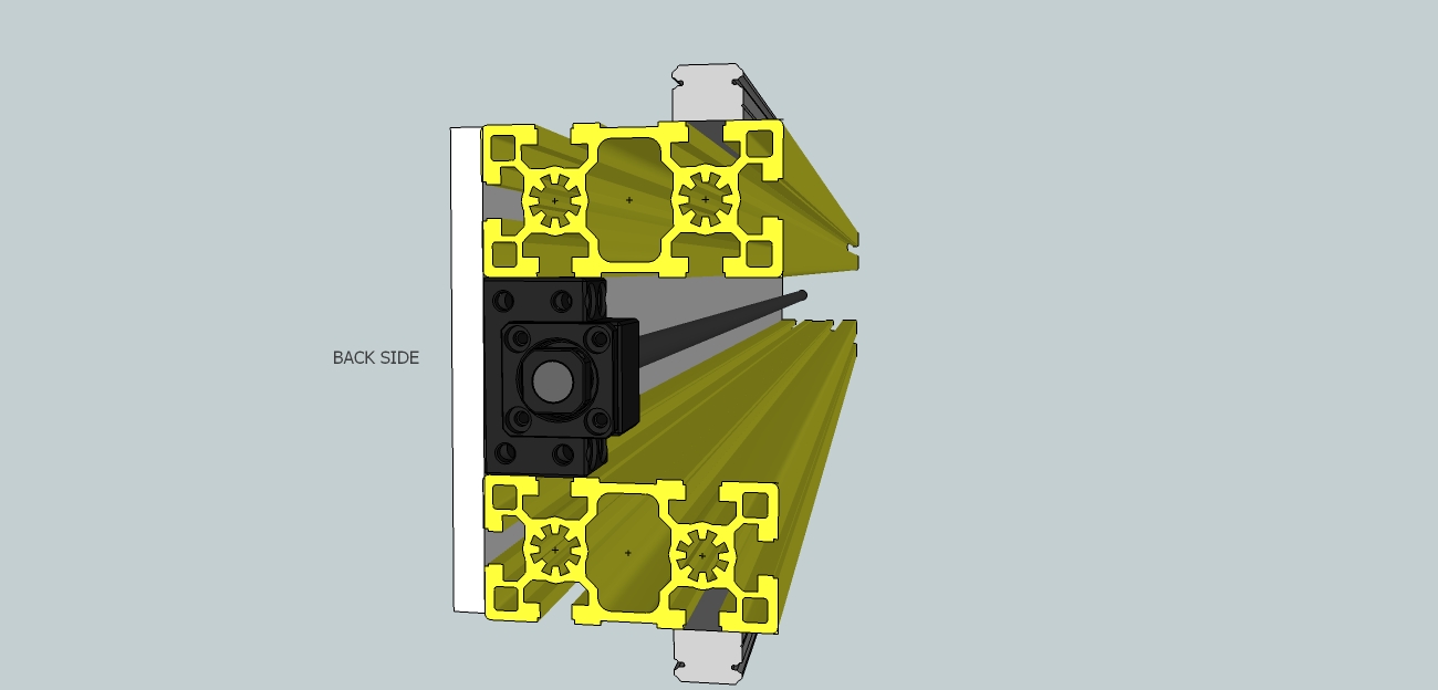

    How about using components from my yellow and your green, tada. I added a 60x45mm extrusion in between the top and bottom extrusions. These can all be bolted through from the top and also screwed into the 10mm back plate. Now your worry about the weaker wider section is dealt with, plus that extra piece for 800mm length is only £12, sweet.

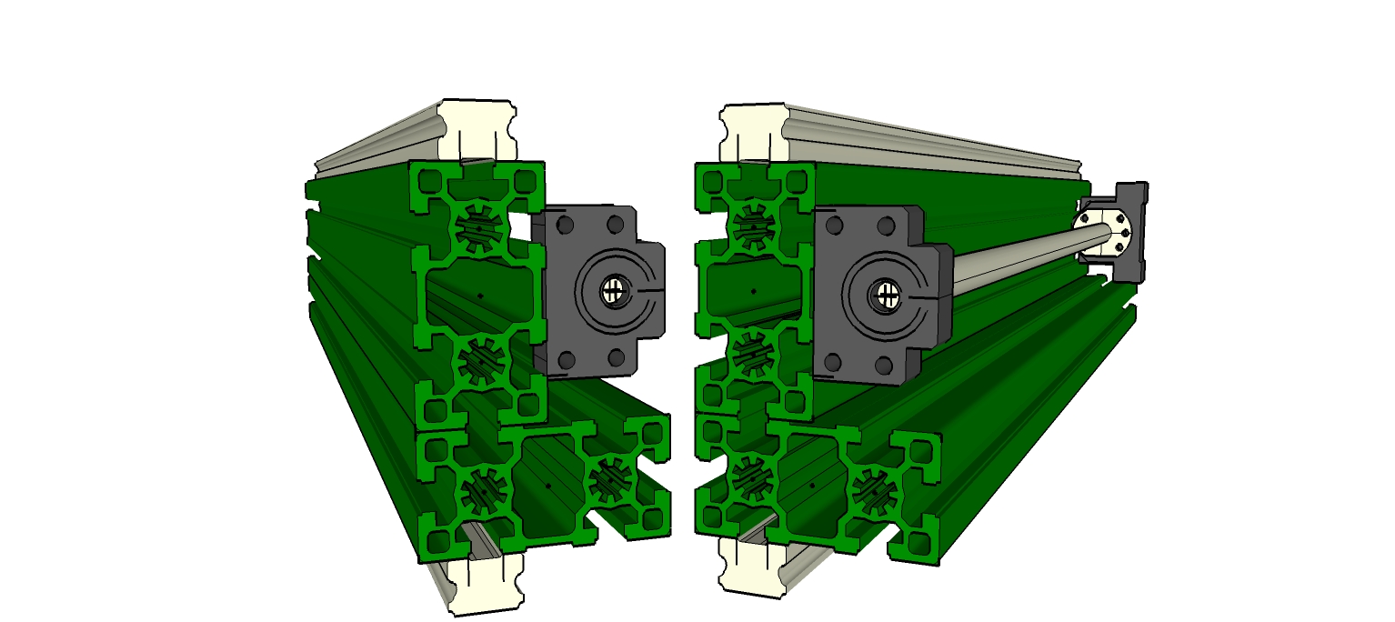

    Thanks Adil, that looks incredibly strong in all directions... my gutfeel is it's even stronger than GREEN!
    Jazz's GREEN looks by far the simplest to build and has better accessability for changing belts and pulleys... certainly if this is to be done within the gantry ends... as my current limited space dictates a compact design. And it moves the ballscrew away from the mess of the cutting chips, but also away from the profile-rails.
    Your YELLOW looks the strongest, and brings the ballscrew between the profile-rails, but also closer to the mess of the cutting chips.

    Not trying to sell it to you but I know it works with no detrimental side affects and plenty of positives.!!
    Well, you have sold GREEN to me Jazz... even without trying! I have updated my design and am moving on, although I'm still curious about how the thicker-walled box sections compare, and the effect this may have on the machine.

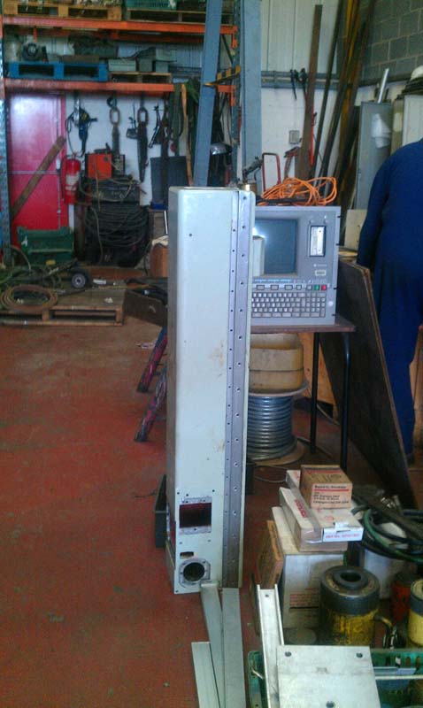

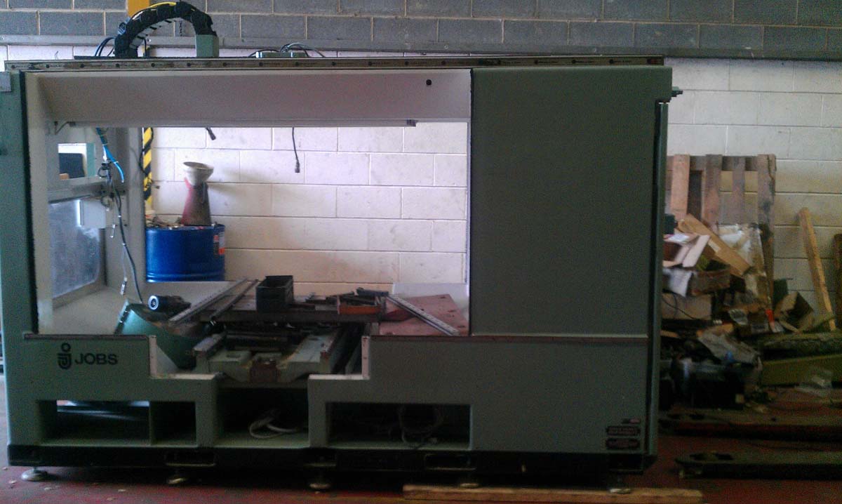

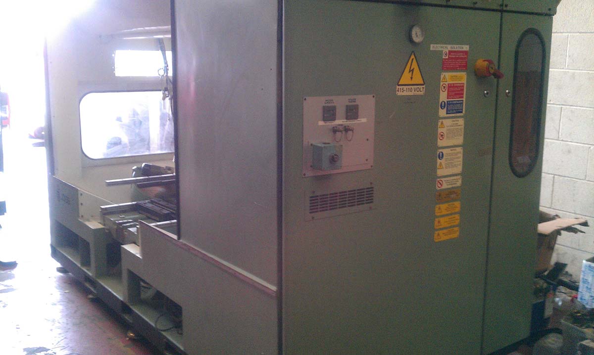

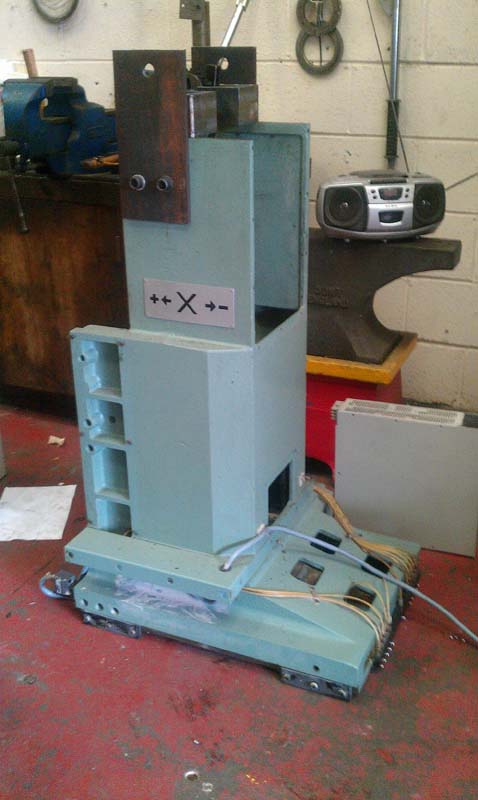

    If NO DOSH limit then I'm 99.9% confident he wouldn't and it would be a hefty lump of ground cast Iron or some fancy composite affair.!!
    Can't hide from the fact box section sings like a canary and resonance and vibration are to be avoided so density wins every time, that's why cast iron's used so much.
    This is the kind of thing you'd buy(New) if Dosh no limit.!!! . . . .
    Here's the Y Axis carriage(pic1) which carries the Z axis(pic2) of my future 5 axis toy(Doubt I'll touch it this year thou.!).!! . . . It's one big cast iron lump with a counter balanced Z axis which is very long lump of cast and ground aluminium that runs along the roof of the main machine frame which is one big structure of steel and ground cast Iron.. . . Very very very strong and heavy 3.8ton the frame weighs.!!

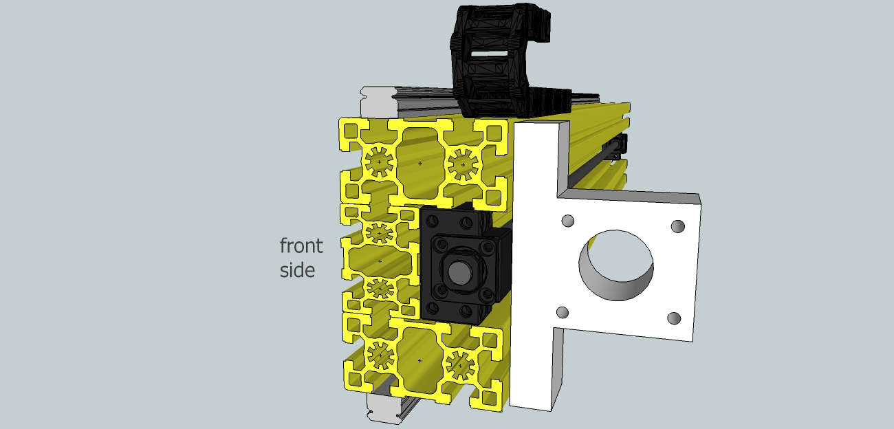

    If Jonathan doesn't mind I will send him a section of my yellow design.
    I'll send two, my first yellow one which I designed how Jazz advised in your build where I have the z axis to the right.
Name:	jazz design.jpg
    And a newer one I've just made which is very similar to your green 'L' but a 'C' shape. This allows us to fix the Y axis motor mount easily and also have a surface to run energy chain. Have a look remember the z axis is now towards the left, and the ali plate is removed. I wonder if having this plate will increase its strength?
Name:	extrusion cross section.jpg
