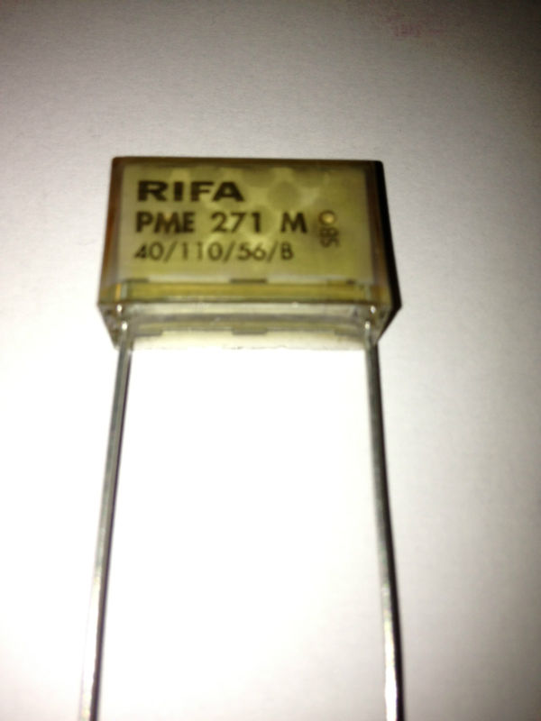

    And this critter Click image for larger version.
ID:	6599 decided to show the world its insides, anouncing the event with a bang, as it let out its magic smoke..
    It was sitting across the pins onf what i believe to be a transformer, or a choke as Irving has suggested, i will see if i can get a picture as you have suggested of the board posted.
    Rick
    That little critter is available from RS if you want a direct replacement:
    http://uk.rs-online.com/web/c/passive-components/capacitors/paper-capacitors/
    Although judging by the photo it looks like you might already have got one...

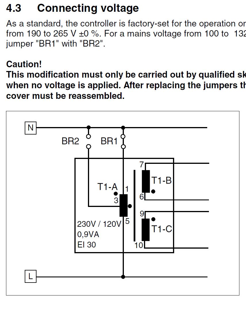

    Other useful info I just found... the Lenze 530 series manual has this interesting pic:
    So we know it is an EI30 series and its 0.9VA...
    tho current EI30 are 0.6VA and 1VA, so I guess this might be a special. edit: or then again, maybe not; EI30-10.5 is 1VA or 0.9W for the 2x15 V: VB 1,0/2/15 from Farnell (alternate to Myrra)
    Elsewhere in the manual it lists switching voltages for relay contacts as 20v so I'm going to hazard a guess this is a 15v secondary...
