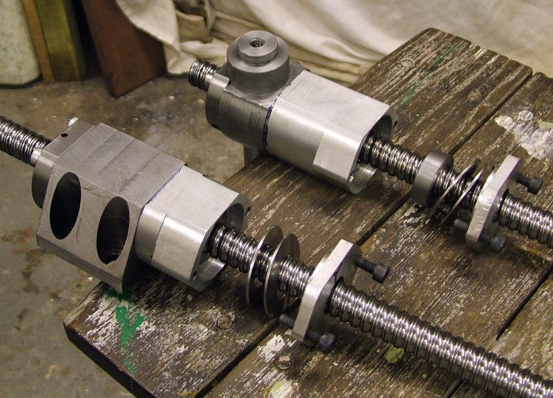

    Hi i've been reading up a lot , and i've seen people say you need to pree-load the ballscrew and nut,, now me just been new to cnc and i'm planing to convert my viceroy tds11gb lathe to cnc, i do not no how to do this?
    someone on an other forum said to get the c5 gear as its 0 back lash but on here and other places people say you have to pree-load the c7 to get 0 back lash?
    could anyone tell me how to do this and if you have any photos could you put them up?

    Notice I never mention zero backlash because true zero C5 & C7 rolled screws don't really exist off the shelf.? People make them or force them to be near has damn zero by trickery using using 2 ballnuts back to back with Belleville spring washers forcing them to preload against the screw.! . . This works but can if over done wear the screw and nut's prematurely.!

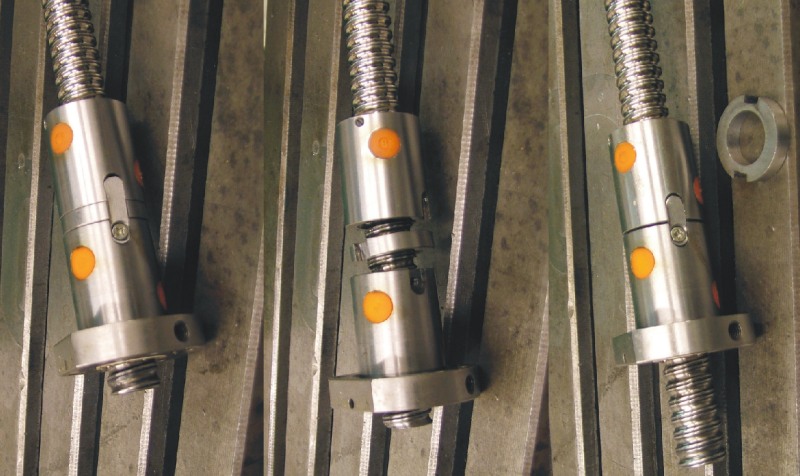

    Double nut preloaded ballscrews can be bought of the shelf and use various ways like adjustable collars or shims, tough these are not always true zero backlash just very close.!
    Robin and Jonathan have played with Belleville washers and C7 double nuts so search or check there posts but I think you'll find the Belleville washer the easiest method.?

    Instead of that, as you've read, you can get two cheap ballnuts and preload them against each other to eliminate the backlash. Bearing in mind the RM1605 (or whatever size you choose) ballscrew from China is much cheaper and the ballnuts are about $20 each this works out a lot cheaper even with the added cost of springs and the mount. I just got three RM1605 ballnuts for £44.70 including postage.
    Preloading in principle works by applying a constant force between the two nuts trying to push them apart. One nut is fixed to the machine as normal, but the other is only rotationally contrained so that it is free to move axially. The easiest way to do this is using a spring, but normal coil springs are bulky so we use Belleville washers, otherwise known as disc springs. So long as this force is not exceeded the backlash is eliminated. Therefore to choose the amount of preload you need to consider the maximum force the axis will experience (the sum of peak forces due to cutting, friction and acceleration) and set the preload a little above this to make sure. Since setting too high a preload will shorten the life of the ballscrew significantly, aim not to exceed about 10-20% of the ballscrew static load rating.
    The only worthwhile pictures I have of doing this are in my micro lathe build log.

    The problem with backlash is you can get anal about it PDQ. How much is too much? Removing it 100% means springing the nuts and the axial bearings. You can get it down 20 microns with a shimmed double nut, that's better than .001", is that enough?
    Hassle is you can still put your thumb against the bed and turn the screw a smidge without feeling it move. If you want to get rid of that it will cost you time more than money.
ID:	6597   Click image for larger version.
