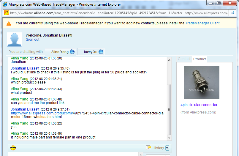

    Have you got them yet ?
    Description is vague, you could be getting just 50 plugs
    John S -
    Only ordered on the 15th, despatched on 17th so not yet.
    Just used the online chat thing to check for you:
    So it's fine - I'll let you know when they arrive if you want...
    Good discount if you buy 100, I should have done that.
    They will also give you the discount if you buy 50 of one type and 50 of another. Just asked them and ordered 50 4 pin and 50 6 pin.
